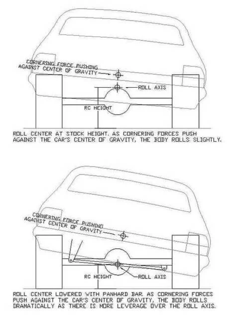

At the low levels of lift that OME gives, it doesn't really matter if you go adjustable or relocate and use stock. I was obsessing over this for a while, but a conversation with Blaine helped me through. The roll center is what changes when you lift, and keep the track bar in the same mounting locations. With a 2 inch lift, my napkin calculations says the roll center will change by less than an 1/8 of an inch...or not very much.
Roll center will help control the tendency of a vehicle to "roll" in a corner. When your roll center gets larger, you feel more body lean in a corner...because the center of gravity has a bigger moment arm (lever) on the roll axis.
LOL You drew a '69 Chevelle. Awesome! :) Great info, btw. Thank you!
To be fair, that is just a random pic from the internet that described what I was trying to type. Coincidence that it is a Chevelle
It's cool. A car guy just appreciates stuff like that. When I see what time it is on a digital clock, I immediately think of engine sizes. 3:27...Chevrolet & Rambler. 4:01...AMC & Buick. Nonsense like that. Just a car guy thing... :rolleyes:
