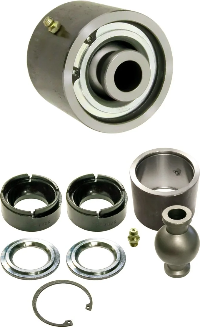

Interesting that companies always try some "super joint" when the stock track bar rubber bushings last 100k miles or more. I get that they are trying to add movement but seemingly at the expense of reliability. You really don't want the trackbar to break driving down the hwy. That would make for a wild ride:eek:
Do you believe a push-in rubber bushing like the OE track bar uses is going to hold up longer and be safer than a steel ball & cup joint with polyurethane races held in by a heavy-duty steel snap-ring as used by the Johnny Joint shown below?
Reactions: Dave52
Aha! Now I see what Rough Country was trying to emulate with their X-flex joint...thanks for the close-up view!
I have to give RC a little credit, however. They've redesigned the joint to eliminate the threaded washer idea. It's now similar to the above photo, but nowhere near the quality of the components.
The stock rubber bushings can go 100K or more so I would ask; how long can the JJ last? I honestly have no idea.
