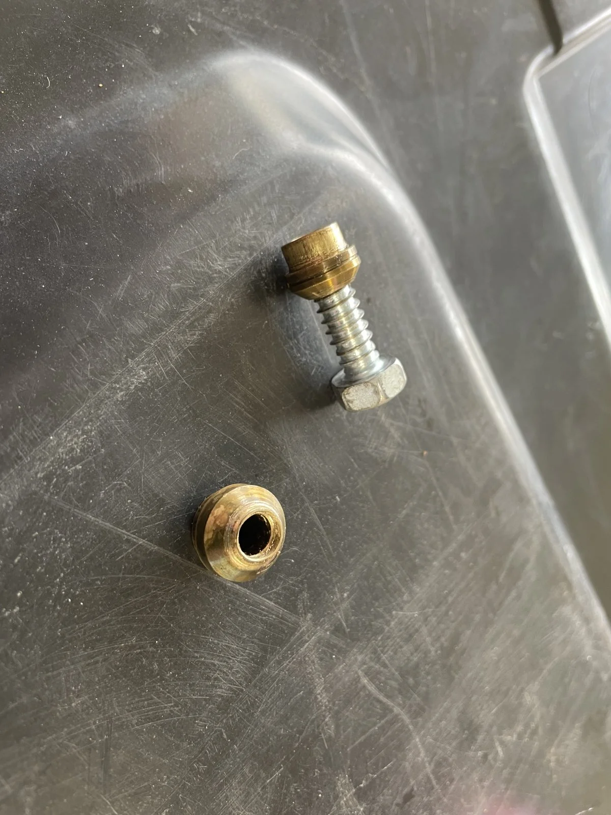

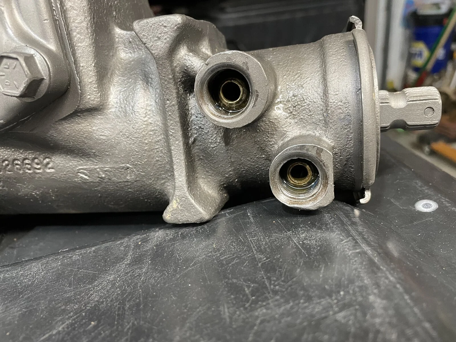

I was going to replace my steering gearbox for excessive play and a very large dead center and ran into an issue with the hose connections.
The OEM box has double flare fittings with an o-ring, the remanufactured Byautoparts box has single flare fittings with a brass insert.
I crossed referenced the part numbers and Byautoparts states it should be a direct replacement.
I'll call these knuckleheads Monday, but in the meantime wondering if you all can help.
Do I have the wrong hoses, the wrong steering gearbox, or both?
Well, it turned out that the high-pressure line going into the new gearbox was miss-threaded and almost ruined my replacement hose.

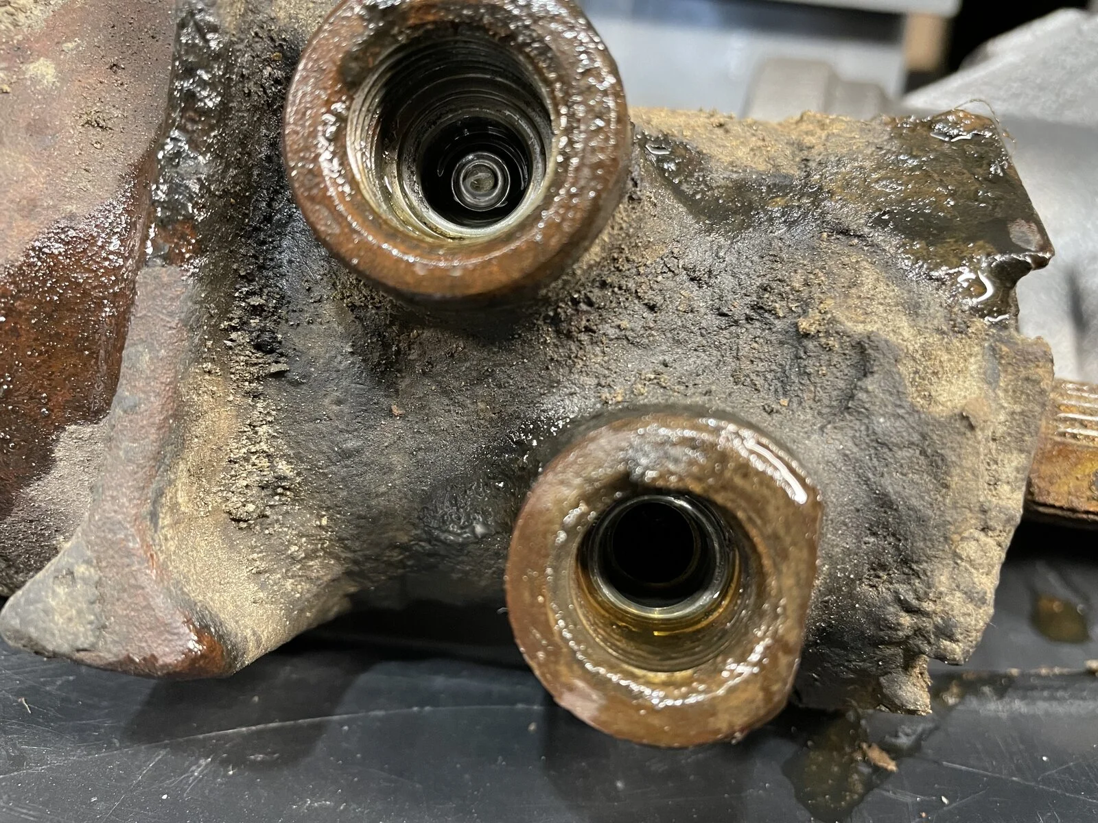

So I now have the original gearbox on, but now it leaks.
On the bright side, my steering slop is gone after adjusting the gear drive preload, but now the power steering pump does not always boost at idle.

For whatever reason, maybe the air is all out now, but the steering box is not leaking and the pump is boosting at idle. 🤷‍♂️
Well that's good.
Replacement steering boxes in general are known to be hit and miss, so the fact that you had issues isn't terribly surprising. Hope the fix lasts for you.
