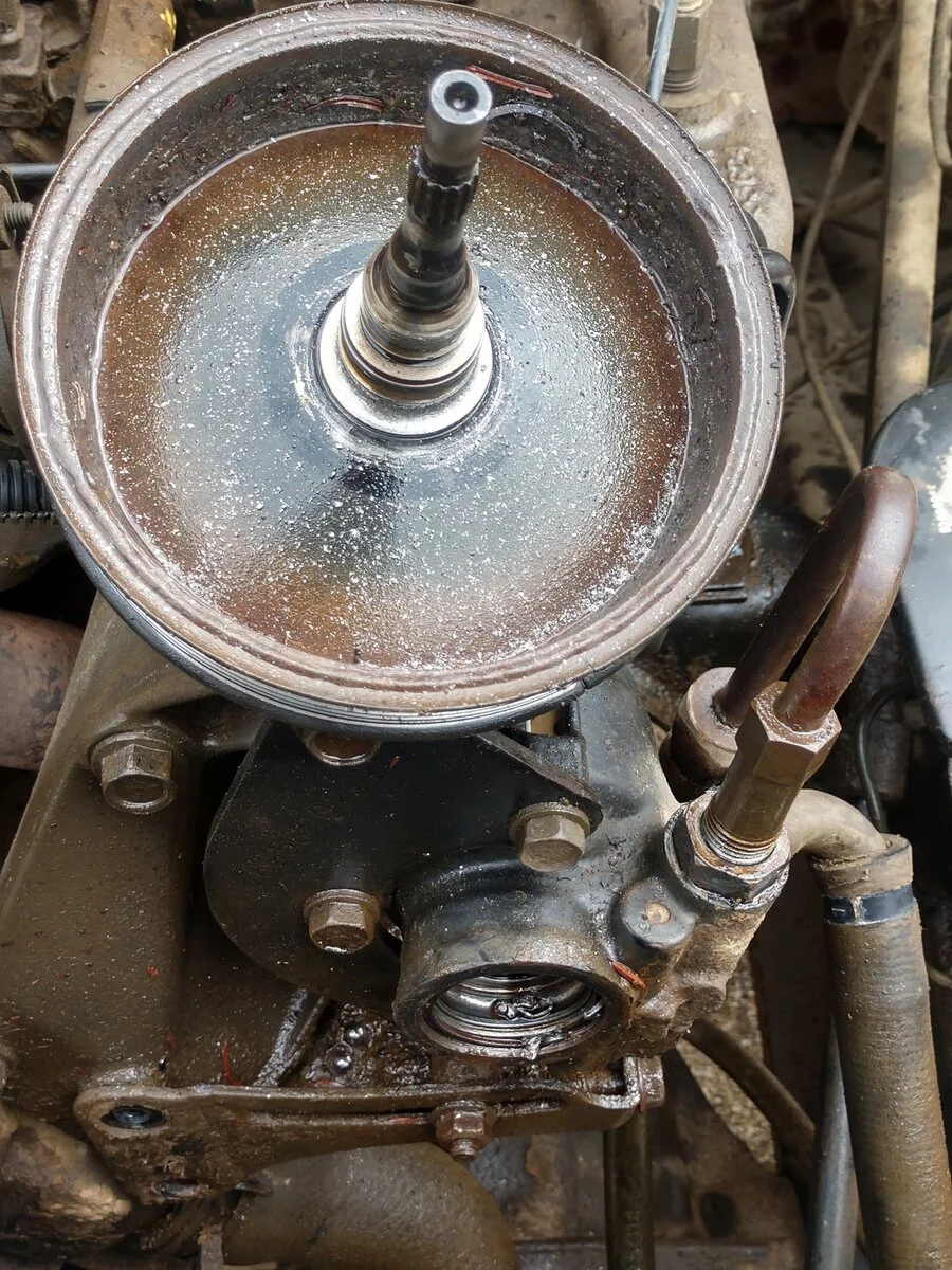

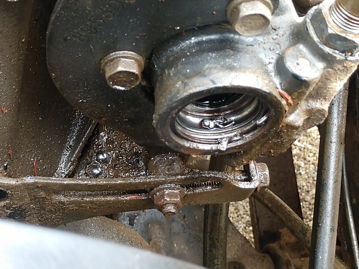

My son's YJ was notchy and noisy when turning the wheel but it was fine when going straight. I'm not sure how long that was happening but eventually, while off roading, he ended up with a pretty severe leak. Being a good mile of so away from any roads we figured driving with no power steering will have to be good enough. That lasted about 300 yards or so. No power steering turned into nothing being powered by the belt.
Here's the power steering pump at that point:
