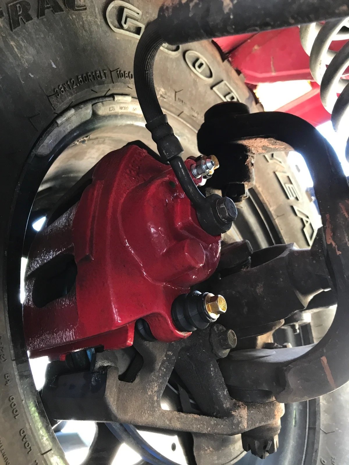

Power Stop Brake Kit?
From the little I've read so far, they seem to be a decent option.
I'd be curious to compare them to the performance of the Black Magic Brakes.
You really can't beat the price though. Did the calipers come painted red?
Reactions: fourpointzero
Sure did

Im running them on the front of my rubicon. Pretty nice kit. They are stock, rebuilt calipers that are painted, new rotors and new pads. They are quiet, and I can get the tires to chirp under heavy braking. Wont fully lock up, but that isnt the fastest way to stop anyway.
