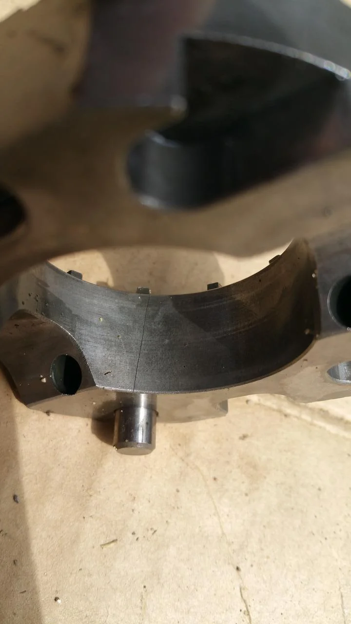

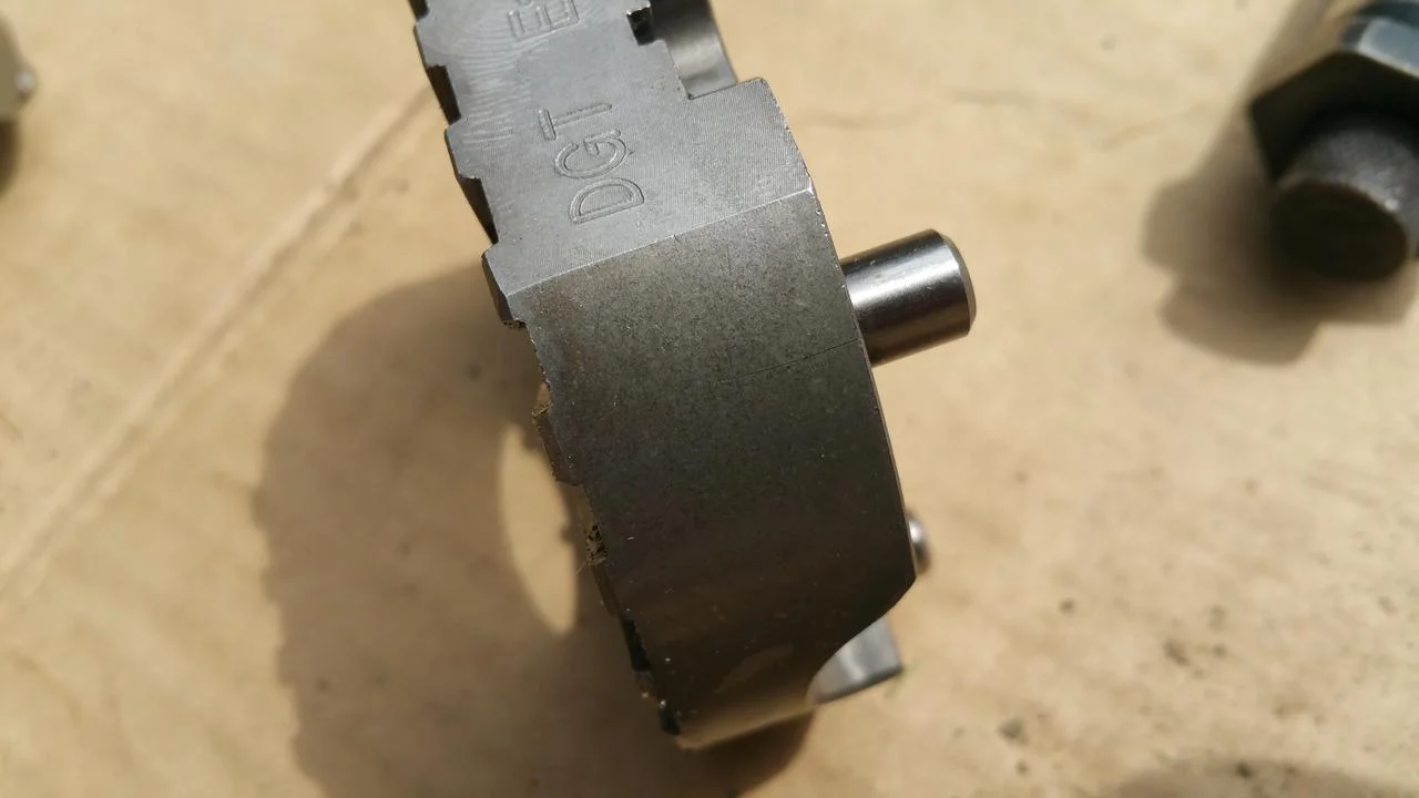

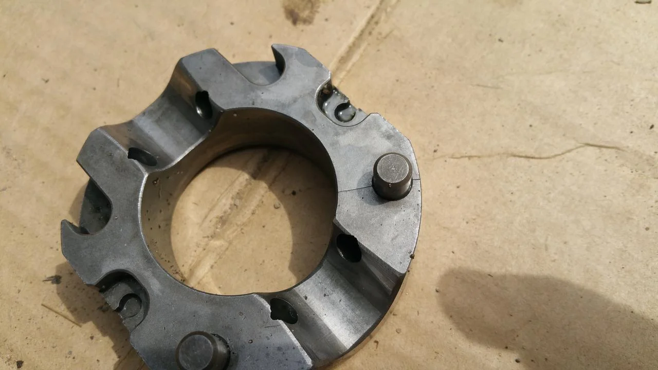

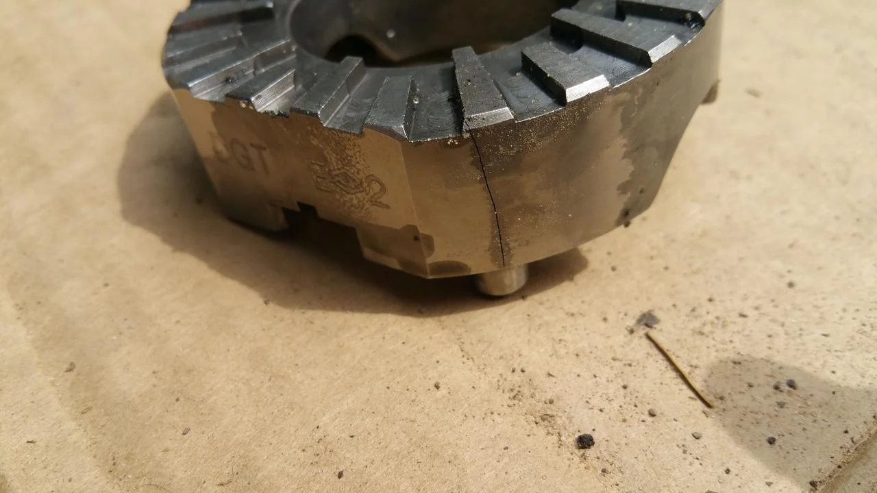

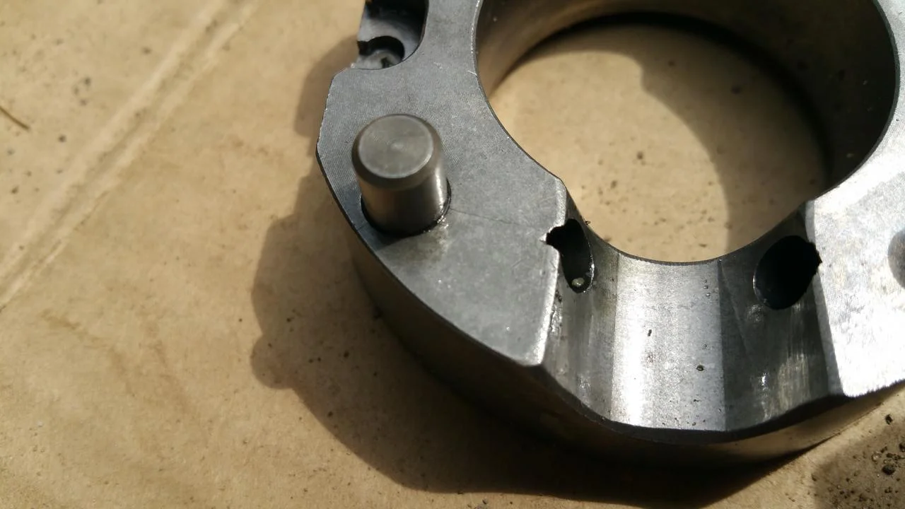

Just finished pulling it out. It's cracked around the pins on both plates. one of them is cracked all the way though. the other is just starting.
I wonder if the hole was a touch too small when they pressed them in. I've seen similar failures with sintered metal gears in my other hobbies.
one plate
The other plate
Damn that is strange. Has me wondering if they both came from the same batch.
Maybe they had an issue with the steel.
Seems like a manufacturing defect to me unless you are the one installing those pins with a swing press.
