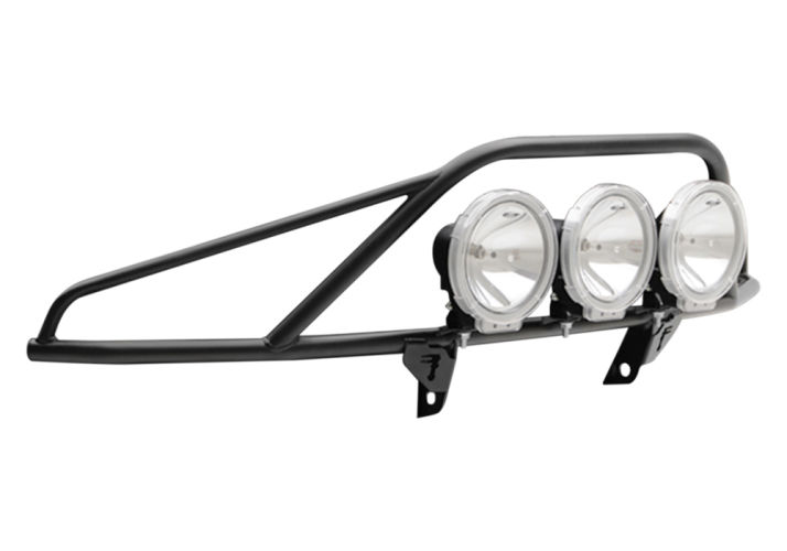

Huh. When I think of prerunner lights I think of something usefull like this:
You know, lights that help you actually see the trail at night. Not those little amber fairy lights.

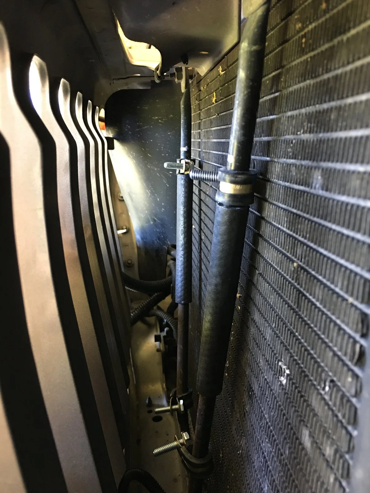

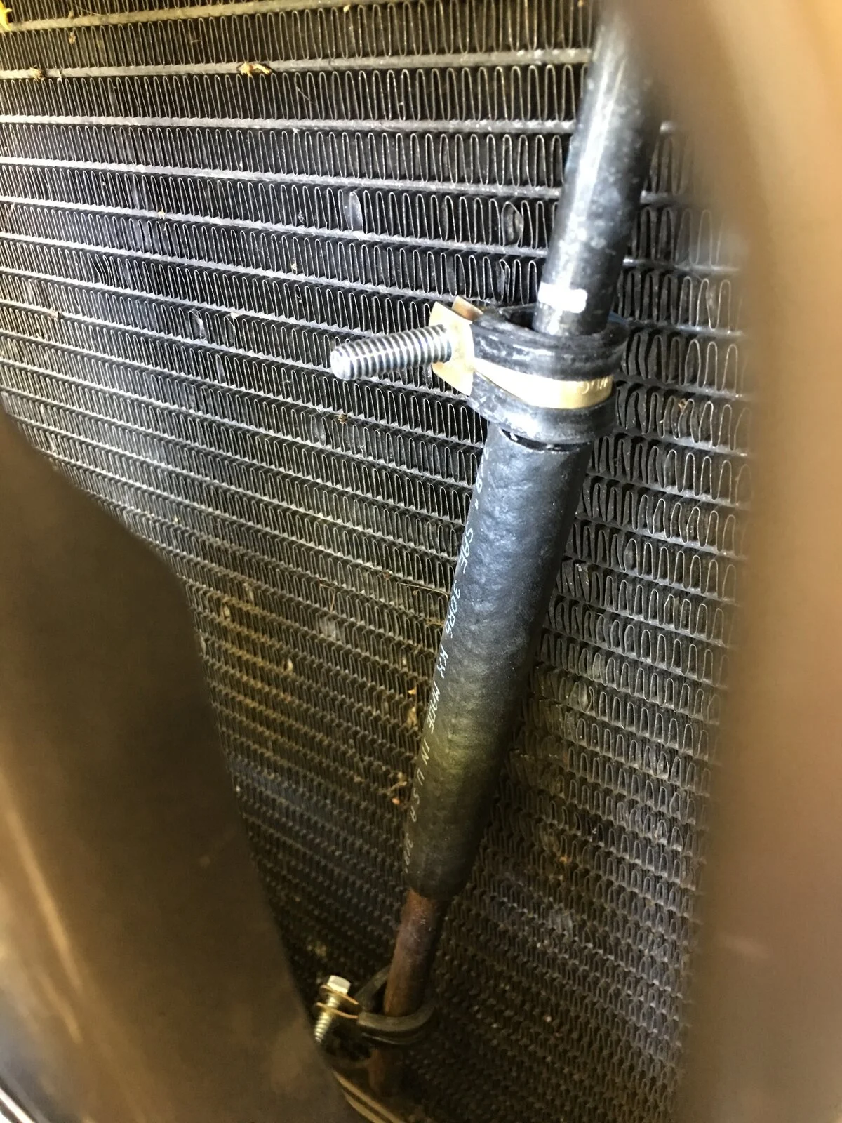

You could use a couple cable clamps around the V support and attach a thin strip of sheet metal to it, then mount your light to the sheet metal.
I used cable clamps to mount my transmission cooler to the V support.

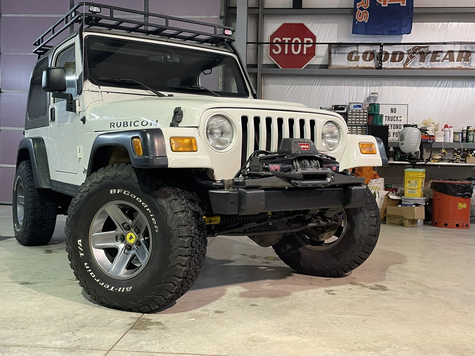

You mean like the set of 3 KC daylighters in my profile pic?

What you run into is the stock bumper is very close to the frame cross tube behind it and you don’t have the space unless you get a super thin LED- I was going for this look on my stubby and decided I did not want to bring the bumper forward plus the lights are protected.
Also in a jeep you don’t have much chance of over taking anything- Except a rock and it is sitting still.
I just concluded there are so many good LED options that I could get some additional light easier so many other ways and ended up putting some on the roof rack.
