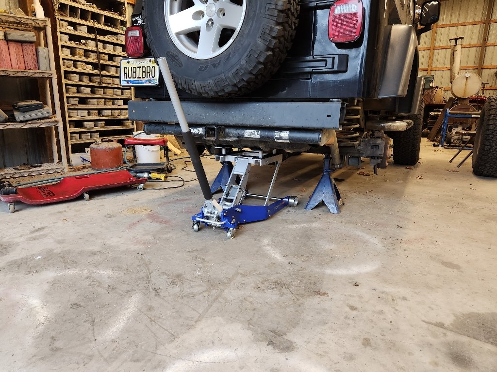

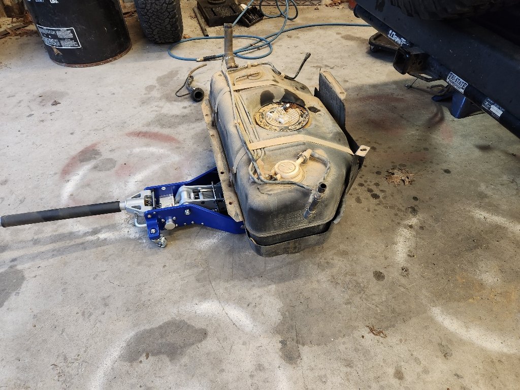

I you happen to know anyone with a motorcycle rolling jack they are the Cats meow dropping the fuel tank on a TJ.
I got the Aluminum one from Harbor Freight and it has come in handy several times.

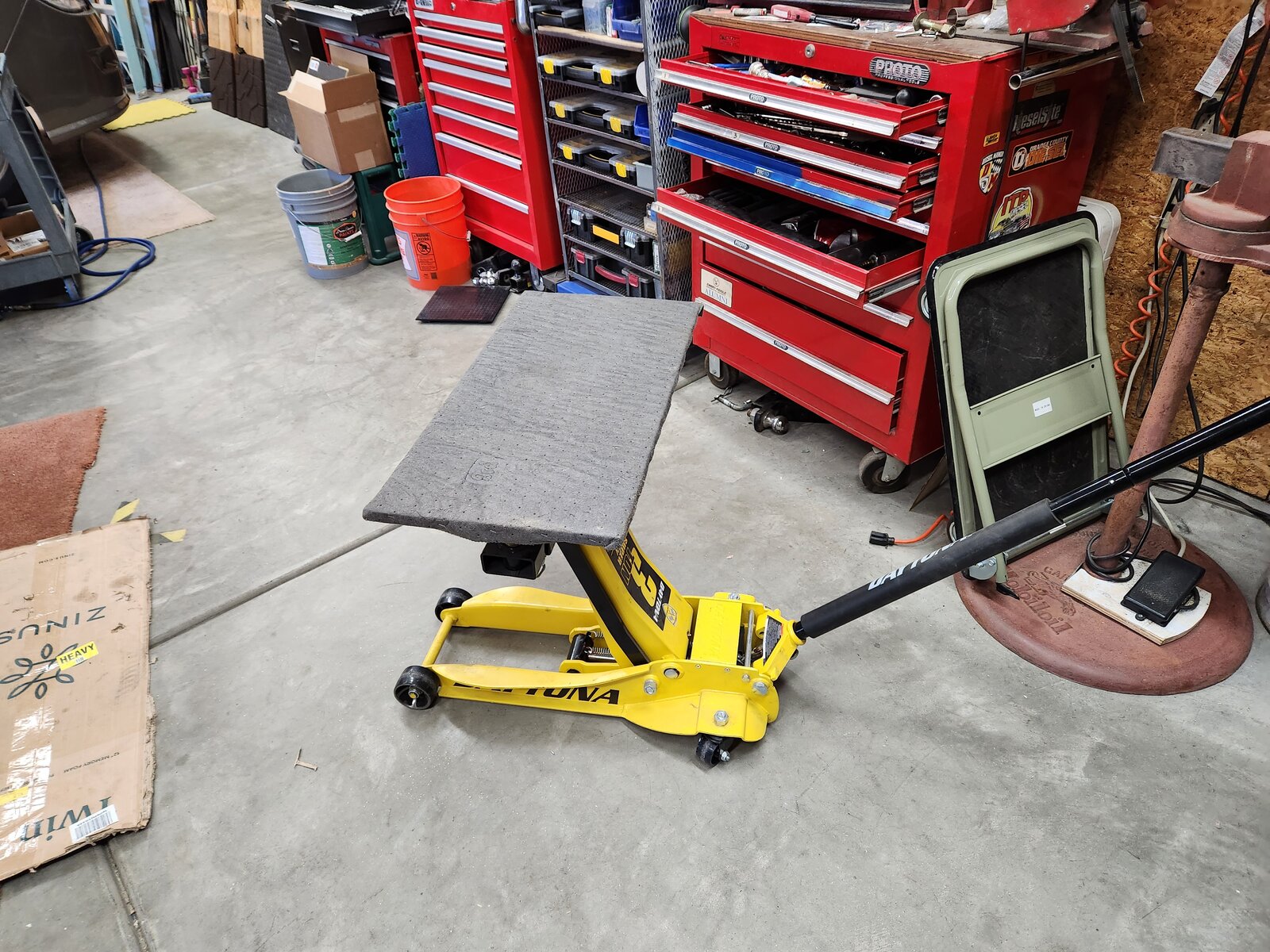

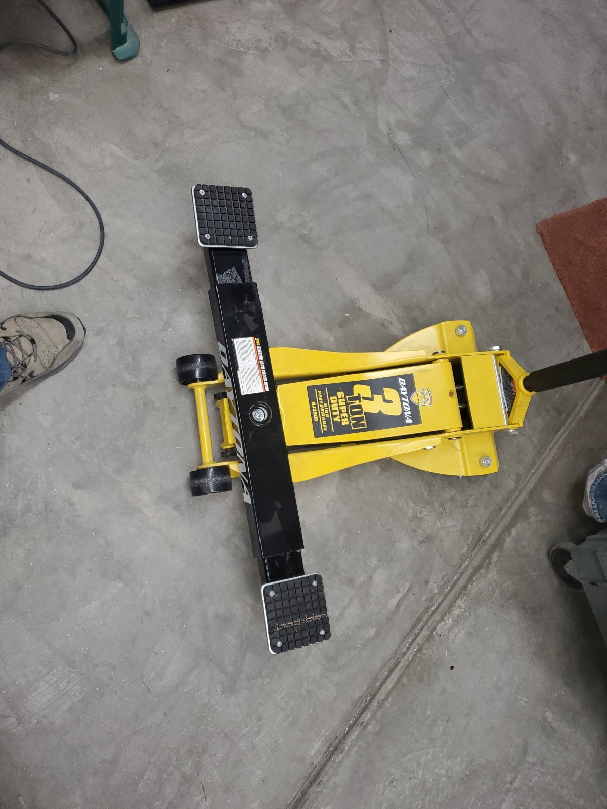

I got the Daytona jack and Daytona cross beam attachment. Remove the pads and screw on some plywood with pig mat for tank lifting.
