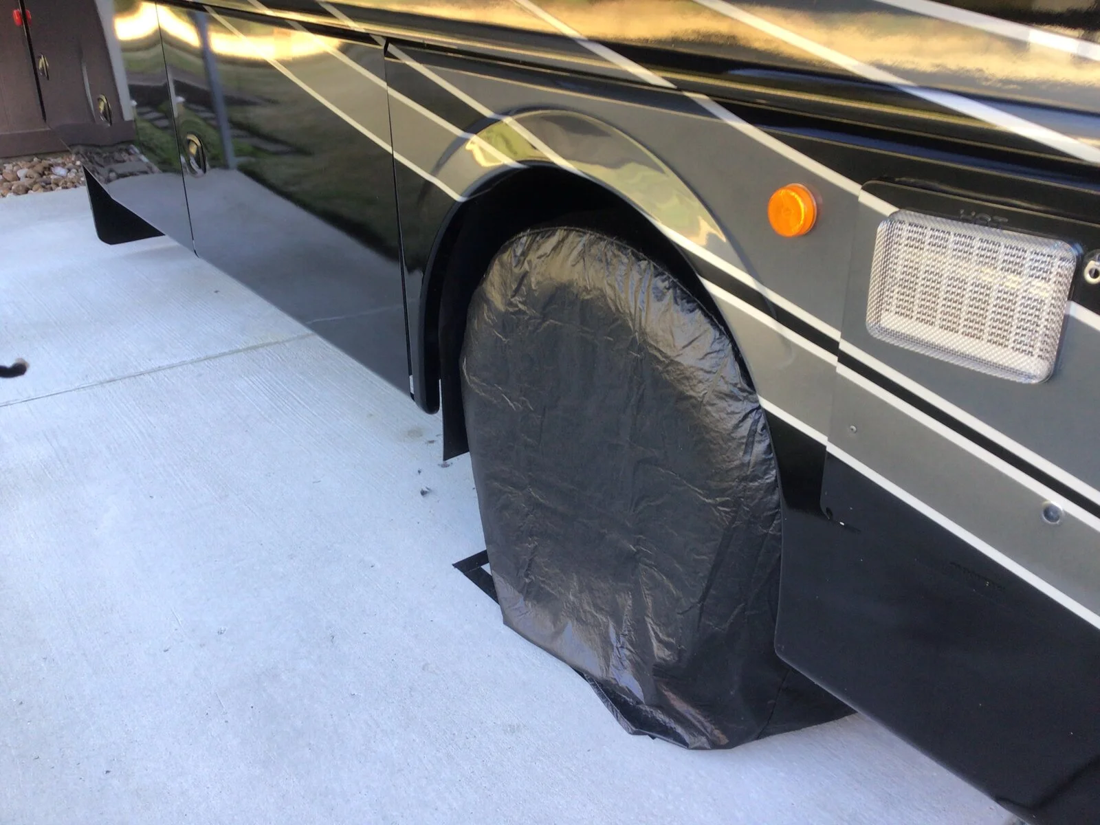

The RV industry has been addressing dry rot & damage caused by ultraviolet sunlight for many years because travel trailers & motorhomes typically do not amass enough miles for the tire treads to wear out before age becomes a factor (your 10 year old tires are way past overdue to be replaced). A tire does not have to show visible cracking & dry rot to be unsafe. It can look fine & still have plenty of tread & be very subject to blowouts, tread separation, belt shifts & other tire failures that could have potentially fatal consequences especially in short wheelbase lifted vehicles like most of us drive.
If you’re not sure of the age of your tires then check the DOT date codes that are molded into the sidewalls. If you don’t know how to do this, someone here would be glad to show you or you could just google it up.
My personal tolerance for risk is six years. I’m sure that there will be differing opinions on this, but most will agree that age matters when it comes to tires. When shopping for new tires, I’m not looking for something with an 80,000 mile guarantee because I will, most likely, never wear out the tread before the tires reach their age limit. The exception to this rule would be the dedicated, non-street legal off road rig that is trailered to the trailheads & is never driven at highway speeds.
As far as protecting your tires, if your rig can be kept in a garage, that’s great. If not the tires should be protected from ultra-violet sunlight by using some kind of tire cover such as “Tyregards” which are popular with RVers, but would work great on our Jeeps. I’m sure that there are several tire dressings that provide protection from sunlight, but Armor All & STP Son-of-aGun ARE NOT effective & can actually harm the rubber. I like Formula 303 Aerospace Protectant & have used it for decades with great results.
‘Sorry for the long reply. I just thought that this is safety related & therefore vitally important.

I’ve previously mentioned “Tyregards” that are used by RVers to protect their tires from ultraviolet sunlight. These are actually much cheaper than some thing like plywood & they stay in place very well. Also easy to fold up & store. They can some times be found in Wal Mart, but they are available on Amazon & Camping World. You need your tire diameter when ordering.
