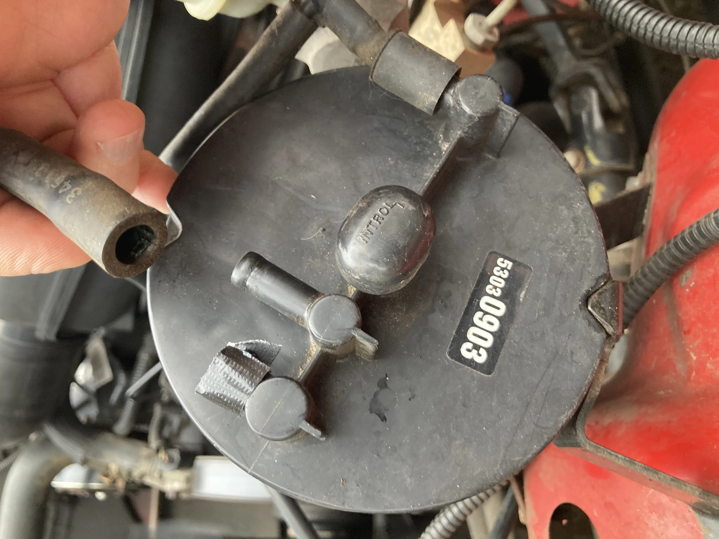

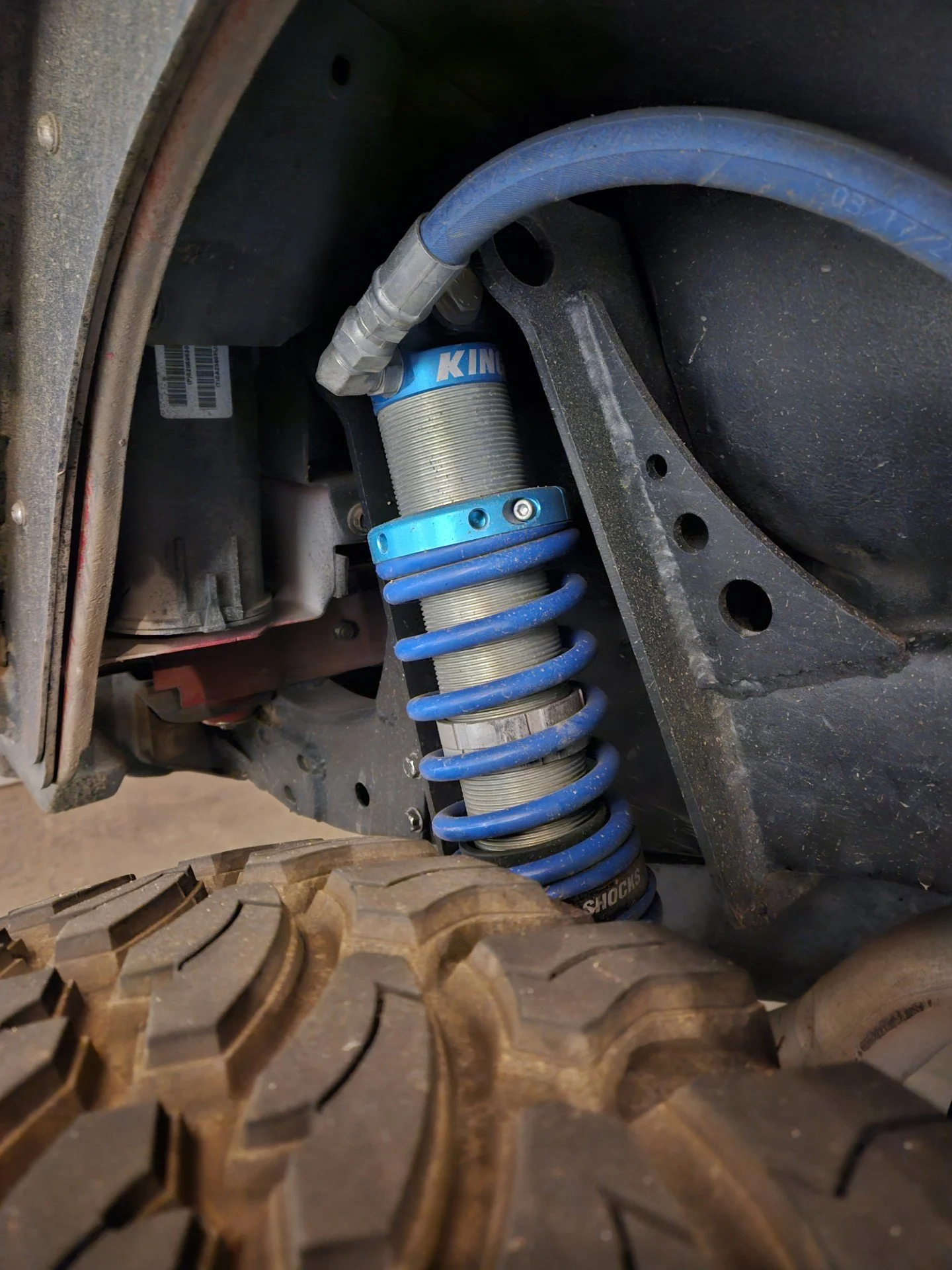

I'm pretty sure my Jeep HATES ME! I have suspected the charcoal canister for a while now, when I replaced the fuel pump I thought to replace the canister, but with the rear coils and mounting I can't get to it anymore without lifting off the whole body! any suggestions?
