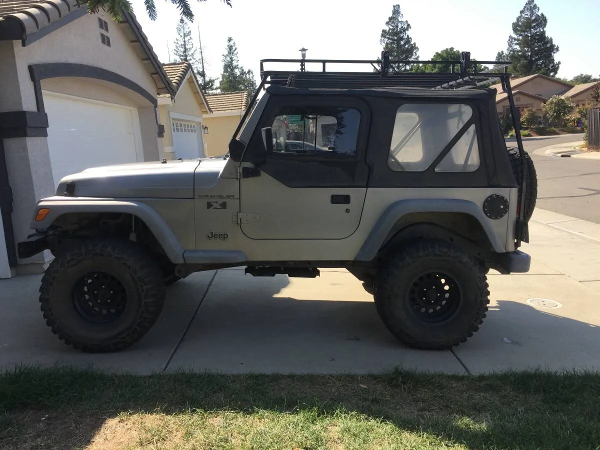

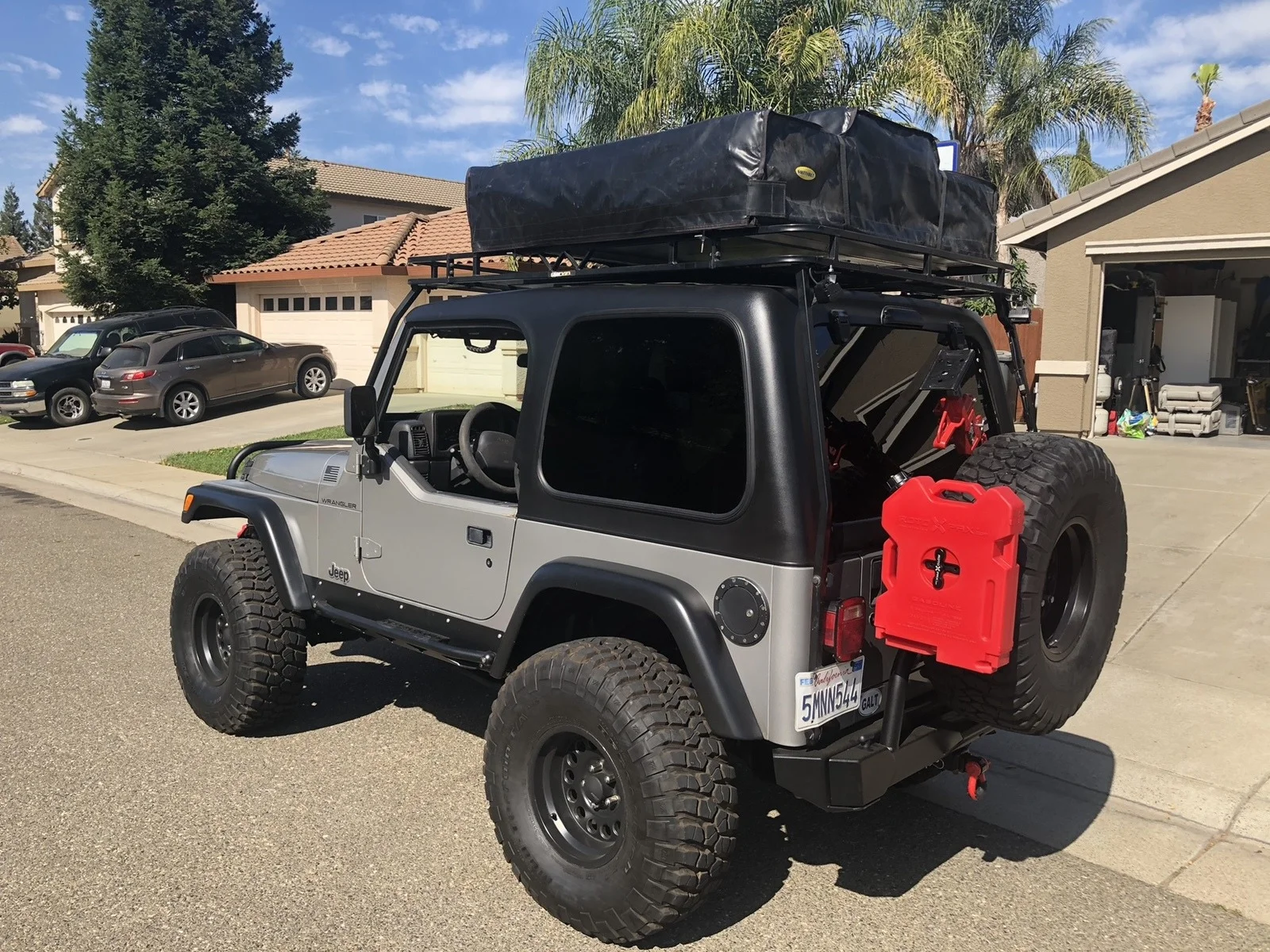

First pic is of it the day I bought it

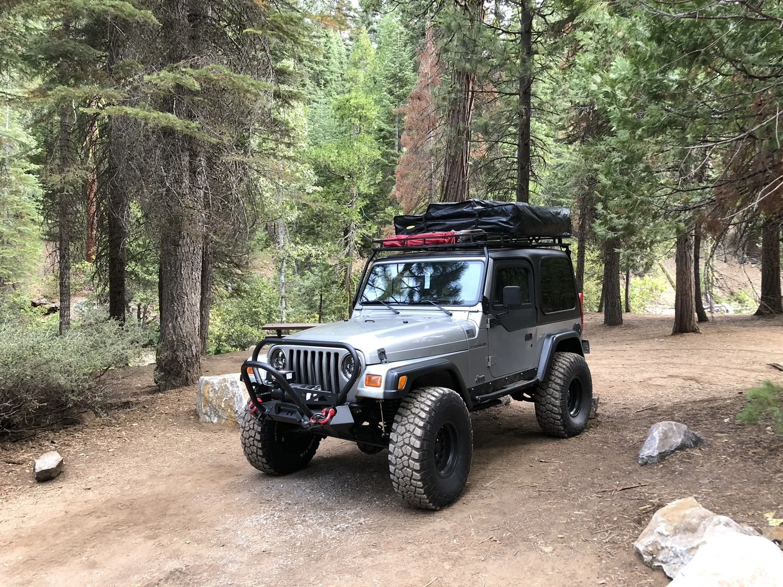

This is how she sits today
Metalcloak front and rear bumpers with tire swing out, Metalcloak rockers, BFG 35’s, smittybilt RTT and a few other things

Is that a Garvin Industries Roof rack? Been looking to get one for my TJ so I can add a rooftop tent. Has it been able to hold up to the weight/being rust free?
Yes it’s a garvin rack. I guess one of the good things about California is, rust isn’t much of an issue. I can’t give much feedback about that
And it’s pretty sturdy. I’m not worried about the tent and a bit more weight on it.

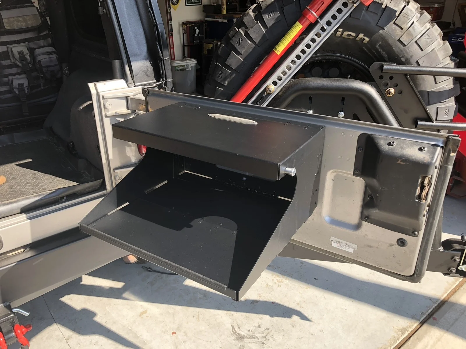

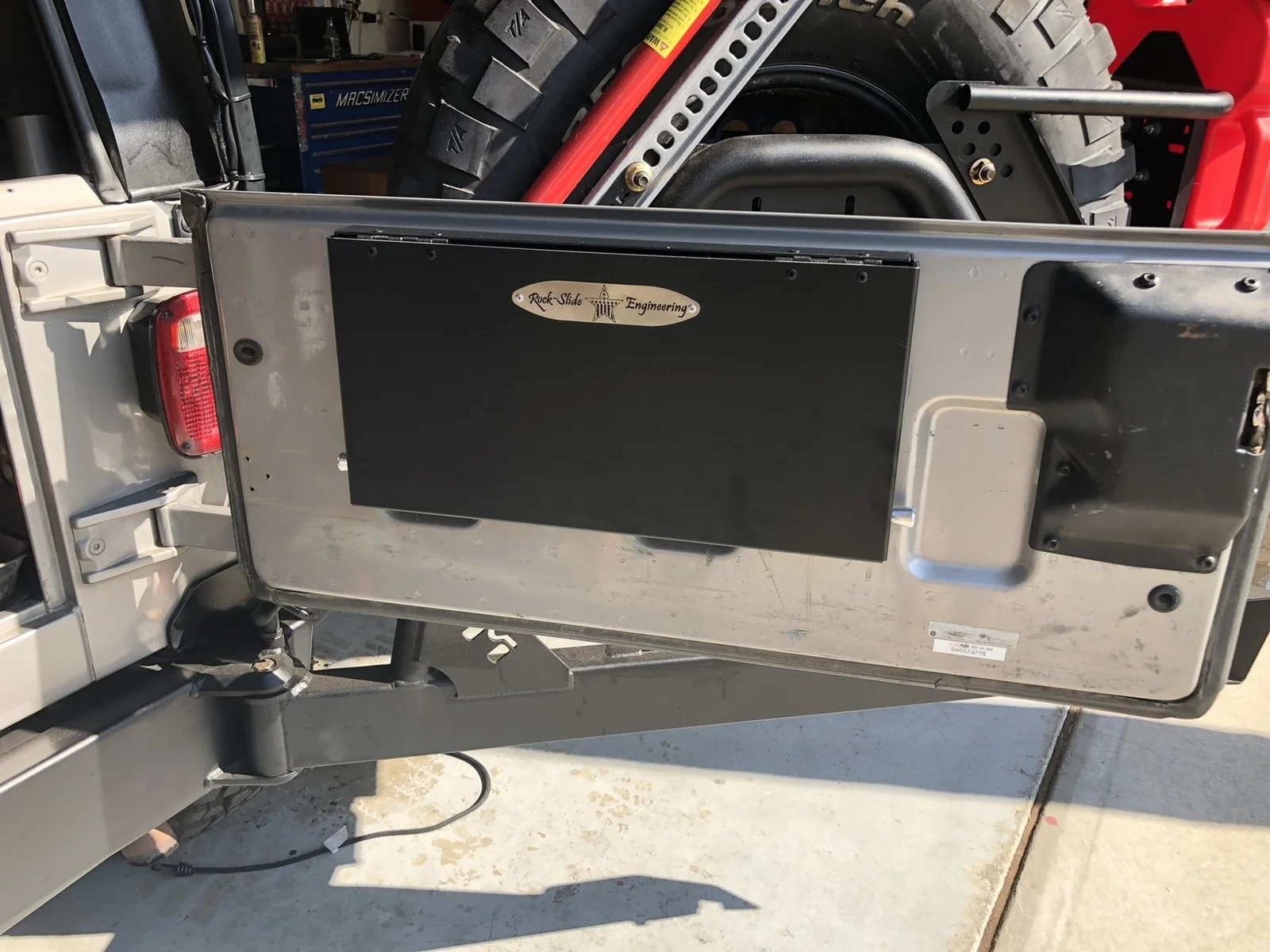

That's a cool tailgate shelf! Tell us more about the lift. Plans to re-gear with those 35's?
The shelf is killer. Amazon has either a single or this double shelf. I opted for more usable space
Rock Slide Engineering AC-TB-100-JTY Tailgate Table https://www.amazon.com/dp/B018H7GT1Q/?tag=wranglerorg-20

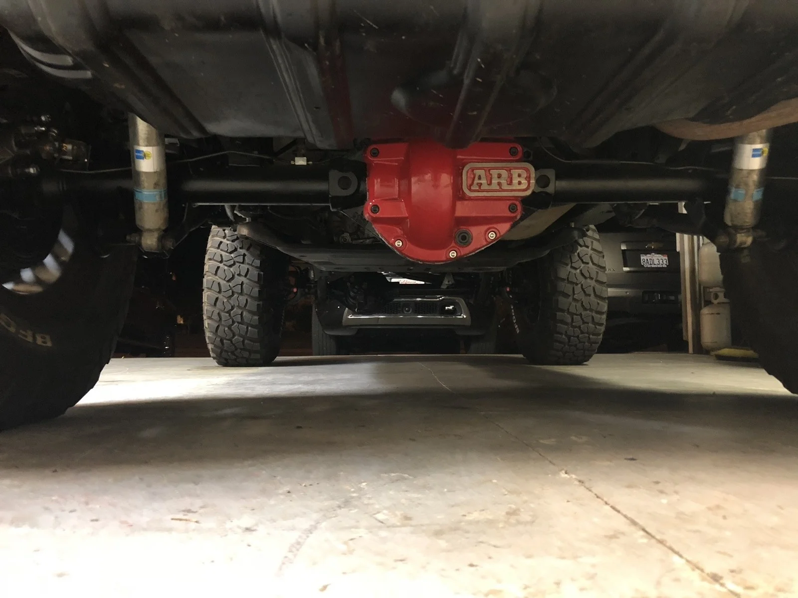

As far as axles and gears. As I promised myself to keep the build as cheap as possible. Hence the name “shoestring”

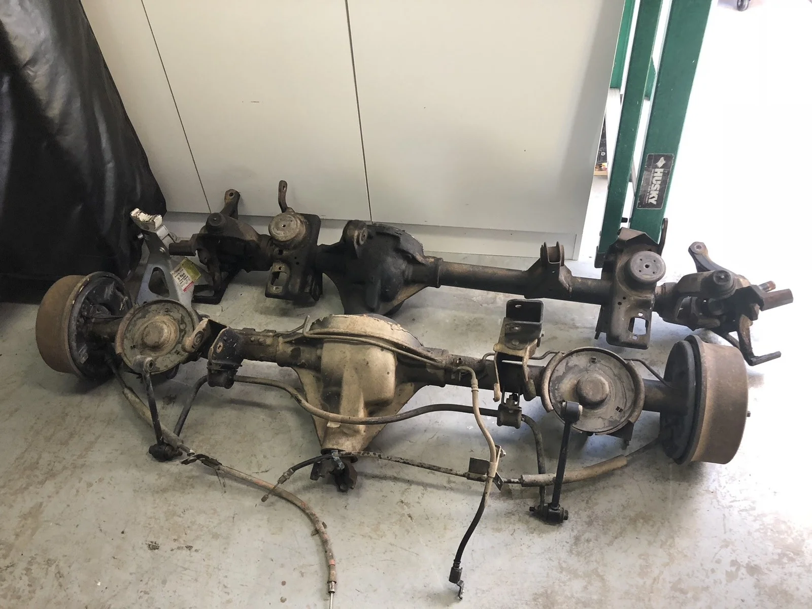

I scored BIG TIME with the diffs
The Jeep has the crappy 30,35 and I had been running around on the stock 3.73 gears. Rarely was I able to find 5th gear
A friend of mine was upgrading his LJ to rubicon diffs and installing a Metalcloak lift kit. For helping him with the install, he gave me his rear Dana 44 with disc brakes.
We all know how hard it is to find a front dana44 for our rigs. Out of absolutely dumb luck, a guy on Facebook marketplace was selling a rubicon front empty housing. After messaging back and forth I picked it up for $150!!! I installed 4.88’s with limited slip carriers both front and rear (because they were free [emoji16]) and I had to buy one front shaft while my friend gave me the other side
All in all cost wise. I have about $500 wrapped up in front and rear axles. And nice to have rear disc brakes too

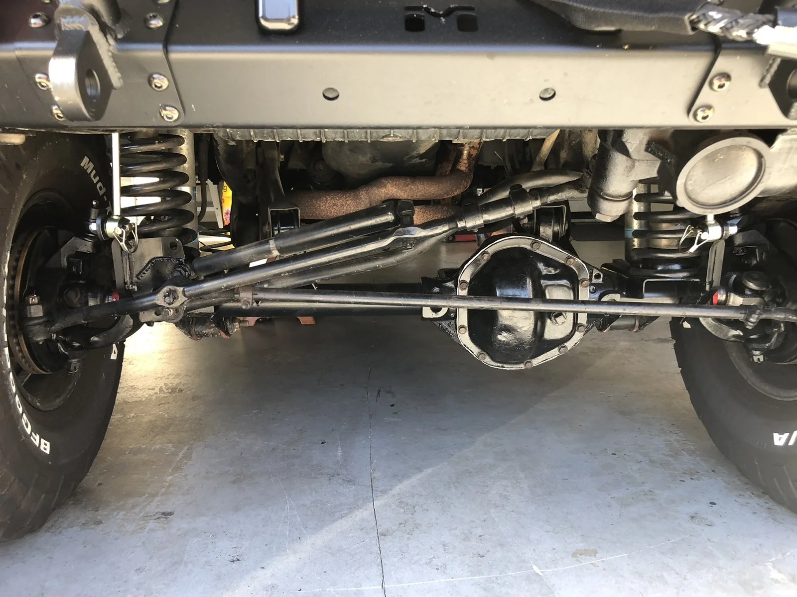

Weak fuses removed!
Heavier duty Dana 44 fuses installed! It’s just a ARB cover, it was free also lol
How extensive did you get while cleaning them up to get them shiny and black?
The diffs? Pressure washer and semi gloss paint

Nice to see more Overlanding TJ's! Garvin makes one of the best roof racks out there, right next to Gobi. How you liking the SB RTT? I've heard decent things on that one but i'm always curious to know how they hold up long term.

Wow dude, nice score on the 44's. Now you gotta get rid of that spindly tie rod. It ain't gonna last long on 35's. The ZJ tie rod conversion is a great upgrade for a few bucks.

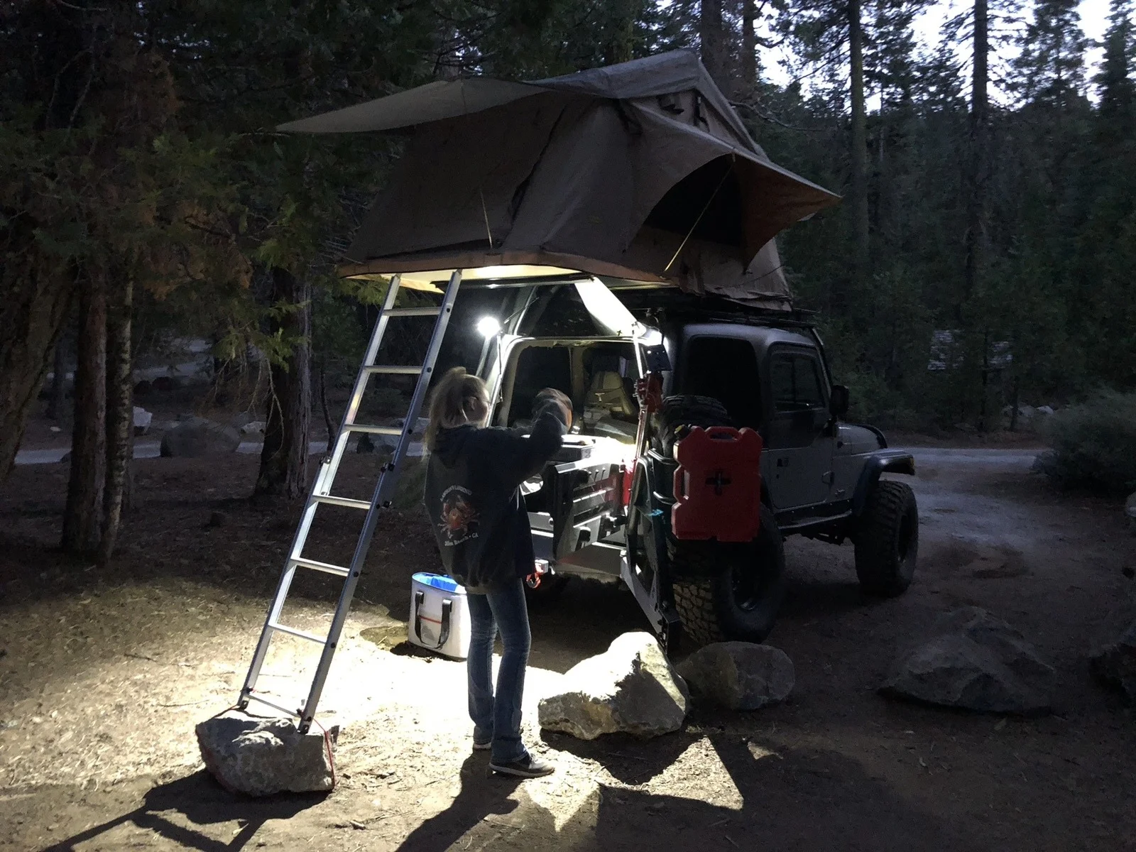

The one night we stayed in it. I couldn’t wait for morning. The mattress pad is horrible! I did wind up ordering a thin blow up mattress for next time until I can figure out a better solution.
The tent itself is great so far. I just need to get out and use it more

Definitely! I’m leaning towards the Currie correct link. It’s just money right? [emoji23]

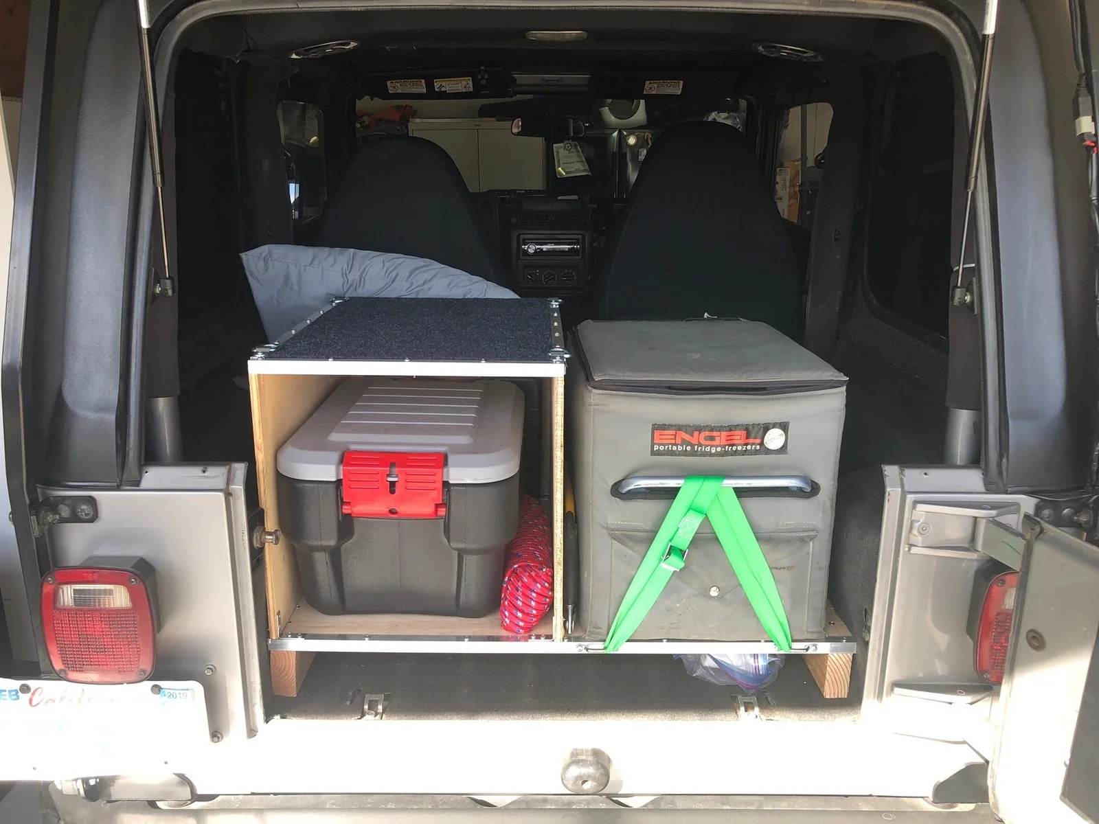

What are some innovative ways you guys have come up with storage solutions?
I have the smittybilt seat cover deals with the bags that are snapped on the back of the seats.
Looking for ideas that you all have seen or come up with

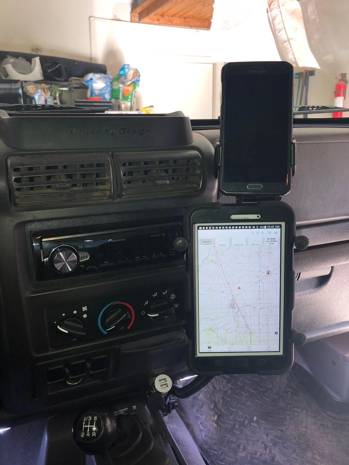

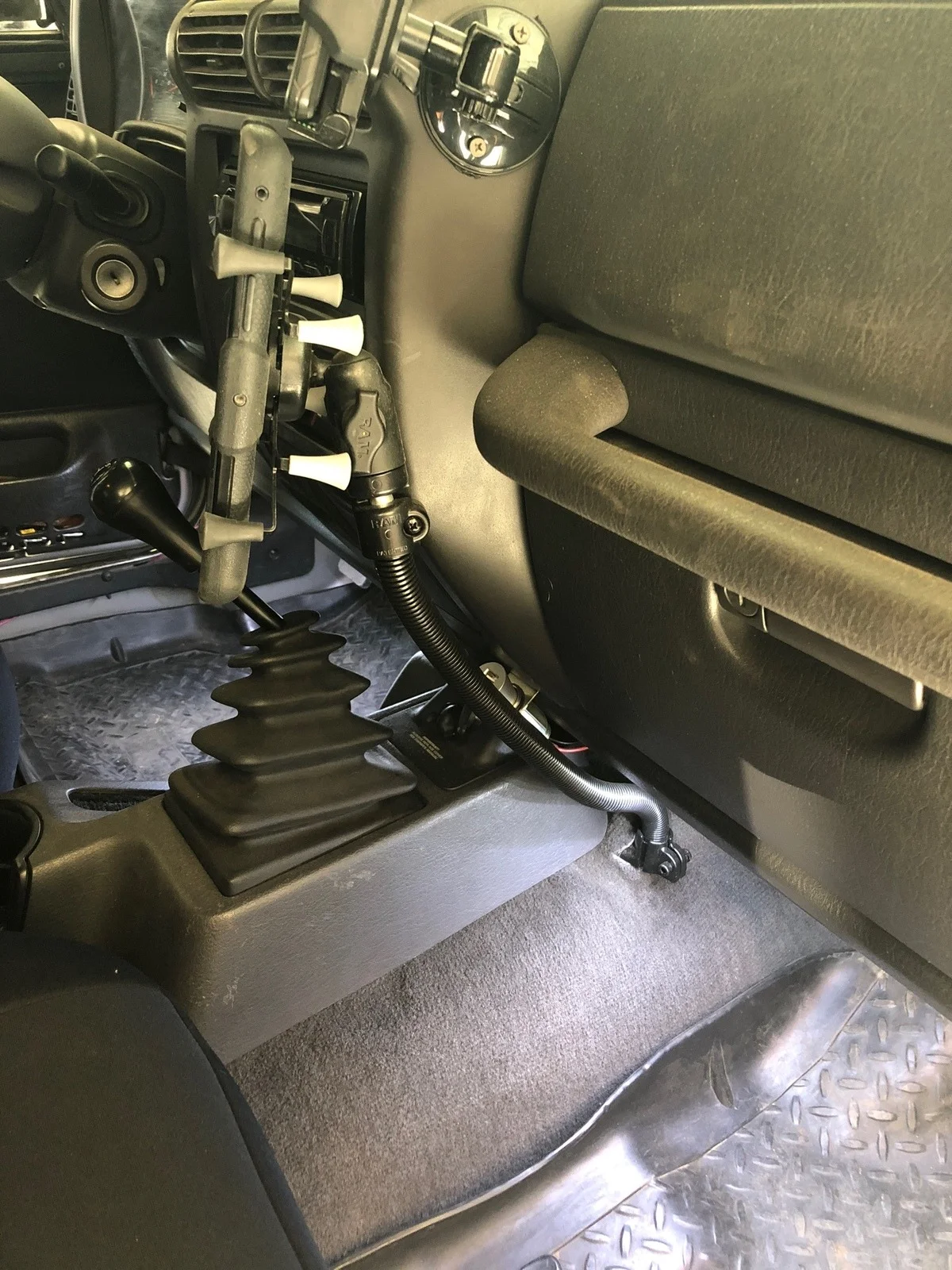

Installed a RAM floor mount for my tablet so I can view GPS Gaia app or any other mapping app
I don’t think I’m that thrilled with the mount though. Wiggles a lot while driving. I either need to find another way to keep the long mount bar steady or figure out another mounting option for the tablet

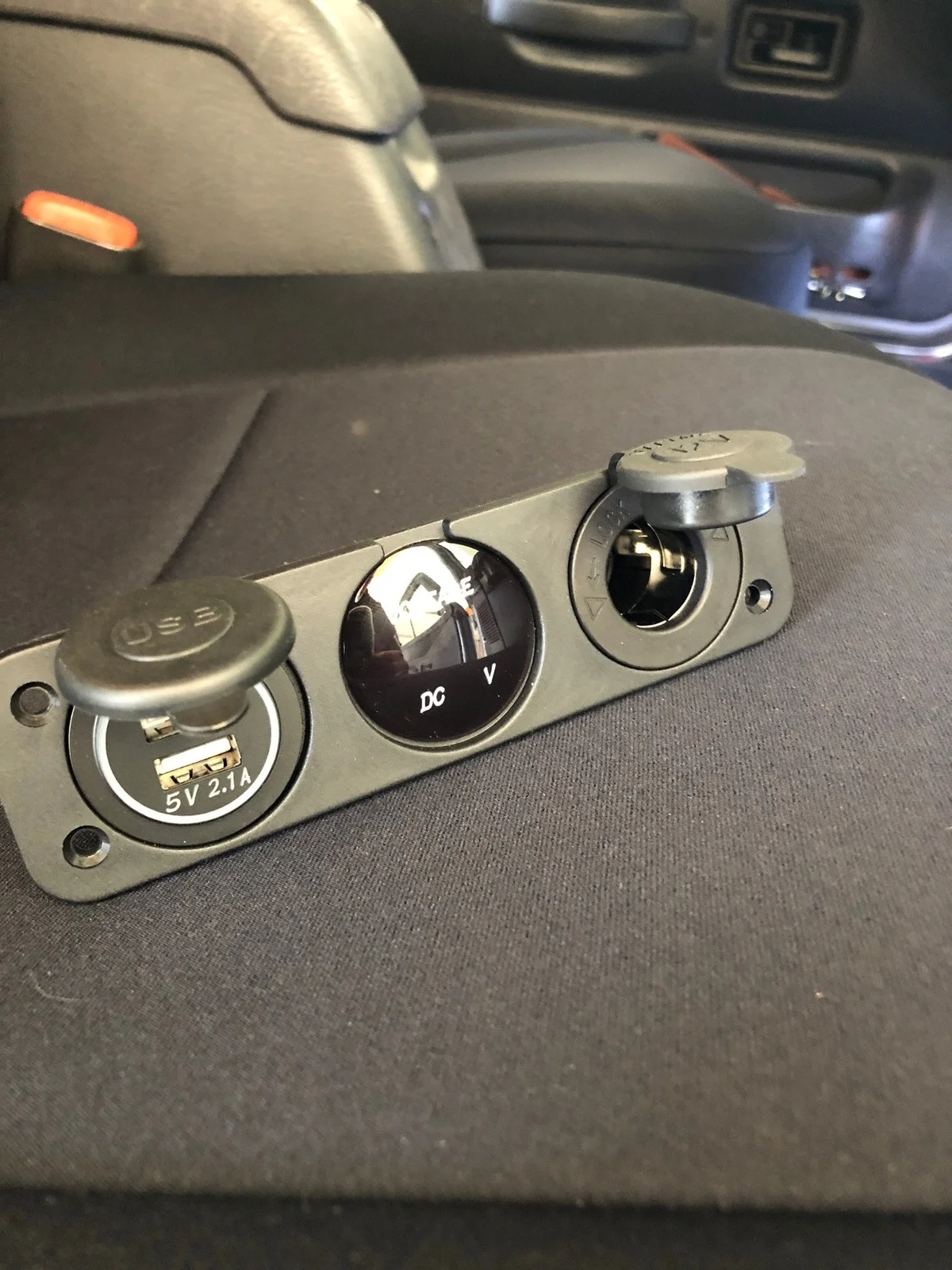

Today’s project is wire in this power supply somewhere
