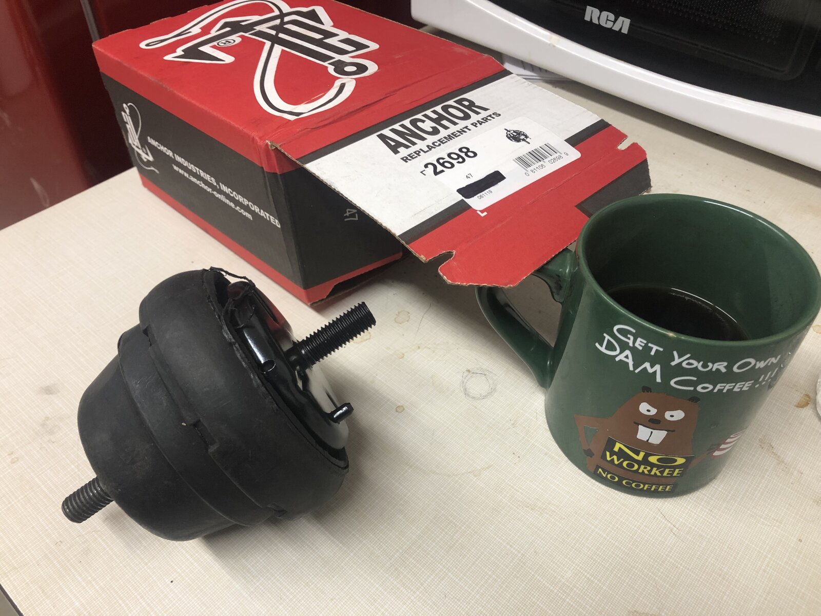

Maybe this is addressed in the videos, but I'm at work and can't watch them. What motor mounts are you using?
I thought I saw somewhere where you can get hydraulic motor mounts or something to help isolate the vibrations.
I'm curious because I really want to get a big diesel into my YJ truck build, but I'm trying to figure out a way to add some passenger comforts, like cushy body mounts, engine mounts and sound/heat insulation.

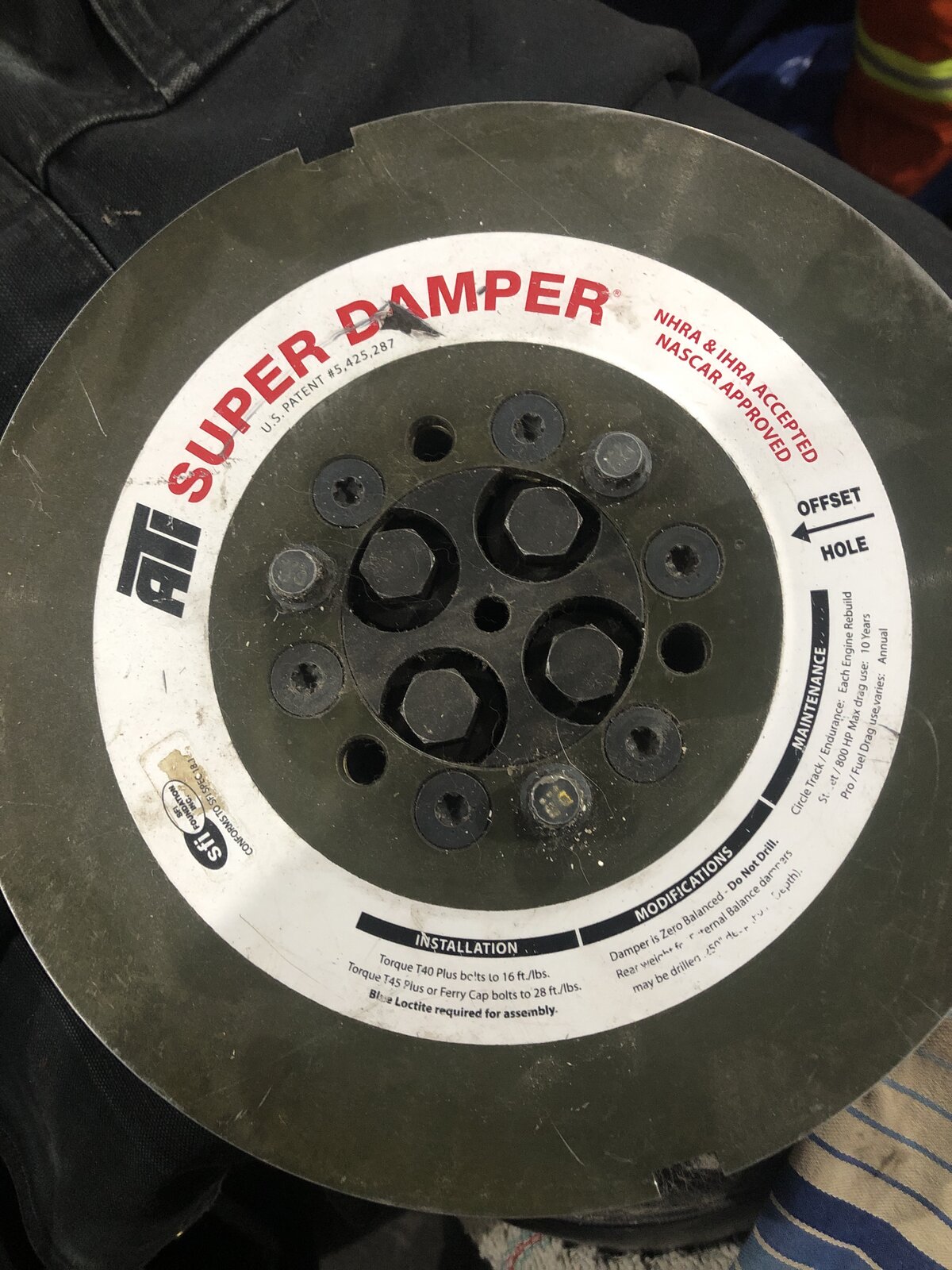

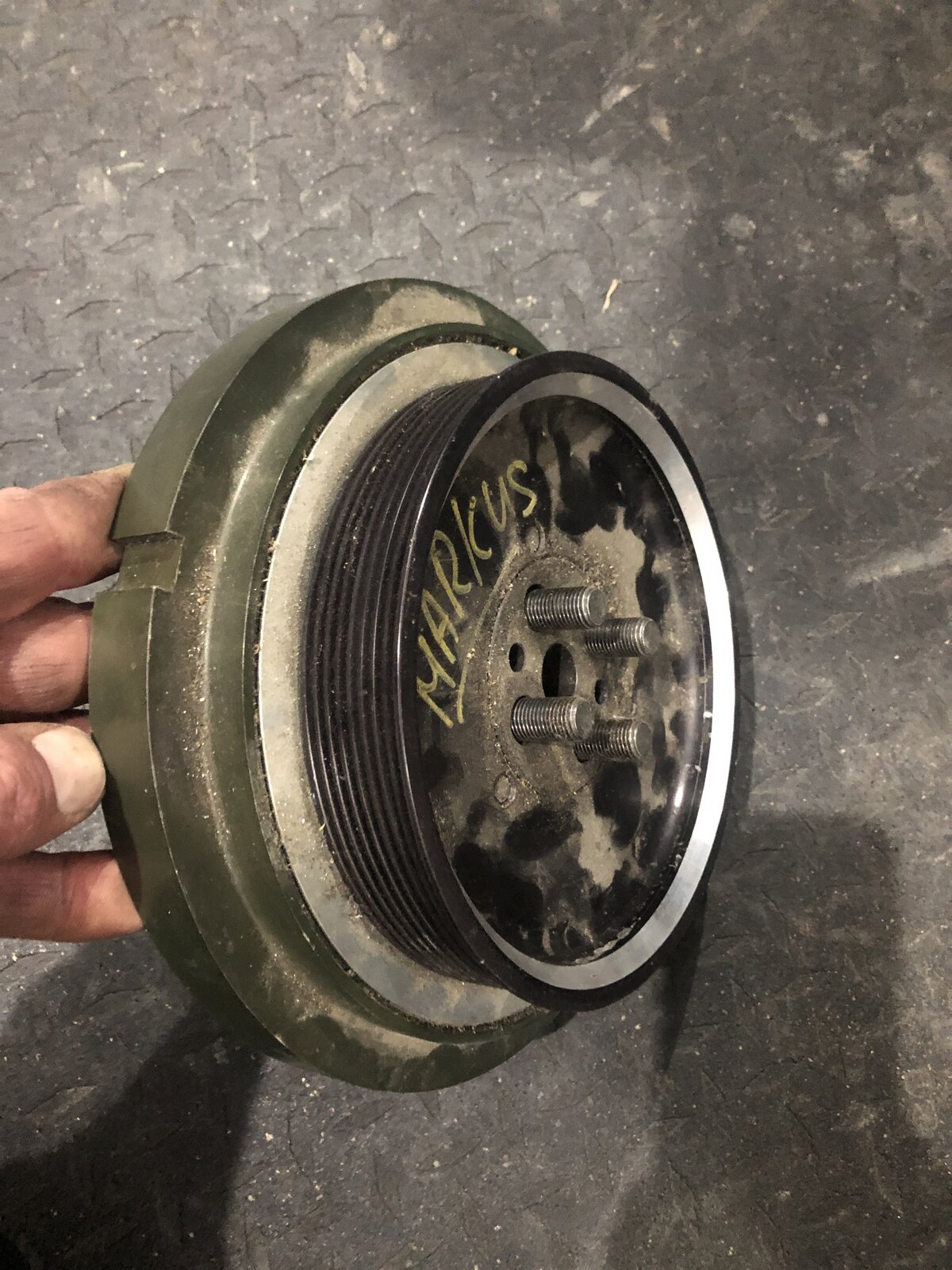

I also invested in a liquid filled harmonic balancer that I purchased of a local fellow who abandoned a 6BT project
Yeah that's exactly the stuff I keep wondering if it's worth it or kind of a gimmick.
I really want to go 6BT with my YJ, but I'm just not sure if it's realistic for my time constraints, lack of skills and budget and if it's going to be such a harsh ride at the end of the day that I don't like using it.
However I keep saying with engine swaps and stuff, I wish it pulled like and was as reliable as my 6BT...so now I'm hoping maybe I can get there and that 300 - 400hp ~700 ft lbs while getting low 20 mpg, is just plain fun all the time and practical when I'm towing. Of course it's highly likely I'm just gonna pick up another 1 ton. I'm just not sure I'm even going to have the time for another project. But I'd really like a slightly smaller 1 ton than anyone is offering.
BugoutJeep
Here’s what I purchased from … ? Can’t remember, sorry.
Possibly rock auto, I hope this helps
23 pounds !!!
That’ll absorb some vibs from CUMMINS’s shaker, eh 😱😂💯
23 pounds !!!
That’ll absorb some vibs from CUMMINS’s shaker, eh 😱😂💯%
View attachment 309281View attachment 309283
I think I'm using the same hydraulic motor mounts on my TDI engine, overkill? Yes but I'm aiming for some creature comforts in my build as well. Looking great @DETOUR I'm going to be following this build closely! I'd love to do a Cummins R2.8 swap someday in something, just not sure what it would be. Maybe a 4th engine in my TJ :ROFLMAO:
-Grant

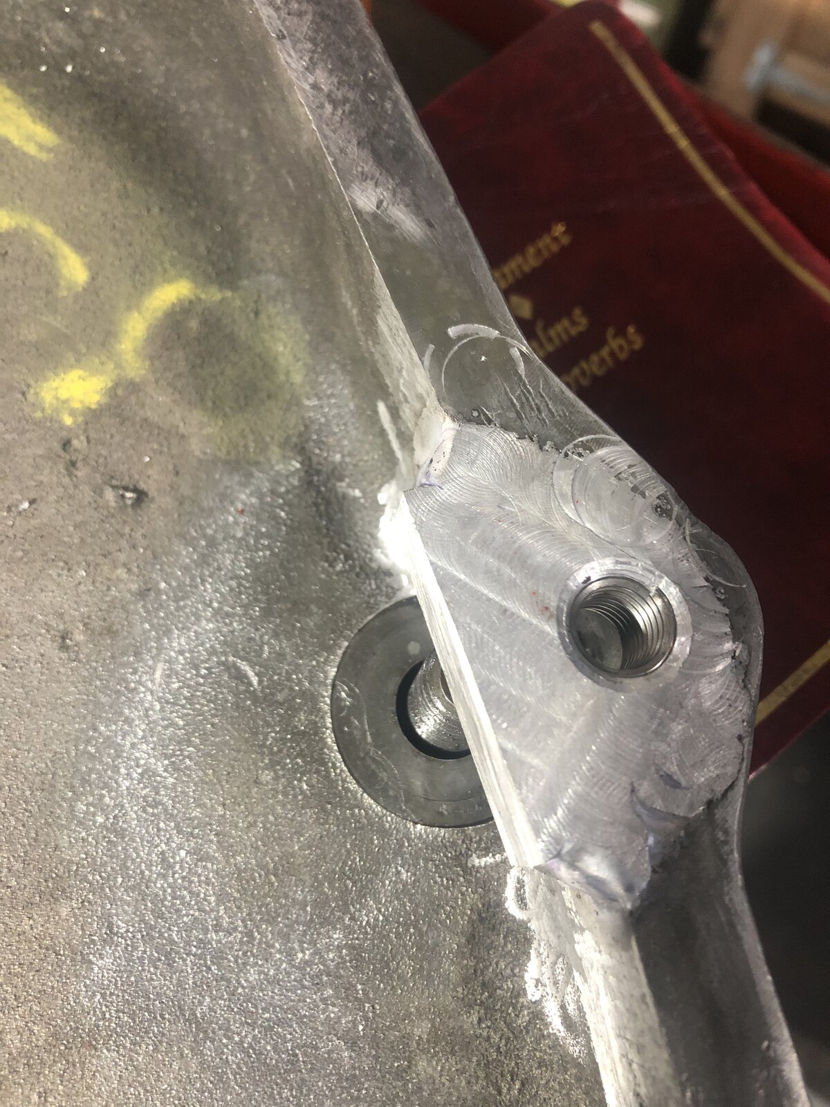

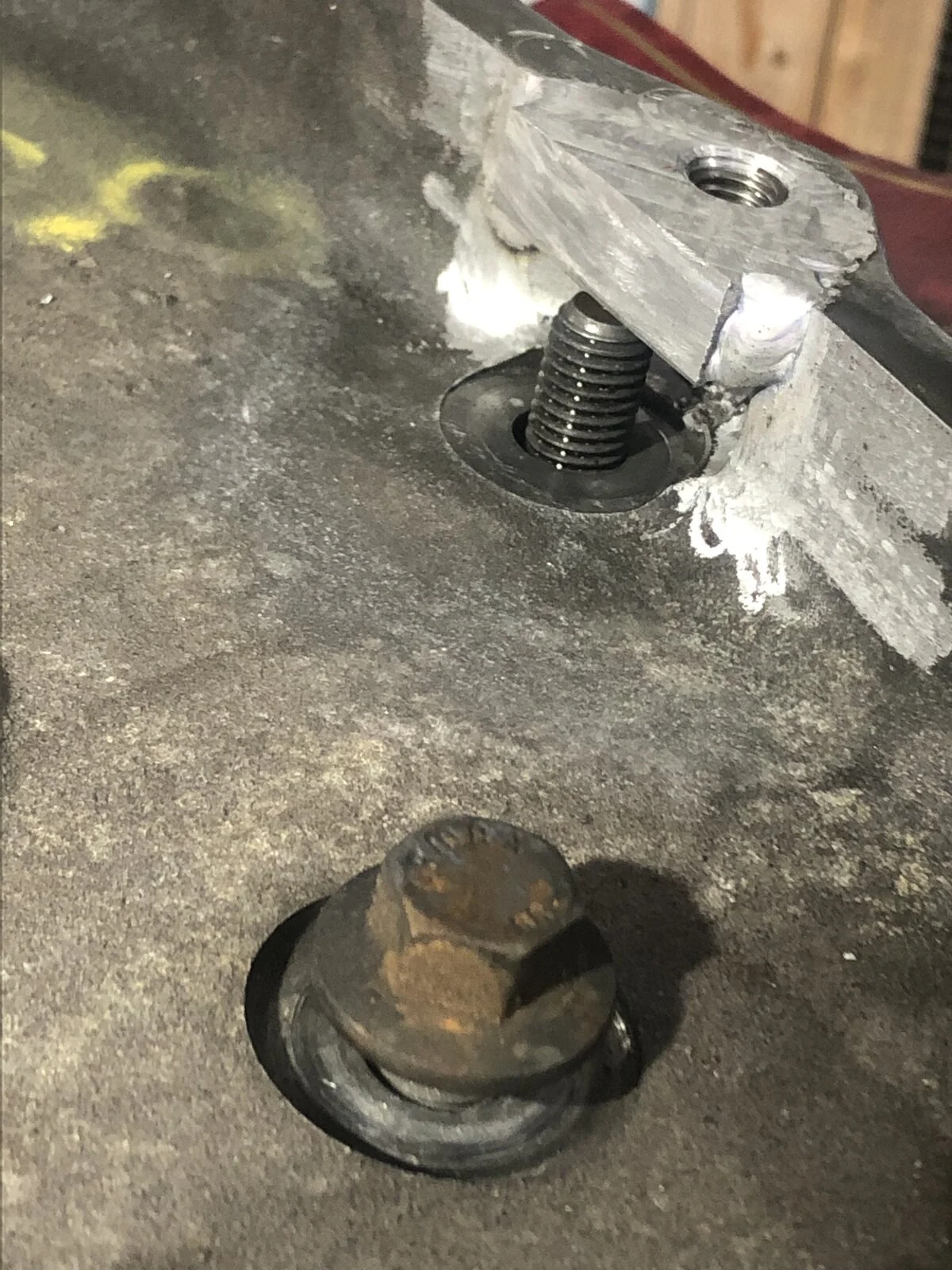

•A local fab shop modified the aluminum adapter plate with extra “meat”, to accommodate the 6th tranny mounting bolt hole
• the proper tranny bell-housing adaptor prized out at 2000.-
That way, I’m way below
number and can allocate the “savings” in another “cheap-place” 😉
•upgraded all 6 tranny bolt holes with M10x1.5 Helicoils
