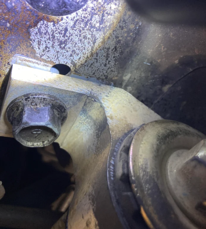

Sorry to hear about the Subi. A body shop with a good computerized rack might be able to tweak it back to get it to align for not too much coin.
Good to know, I know one shop in the area that's been in the business for 25+ years .. but they are just booked up till like Thanksgiving. I may get an opinion there since I know the owner through another contact.
Below is one of the tell tale signs I mentioned earlier (rear control arm mount shifted from subframe).

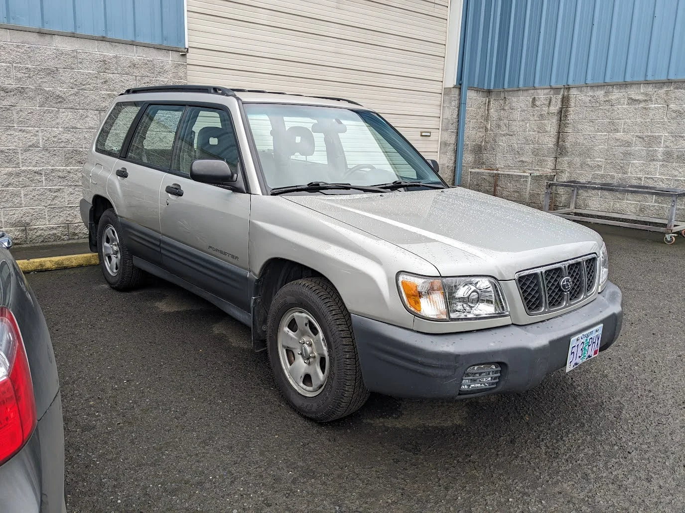

I was able to get the Subaru fixed at a body shop. They replaced the rear driver side knuckle and made the needed adjustments to get the alignment properly back in spec, which was great. I also took it to a local mechanic that they recommended and got everything looked at. Vehicle is in good shape, and I decided to get new pads/rotors and new full strut assemblies and new spark plugs (and new fluids/filters of course). They said the head gaskets look OK for now and I will keep a close eye on it, but I budgeted for a replacement so I have no worries.
The car drives and handles really well now and I am happy with the outcome. As always, it takes someone who knows what they are doing and who wants to help people solve problems. I don't miss the XJ and I am happy with this old Forester as a daily driver, it's just the right size.

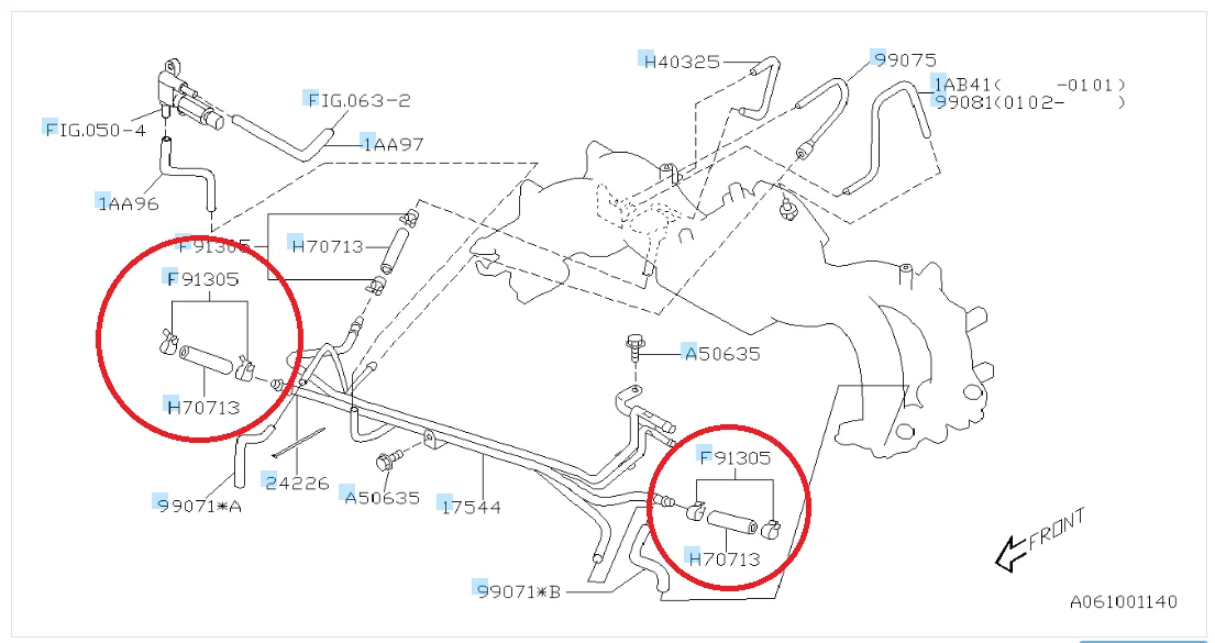

Our '02 Legacy was the auto trans - probably very, very similar to yours. It was still running strong when we sold it at 211k, so hopefully you have good luck! Here are a few other odd things to look out for that we dealt with on that Legacy, which may affect your Forester since they have identical engines and trannies:
  • There are a couple of very short rubber lines connected between the chassis fuel lines and the engine fuel rail on each side at the front of the engine:
  • For several years, we'd smell gas in the fall, and it took me a while to find the source. It seemed that over time, the hoses lost elasticity, and when the temperature changed, the rubber hoses expanded at a different rate than the steel lines on each end, resulting in leaks. If yours has the same hoses, and you smell gas when temperatures drop in the fall, look at those hoses. If they seem to be the source of leaking, replace them, but use the Subaru OEM hoses and clamps. Tightening the clamps will temporarily work, but eventually, the hose will fail from too-tight clamps. Also, aftermarket hoses and clamps seemed to always repeat the problem the next fall. I think I still have some OEM hoses, and maybe clamps, in my spares box for that car, and I'll be glad to send them to you. I'd rather see someone use them than have them rotting in my shop! Even with the low miles on your Forester, it's old, and I'll bet the hoses are a bit stiff now and due for replacement. I'll look for them tonight and let you know if I still have them.
  • The EVAP system for that vintage Subaru is fragile. Don't let the fuel hose overflow when filling because the raw fuel will overwhelm the charcoal canister (I think Subaru put out an advisory on this back in the day.) I replaced the purge valve about four times until I realized that the canister was shot, and carbon was being drawn through the purge valves when the canister was purged by the engine control module. The tiny pieces of carbon were causing the purge valves to fail open. It's really easy to tell when this happens because the car will be hard to start, and rough-running once it does start, immediately after fueling up because fueling stirs up vapors in the tank that get drawn into the intake, creating a rich condition due to the open purge valve. I ended up replacing the canister because the carbon was loose in it, and after that, no more purge valve problems. So, if you have a purge valve failure, check the canister before replacing it because those purge valves are pricey! You shouldn't hear loose carbon in it when you shake it.
Those were the only issues, other than the head gasket, we had in 9 years and 157k miles of ownership of that Legacy, but they were a pain to deal with because it took me a few years to find the root causes.

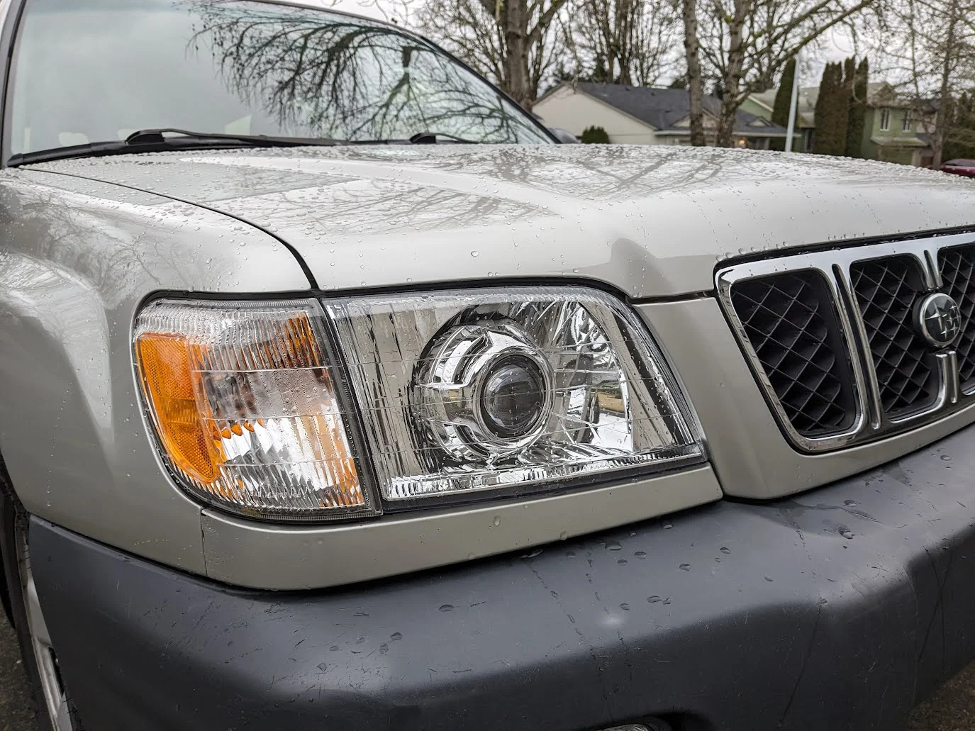

The OEM lights are pretty dull so I got new HID retrofit headlights from a company in Colorado. I was very particular that I wanted a high quality OEM style light and not something that looked alien with DRL/halos etc. Good experience ordering/discussing from these folks and I am very happy with the lights. The output is fantastic, bright but not glaring to oncoming drivers and with a nice cutoff. The lens looks darker in the close up but it looks more like what you see in the first photo.
The XJ is a distant memory.

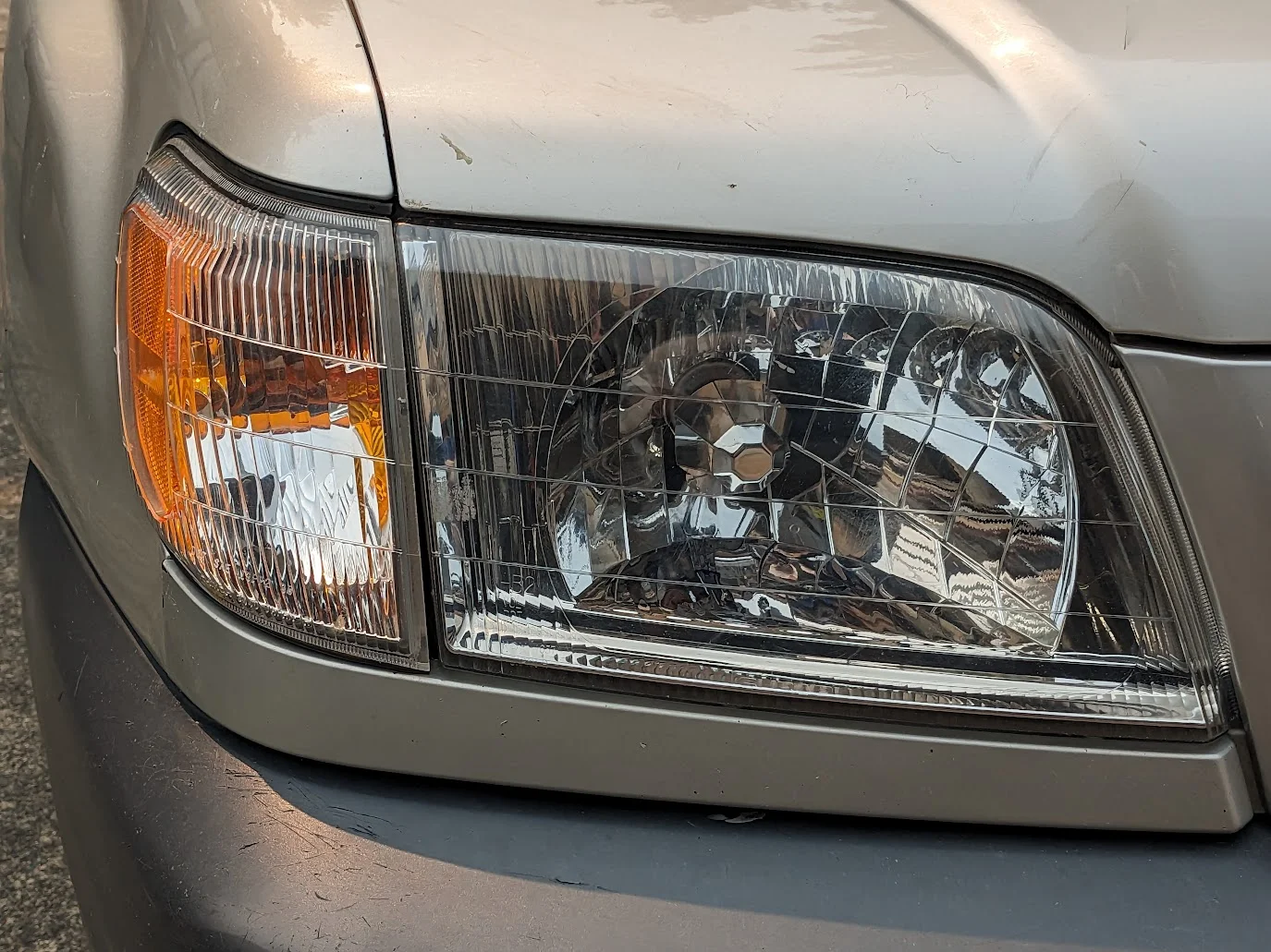

The originals for comparison -
