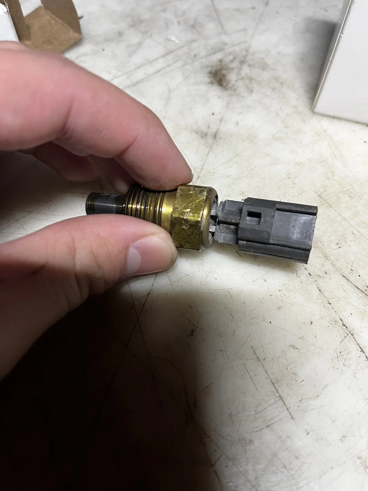

Well the amazon replacement came in today...... and despite the fact that amazon says it fits, the electrical connection is incorrect. So I bought another one from amazon that has the correct connector. Until then, I re-installed the old one and heres what we're working with.
it's hard to see in the photo, but the only thing holing the connector into the brass is the metal blade terminals. one 1/2 decent tug and the electrical connection is coming right out.

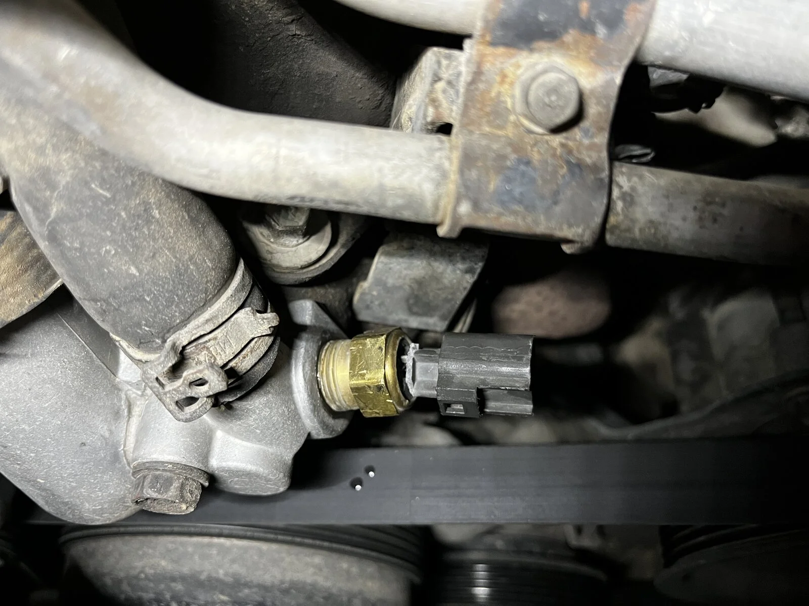

when I pulled the old sensor out, this is what it looked like:
you can see the obvious problem at the base of the electrical plugin, but there is also a suspicious residue on the end of the sensor, seems harmless but has my attention none the less.

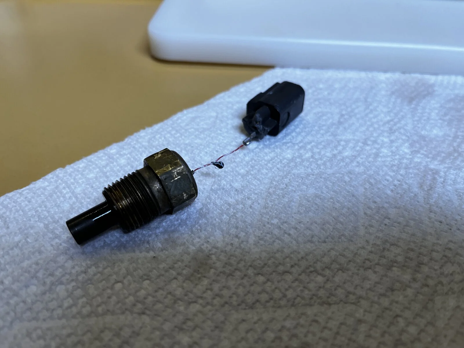

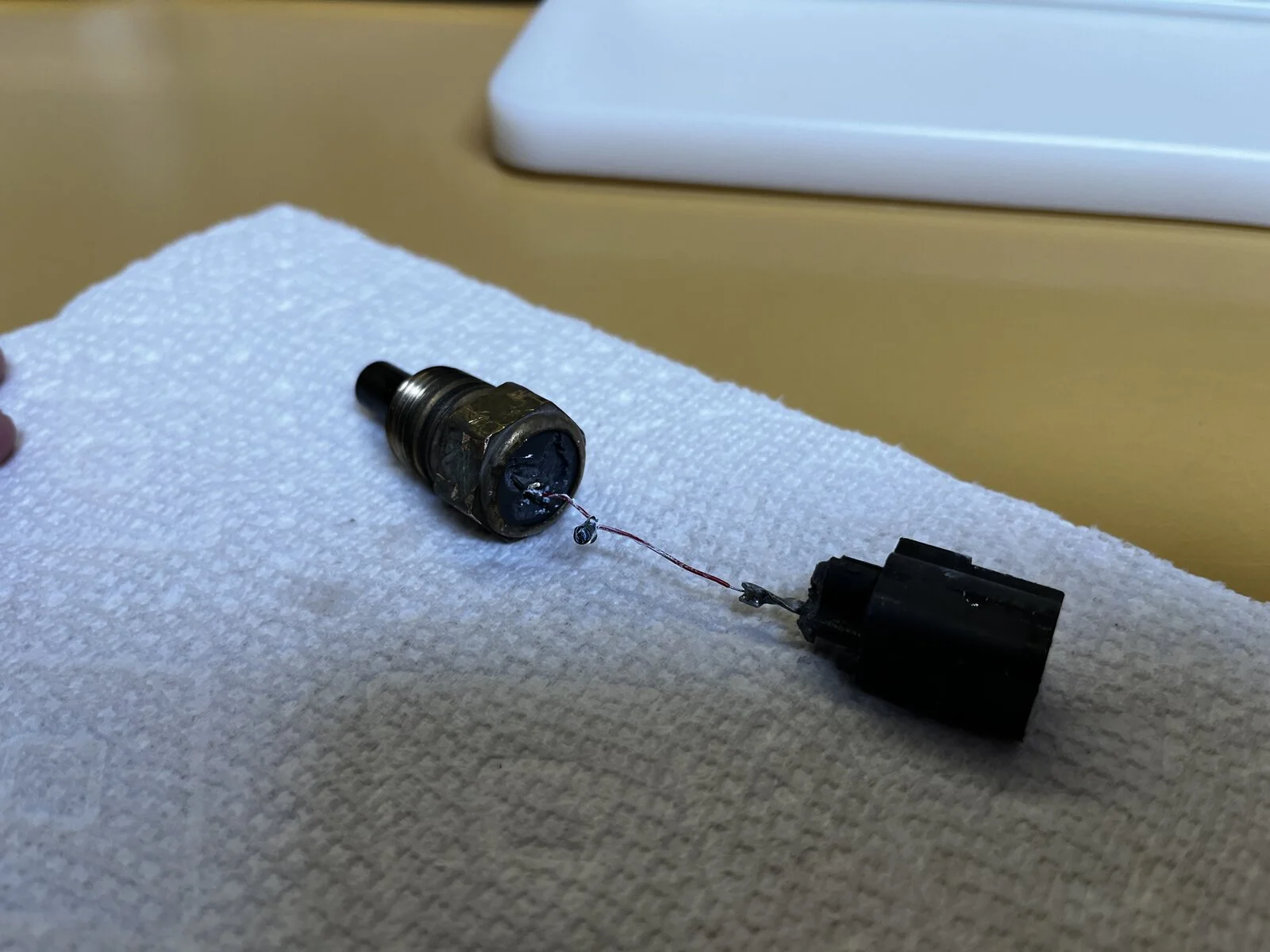

Curiosity got the better of me and I decided to get some destructive testing in, pulled the connector the rest of the way apart and this is what I found.
There was a white paste like substance packed on what I assume is the temperature sensor and around the wires. it appears to be packed inside the main body of the sensor behind the plastic cap or plug that goes into the brass. The red wires are then soldered to the spades that connect directly to the wiring connector. I am not 100% sure what failed before and after diss-assembly but the soldered wires seem like a potential point of failure, and the white paste like substance is interesting to be, purely because I don't know its purpose.

something is probably loose under the hood and pulling on the wire that connects to the sensor plug. the problem has got to be with your jeep not the many sensors you tried.
Interesting theory, I like it. I’ll double check wire routing tomorrow
