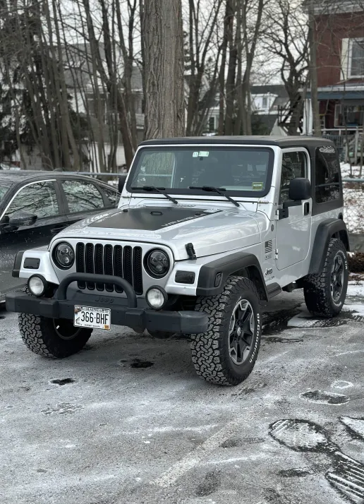

I've been looking into regearing my '04, currently sitting on close to 31 inch tires I believe. Even though its not on 35s or anything, I'm definitely looking at trying to get a faster feel out of the car. Yes, it's a TJ, it'll never really be fast and I don't have the money for forced induction at the moment unfortunately. However, I'm curious to hear yalls experience with the car before and after regearing. Is it really a noticeable difference? I was thinking about upping to 4.56 considering I might up the tire size in the future, and I'm really looking for that quick feeling. This thing may be slow but it gets driven like a sports car I must admit. Thoughts on gear ratios/experience with the feel of the car are greatly appreciated. (Also, I'd probably just swap the entire axles with some factory 4.56s I found, sounds like it'll be cheaper than a shop regear.) Thanks
I've been looking into regearing my '04, currently sitting on close to 31 inch tires I believe. Even though its not on 35s or anything, I'm definitely looking at trying to get a faster feel out of the car. Yes, it's a TJ, it'll never really be fast and I don't have the money for forced induction at the moment unfortunately. However, I'm curious to hear yalls experience with the car before and after regearing. Is it really a noticeable difference? I was thinking about upping to 4.56 considering I might up the tire size in the future, and I'm really looking for that quick feeling. This thing may be slow but it gets driven like a sports car I must admit. Thoughts on gear ratios/experience with the feel of the car are greatly appreciated. (Also, I'd probably just swap the entire axles with some factory 4.56s I found, sounds like it'll be cheaper than a shop regear.) ThanksView attachment 669172

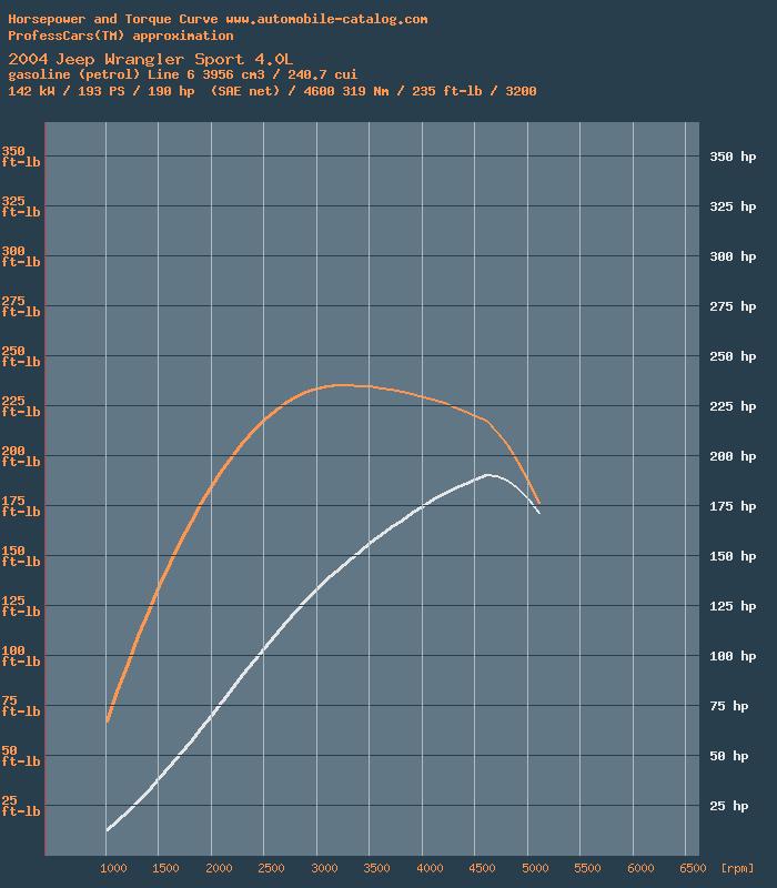

Despite it's reputation, the 4.0L doesn't make huge torque down low and 190hp at peak wasn't setting the world ablaze either. The power band from 3200rpm peak torque to 4500rpm peak hp is narrow compared to more modern engines. The gearing change is about changing the rpm at a given speed in a given gear to move up that curve. It does not make the 4.0L more powerful, it just puts you in a higher power part of that curve. And this is noticeable, but it's still only 190 hp at most. It's not like dropping a modern V-8 in it.

Then plot the rpm at current and new gear ratio at speeds you care about against the factory curve to see the difference in max power available.
