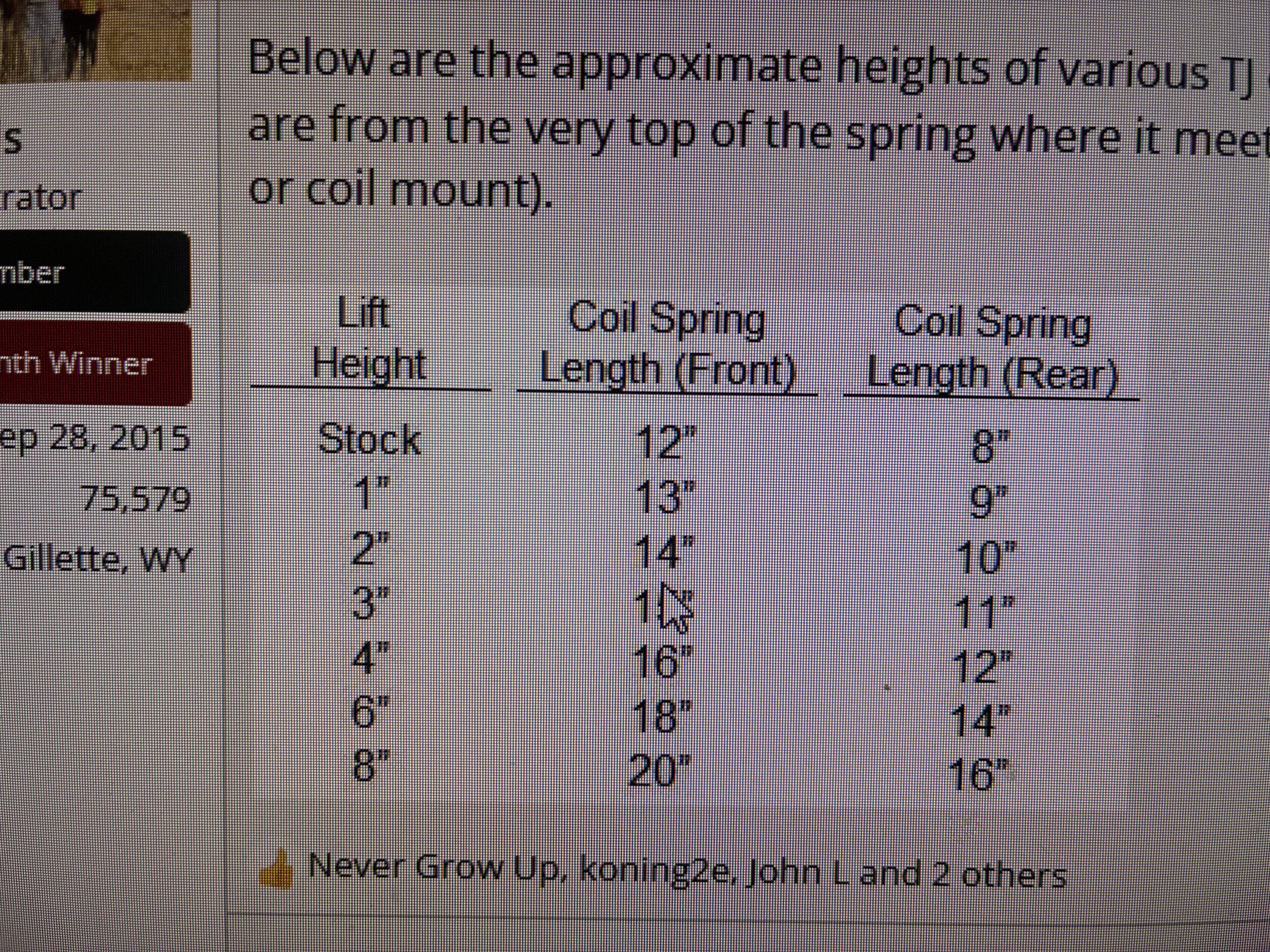

I am looking to purchase the JKS adjustable track for 1-6” of lift as my stock one is bad. The previous owner put on 2 inch puck lift on the front so I was thinking a 2” lift. I measured my springs and they are 11” in height. So with the springs and puck it’s 13” in total. Going off this picture I found in a differed thread does this mean I only have 1” of lift and not 2”?
If so would the jks track bar work as I have 1” of lift?
Thanks!
Yes, it sounds like the old springs have sagged and you have effectively 1" lift on the front.
Which of the 3 JKS front track bars did you have in mind? The JKSOG126 is for 1" to 3.5" lift.
I don’t recall which one I was looking at but I’ll probably end up getting the one you said since I do have a 1” lift from the PO.
