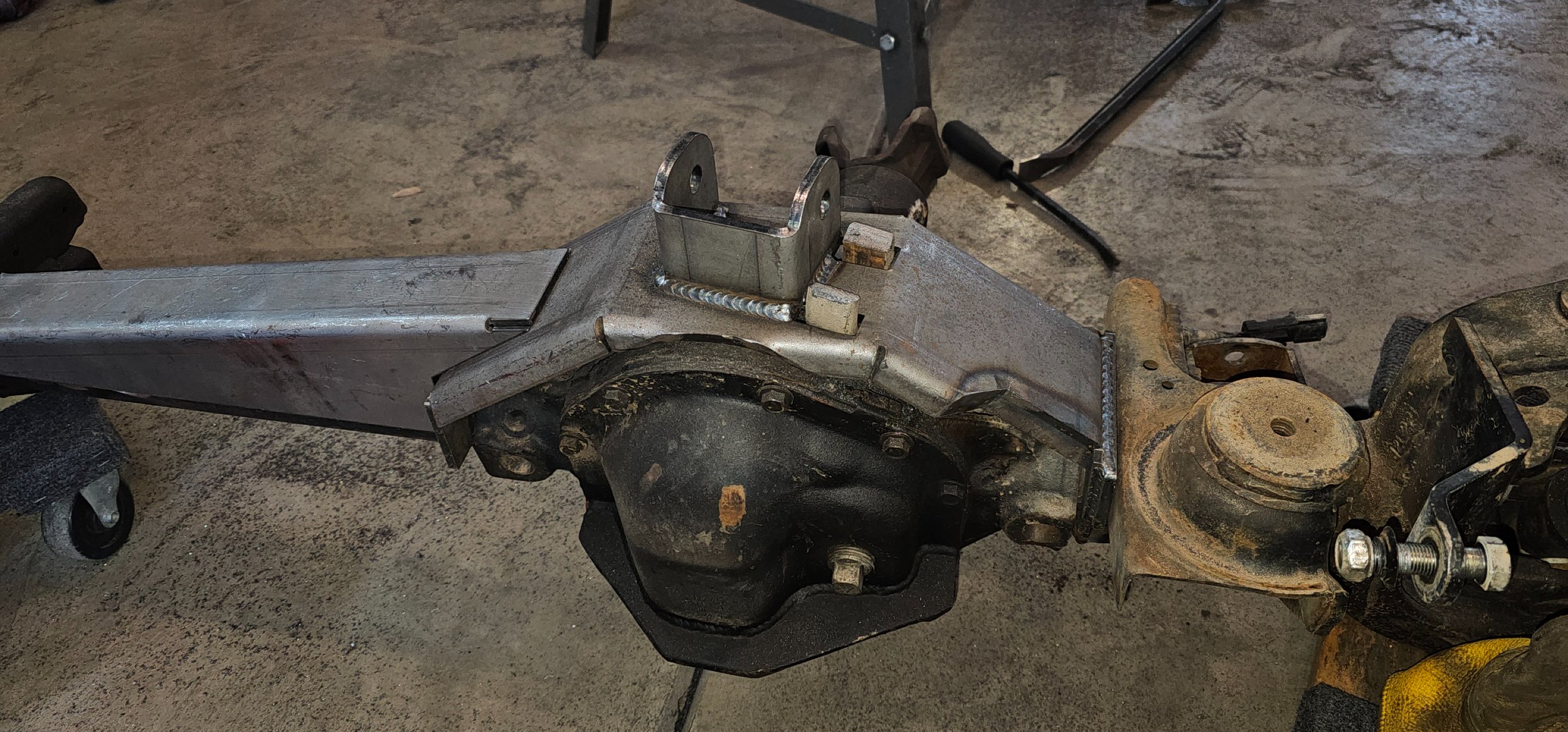

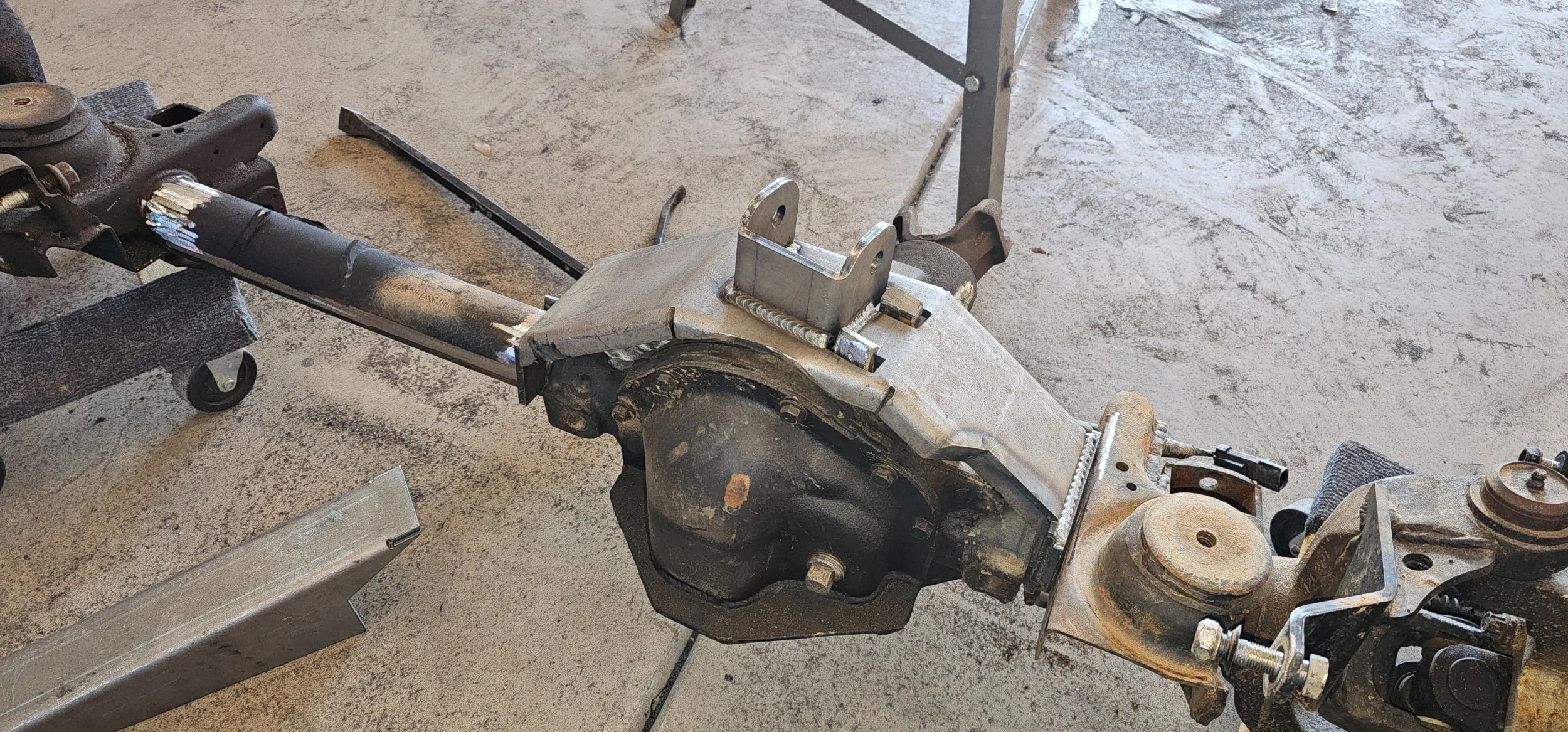

That joint isn't big enough to handle the work of 2 joints so it won't work very well for a single upper. Truss it with a mini truss and put a lower joint and mount on top of the diff if you insist on a single upper.
Reactions: jxv1247
... Truss it with a mini truss and put a lower joint and mount on top of the diff if you insist on a single upper.
Something like this, as an example...
Reactions: jxv1247
