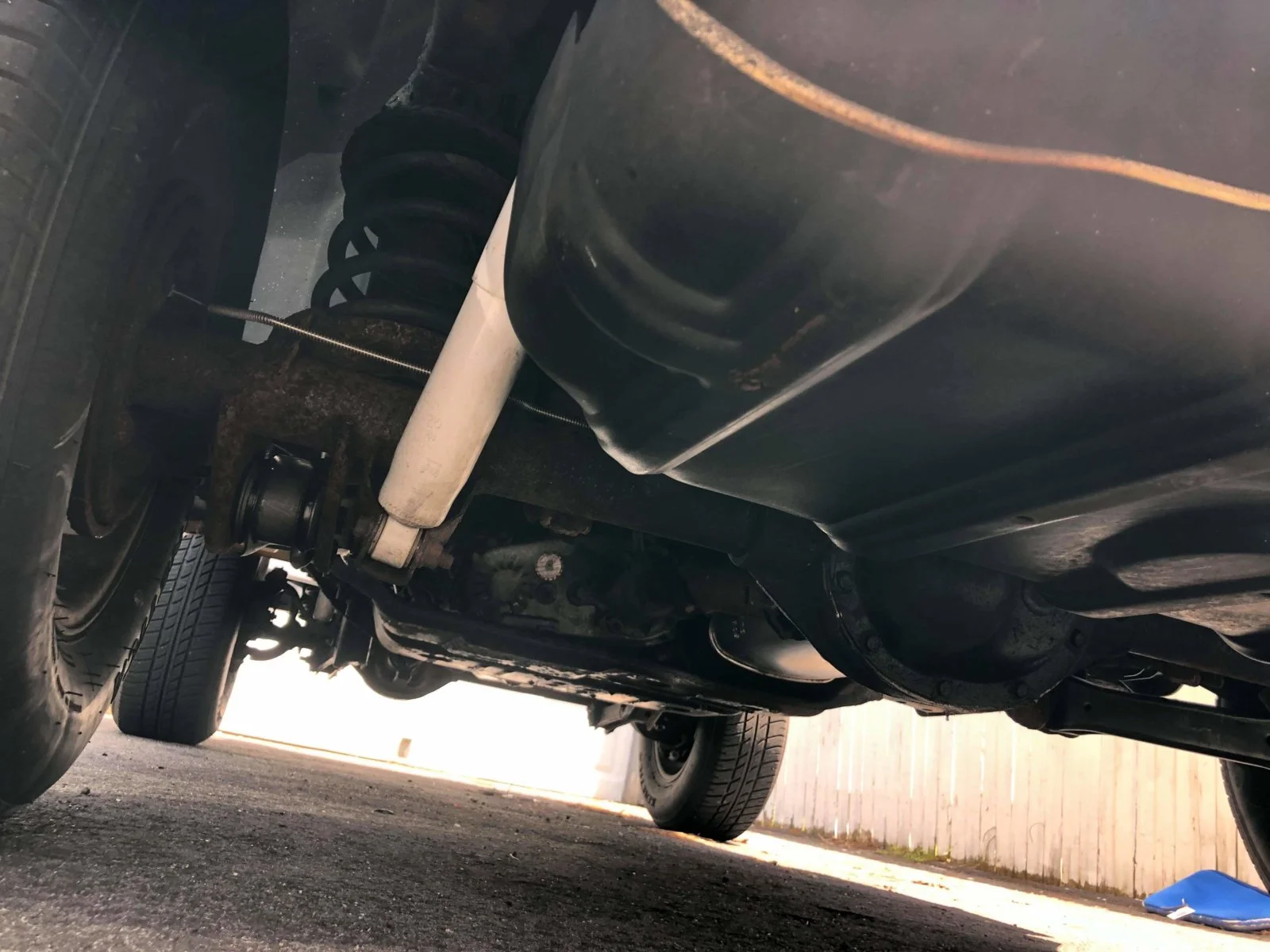

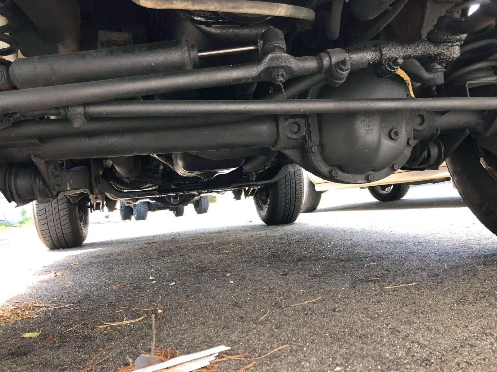

these are the only undercarriage pictures I have of Jeep
Looks good, does it have a Dana 44 rear axel? It was an option with the Sport model, and is the prefered rear axel for a TJ. The frame looks suspiciously clean from your pics, get under and make sure they aren't hiding rust issues. Look up the VIN and see how it was set up at the factory. Have fun, your daughter will be disappointed when you don't hand it over in a couple of years like you said you would!

I'm seeing a new gas tank skid, which probably means the old one rusted out, which probably means this Jeep saw a lot of salt action. Definitely check that frame thoroughly.

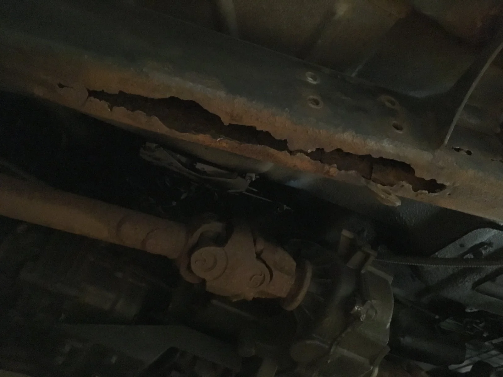

To be perfectly Safe, you should find someone that you can borrow an inspection camera from (you can find one at harbor freight for $77 ) to inspect the inside of the frame to truly see the condition. I bought a 99' Tj that seemed fine on the outsides of the frame. I tried to take the transfer case skid off and the nutserts broke so the bolts just spun. Once I finally got the skid, off, this is what I found. The pics of the outside only go so far and this was much more than just a 77 dollar repair (Had to buy safe-T-caps and welded them on to just get her back on the road) My advice is to get the camera and do a thorough inspection. You can then use the camera to check the coverage of the inside frame coatings (which you will definitely want to do) once a year . I agree with Bromel, if the gas tank skid had to be replaced then the frame probably saw a lot of salt. If they didn't wash out the gas tank skid, they probably never washed out the frame.
