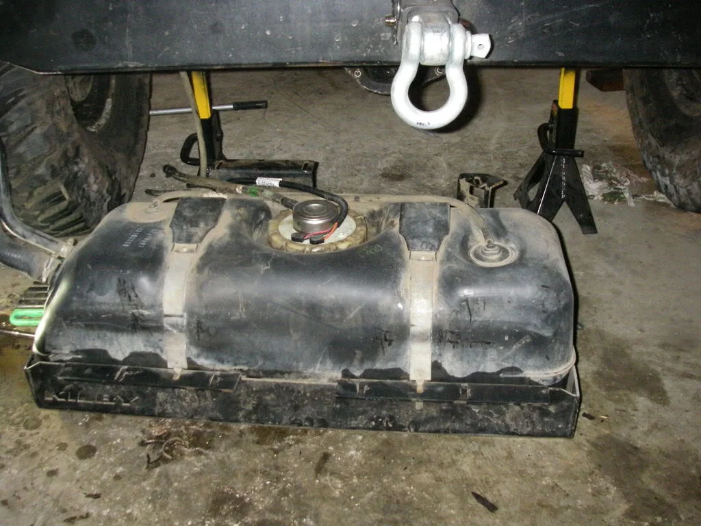

See the spanner wrench in the picture? It isn't needed to remove the ring that holds the pump/sending unit in place but it helps. I used a large pair of Channel Locks the first time I ever removed one.
The large white ring on top is what I am talking about.

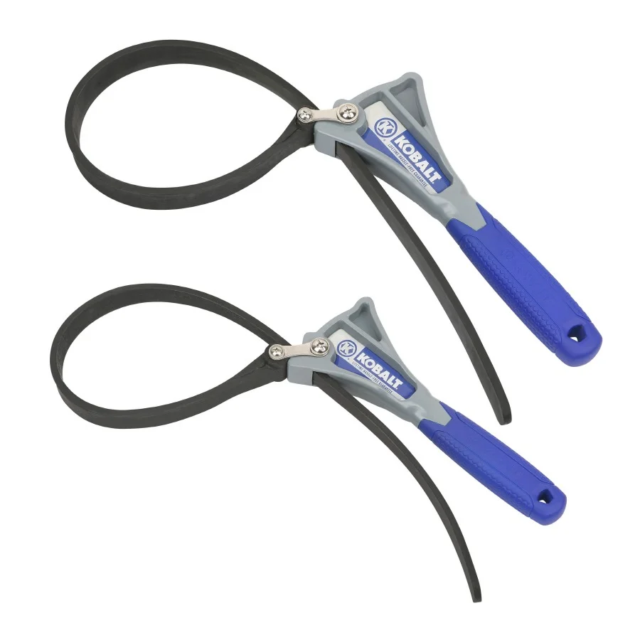

Thank you this probably just saved me s headache haha. I'm going to get this wrench
All that's needed for that nylon lock ring is a large strap wrench. The ones that are in the tool departments tend to be too small for this job. I found my large strap wrench in the plumbing department. Those with rubber straps don't hold up for me.
I've replace 3 Wrangler fuel pumps to date and each time I used a piece of soft pine and a rubber mallet to remove the nylon lock nut without damage. Seems as though a few light taps was all that was needed.
