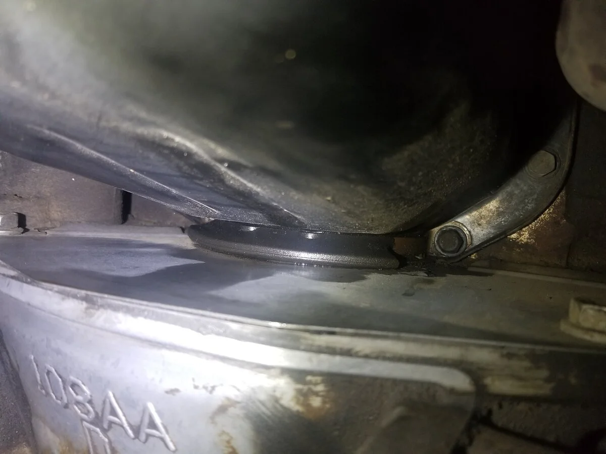

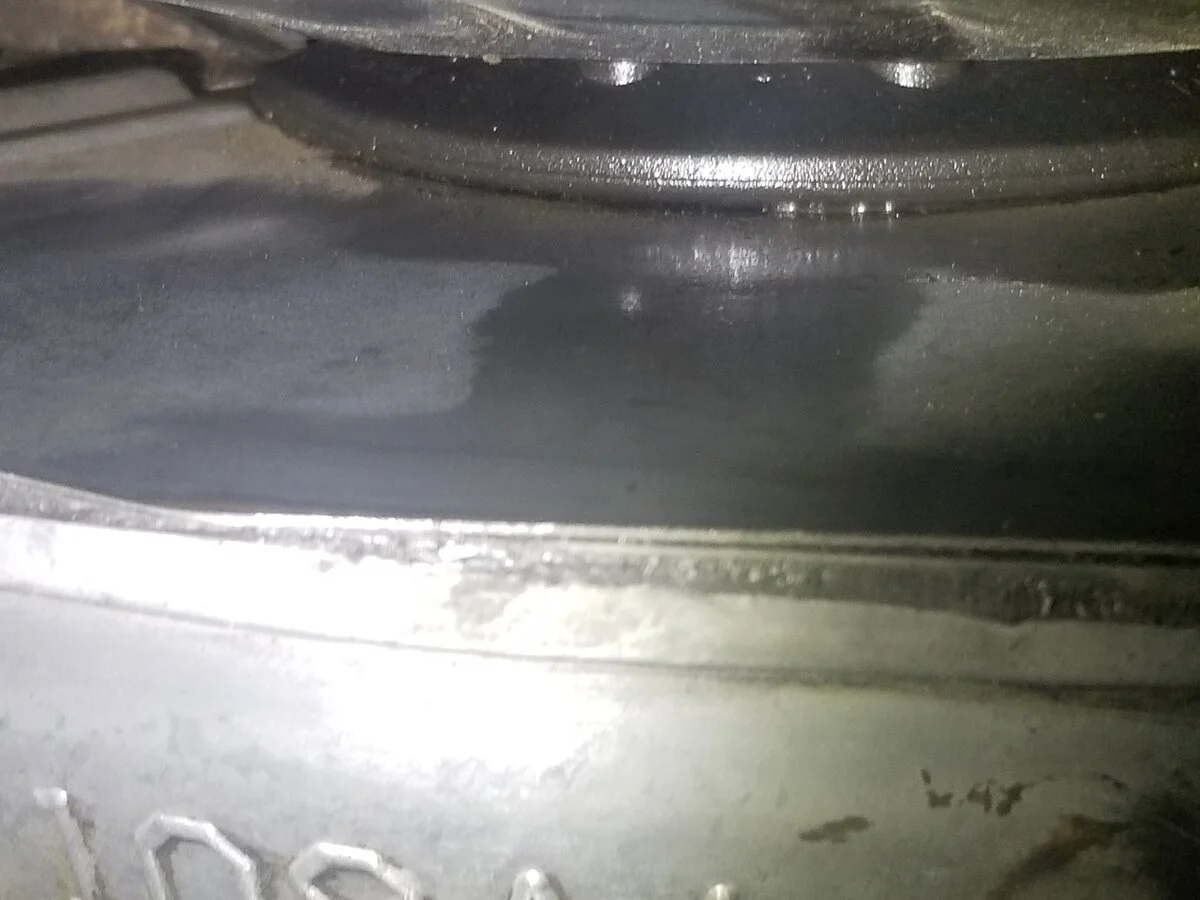

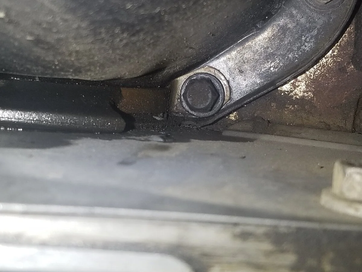

They replaced the rear main seal and the oil pan gasket, not the valve cover, and it is probably the cause of the minor oil leak. I suggest Felpro kit with the bolt seals
The Toyota dealer told me they changed it. But I never asked for paperwork. The valve cover looks brand new on it. So I am hoping it is good to go. I will take a picture, if you don't mind giving me your onion on it.
