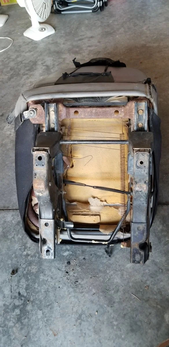

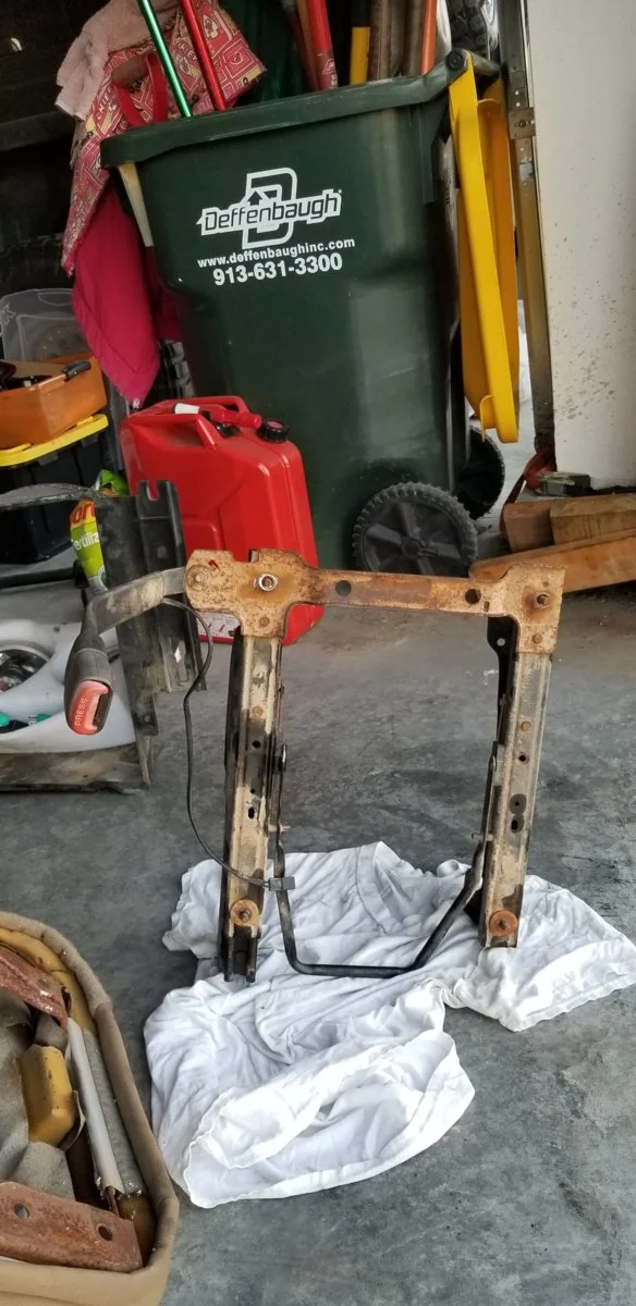

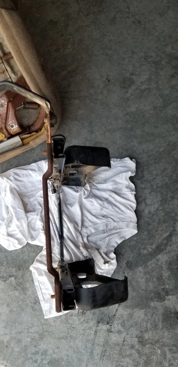

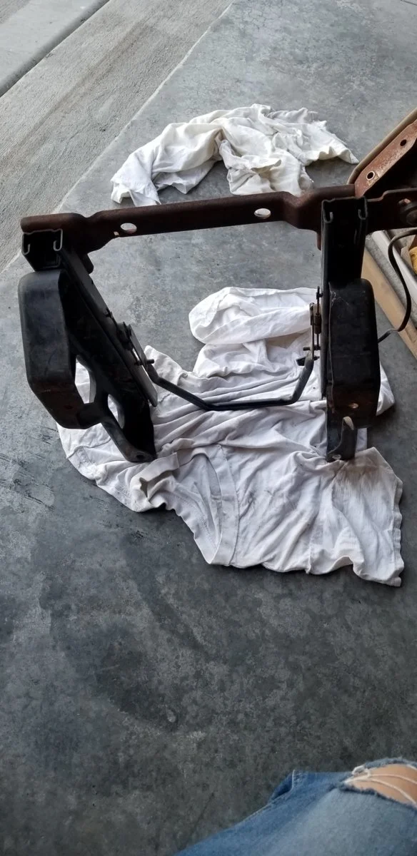

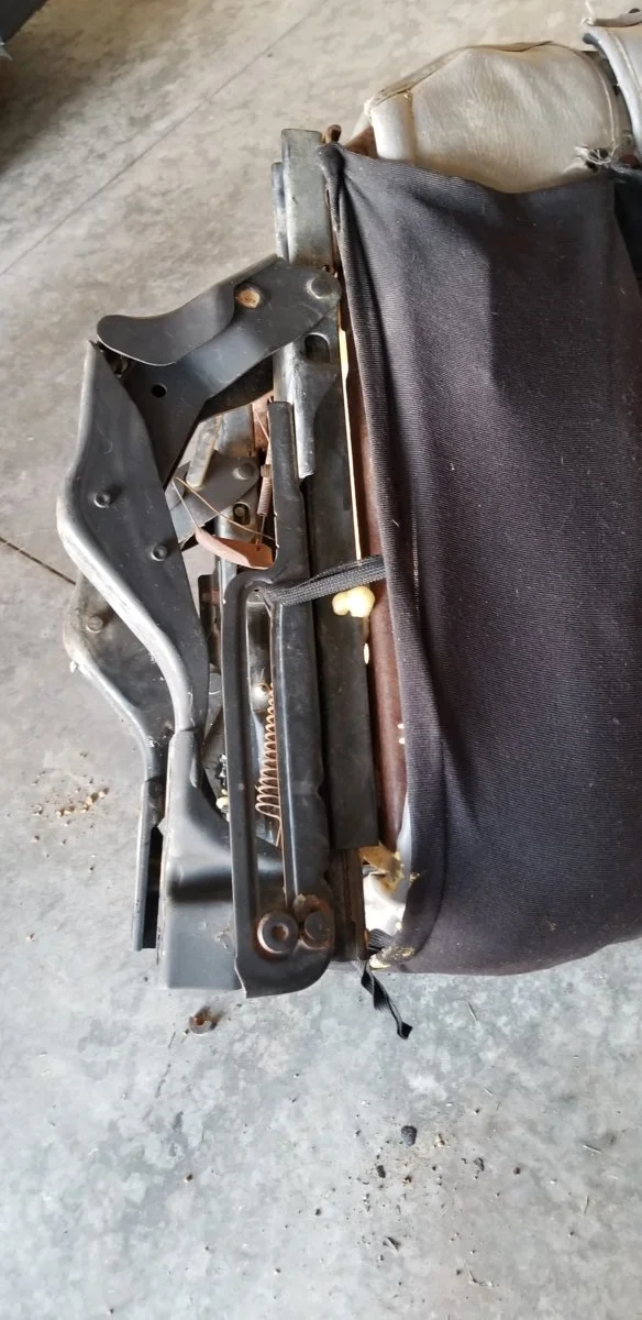

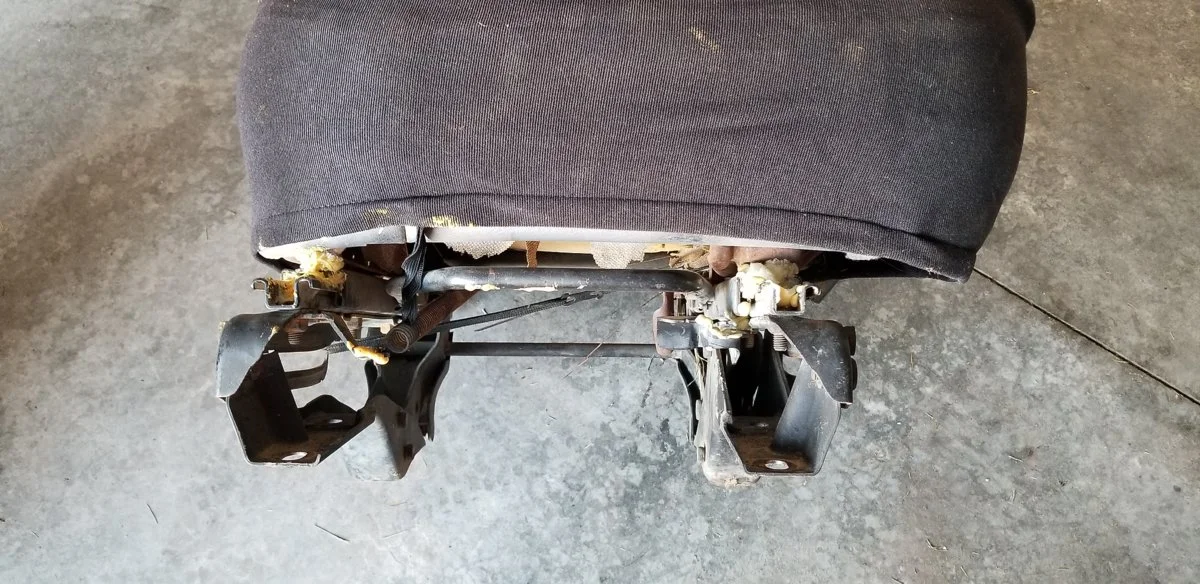

I'm knocking out a seat swap this evening (weekend). Going from the factory SE seats to Sahara, front and rears. The "new" seats didn't come with any mounts or anything. So I've currently unbolted everything from the floor and pulled it all out so I can flip it all upside down to make life easier. I had issues with my old seats adjusting (fore and aft adjustment) as well as the fold/tumble. Now that I have it all out what do I need to lube, adjust, or clear out to make the framing for them to work properly? I'll attach pictures here in a moment so I can have better landmarks or reference point on what needs attention.

First 3 pictures are the driver's frame...
105237
105238
105239
And passenger's side (having trouble getting the frame off the seat)...
105240
105241
105242
As you can probably see the PO put foam in the slider as a stop or something? The passenger's seat likes to fold/tumble when you hit the breaks with any sort of urgency. Occasionally I could get it to lock in when upright, but then being the curious fool I am, I'd fold it again to see what was engaging/disengaging vs before when it flopped around like a white girl on a girl's weekend in Nashville with a bad Uber driver...
