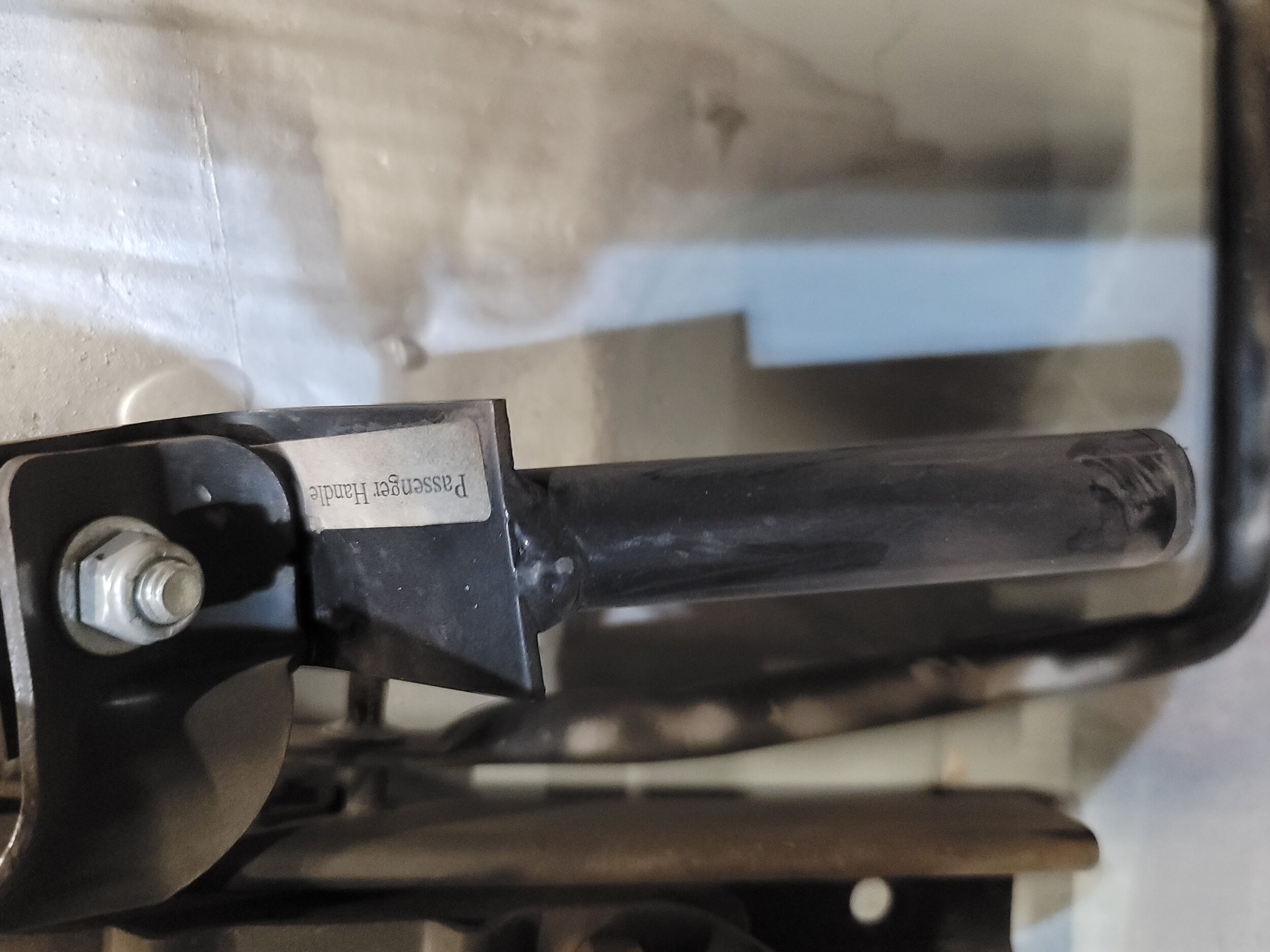

Here is what the extension for the lever looks like. I'll get some pictures of the seat flipped forward later today.
Reactions: mjonesjr84

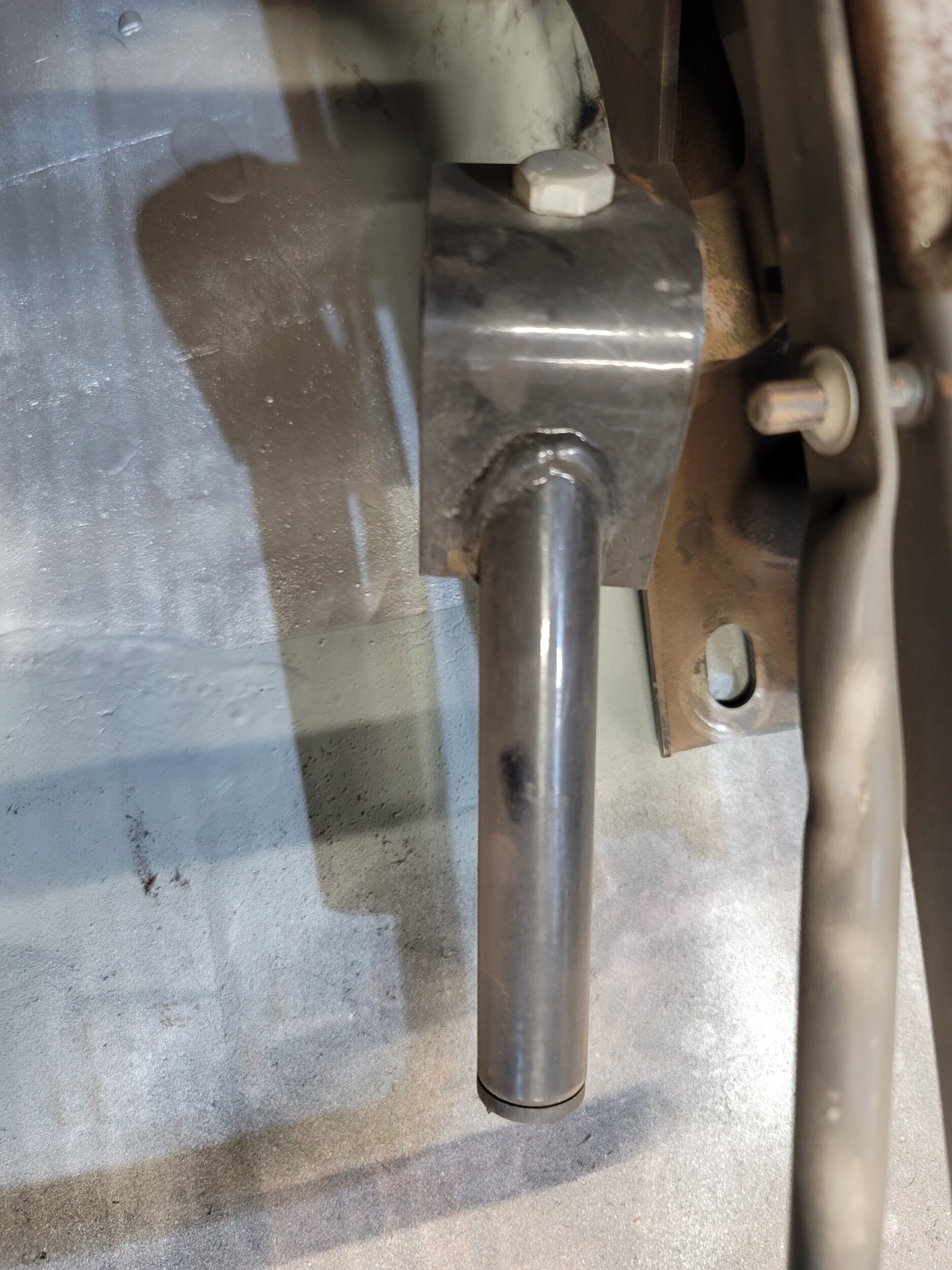

Here's the lever for the flip installed in the Jeep.
You can see it extends forward enough to reach easily.

That helps a ton. I was messing with my seats and I think that will work. I'm going to call and order them Monday.
