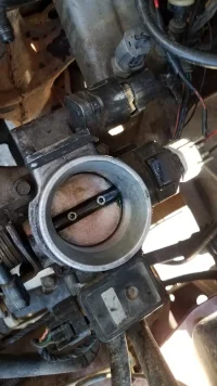

Also, took off the air intake and lots of oil in there as well as the throttle body. Picture is after wiping the small puddle out.
After flush, refilled the system and ran a pressure test, found two leaking areas. I'm pretty sure one is the thermostat body but have no idea what the other one is. It almost looks like some kind of plug blew out, can you guys tell from this video? Intake/exaust Manifold gasket?
