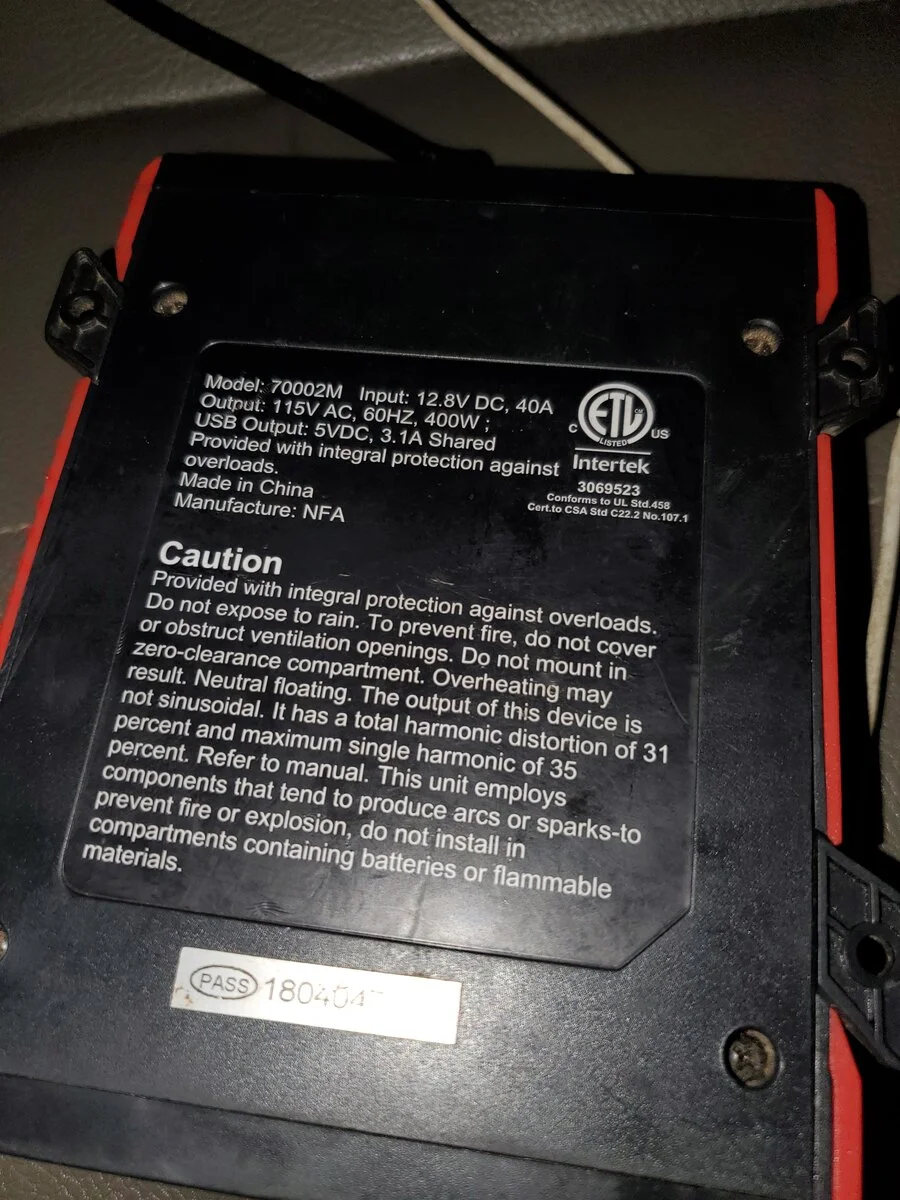

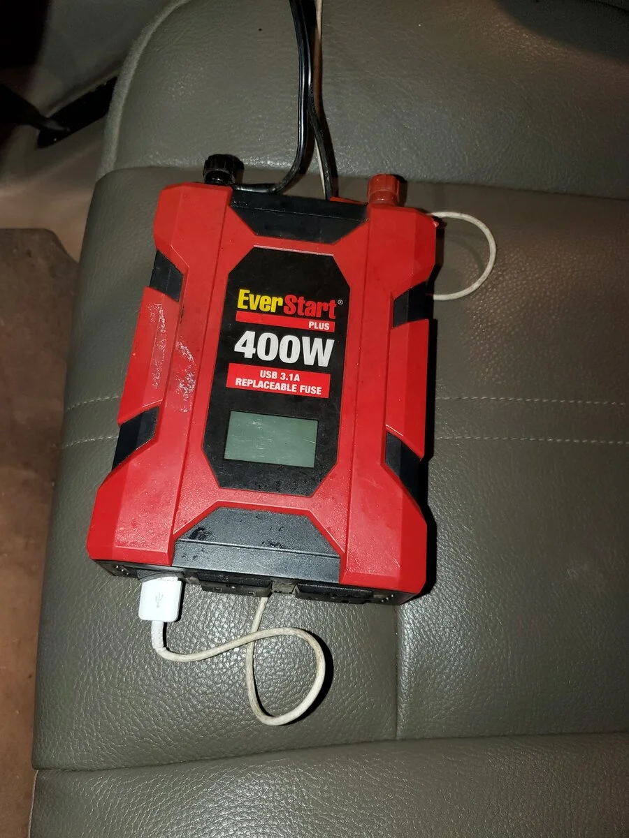

ok heres a good one... so i have a 2004 Rubicon and the 2 12v sockets in front of the gearshift one hot all the time one hot with key on .... the one hot all the time has been removed as the switch for my pillar lights fit perfectly the one hot with the key on has an inverter plugged to charge phones as sometimes there is more than 2 people however sometimes but not all the time the radio has static and I just figures it was the signal or clouds or anything but the inverter. Well tonight while jammin I plug up the inverter and instant static ... unplugged and it went back to clear so I did it about 10 times with the same result ... what gives ...could the inverter be going bad as its a year or two old ... just seams weird
Some inexpensive inverters generate a lot of RF noise and it's cheaper and easier to just replace them with a better model or go to 12 volt chargers. Someone will probably suggest making an RF filter but that's a hit or miss thing that is more trouble than it's worth in this situation. Personally I'd go for pure 12 volt based chargers that don't require an inverter.
The noise is more than likely caused by poor filtering in a cheaply built inverter. IF you want to continue using a inverter; spend the money and purchase a quality one that has good filtering and produces pure sine wave.
