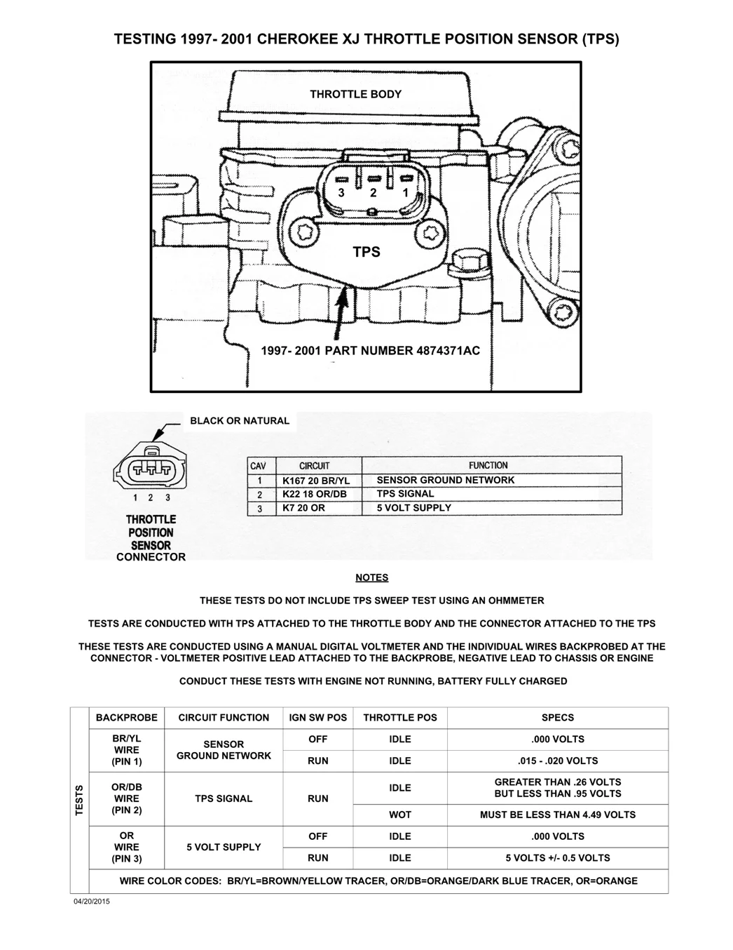

You can test the TPS to see if the output voltage is smoothly increasing to ensure the TPS is working properly.
