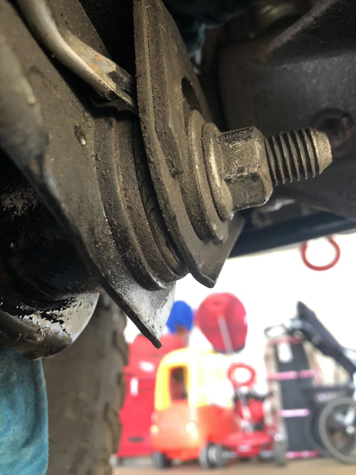

So I got under it today and rechecked torques on trackbar, control arms and other items that may affect it and all is in good order. Did a dry steering test and no odd movements. Now I did notice that my control arm bushings have some weather cracking on them but I’m not sure to what extent this would actually impact it? Or this is simple a tire balance issue.

2. If that didn’t fix then I’d look at the 15+ year old arm rubber bushings.
3. Sounds like you’ve done something similar, if I was doing it I’d just buy nee OEM arms with bushings in, just pulling them from front lower axle side was a workout.
