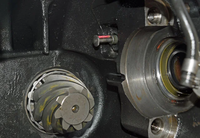

Since your front axle had that issue when you bought the Jeep, here's my guess and theory what is causing the problem. Your ratcheting could be caused by someone having removed the differential (locker) without having properly reinstalled it while the previous owner owned it.
There is a sensor inside the axle housing that gets in the way of the locker actuator if either the differential is removed and replaced without keeping the sensor out of the way until the differential is installed, or the sensor itself was replaced without removing the differential first. Either of those will position the hook tip of the sensor on the wrong side of the locker actuator so it pushes against the actuator which can cause the locker to partially engage which would cause it to either ratchet or lock.
You can test for that by seeing if the sensor can be unscrewed/removed from the housing. If the sensor is properly installed you won't be able to remove it. If it's not installed properly, it will easily come out and then you can secure it up out of the way and go for a test drive to see if the ratcheting sound is gone. The sensor is the only object on the housing that has a cable harness going to it, it just takes a wrench to remove it. It's near the top of the housing so gear lube won't leak out if you remove it for the test.
This is the sensor from the inside of my Dana 44 housing... that red item is a piece of toothpick placed there to hold it fully extended while the differential is reinstalled. That way the tip of the sensor will be positioned on the correct side of the locker actuator. The piece of clear fishing line tied to it is so the toothpick can be pulled out once the differential is back in place.
Reactions: Zorba and gaabbee
