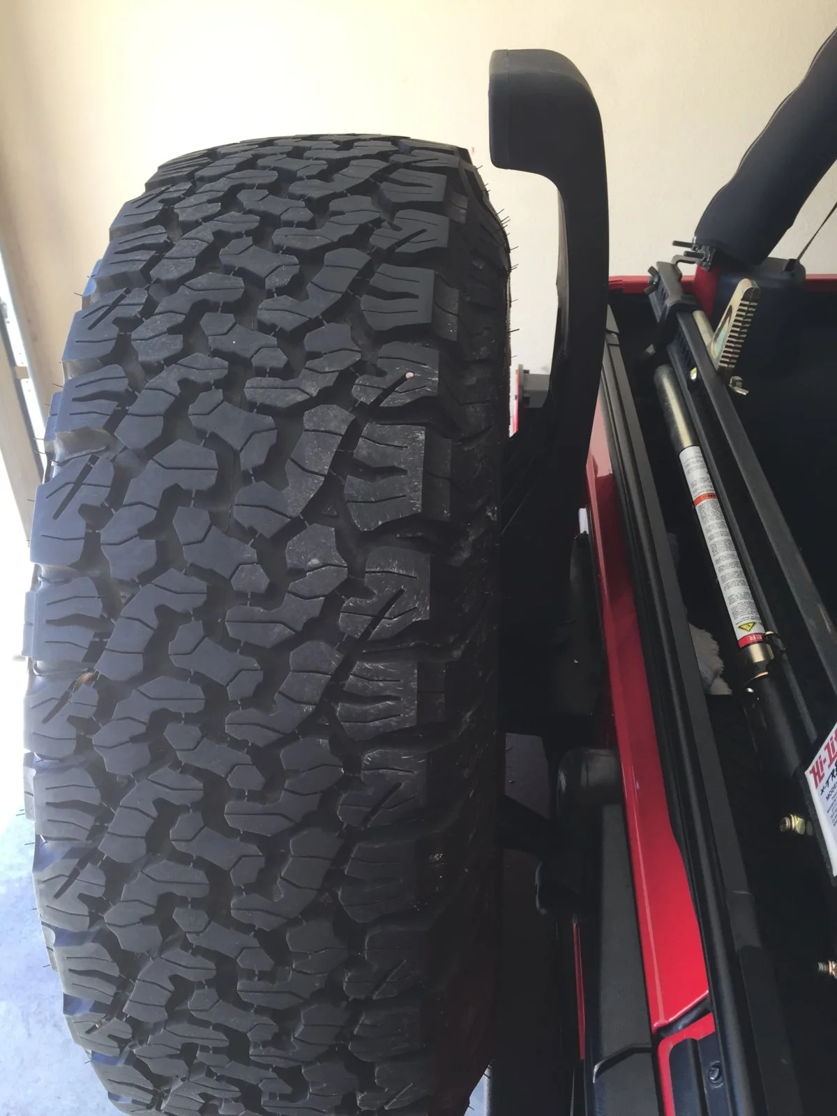

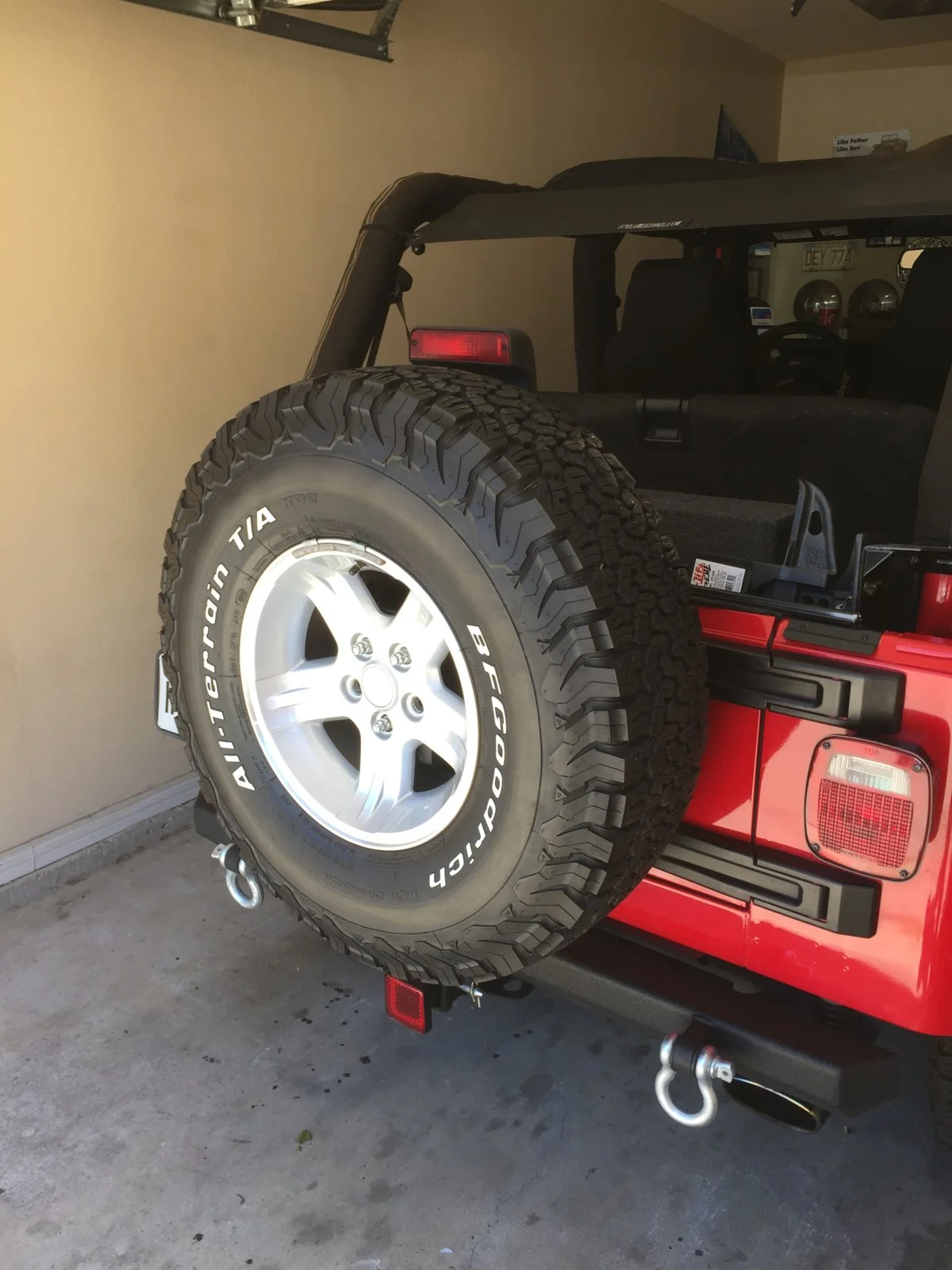

View attachment 15644 View attachment 15645 Also I just added the Teraflex 3rd brake light riser to our Jeep. Easy install and works great. You can see it has more room for a 12.50 if desired. It's adjustable. I just didn't fool around with adjusting it lol.
I'd be careful about your spare mounting setup. Unless the rubber bumpers are snug against your tire, your tailgate will be toast. I've seen it before on the road - a TJ's tailgate literally drooping down as a result of their bigger tire on their tailgate.
Agreed. You really need to space them outwards to make snug contact with the tire. I have seen where guys used pvc pipe with longer bolts. Paint the pipe black and it is hardly noticeable.
That's a good idea! For @Jeepersteve71, another idea: what I did was use hockey pucks as extensions. And even at that, my 33x12.5 tire on a 15x8 steel wheel has caused very slight sagging to my tailgate. Other people have stated that their tailgate has been completely un-affected by a 33" tire on their tailgate, but this is just my personal finding.
