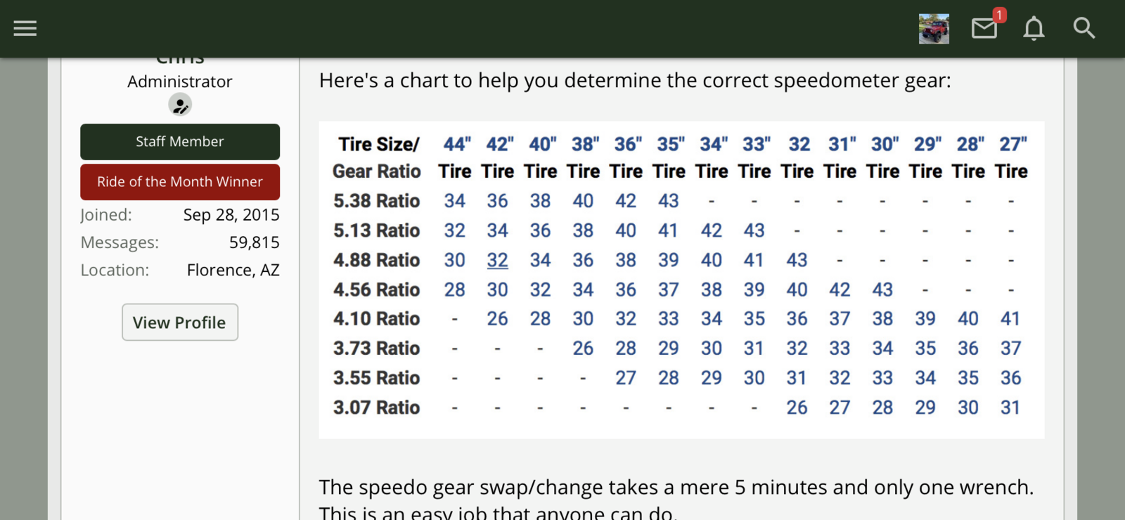

Welcome to the 4.56 club. If you haven’t already done it, you need to change your speedometer drive gear for 4.56 & your tire diameter. It took the 19 tooth gear for my 33” tires. Here’s the chart to help you find what you need.
