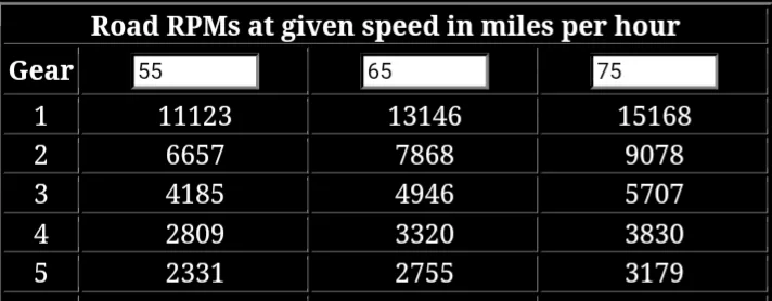

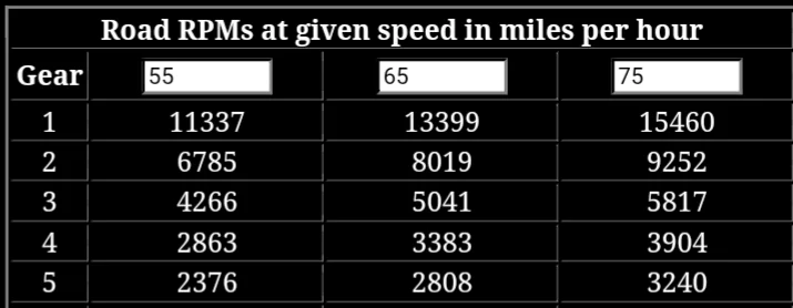

Factory tire size should have been 215/75R15 (26.8), new size is 31x10.5 (29.8”).
My math on the calculator says 70 mph on 4.10 is 2987 rpm. My math on 4.56 with 31’s says 2984 rpm. This makes 4.56 for 31’s almost an exact match for stock in terms of rpm.
4.88 with 31’s will be 3194 rpm. A bit lower than stock, but would have better acceleration than stock and would be a better return on investment for the money spent IMO. Paying all that money to get back to nearly exact stock rpm on larger tires wouldn’t be the best choice in my eyes.
