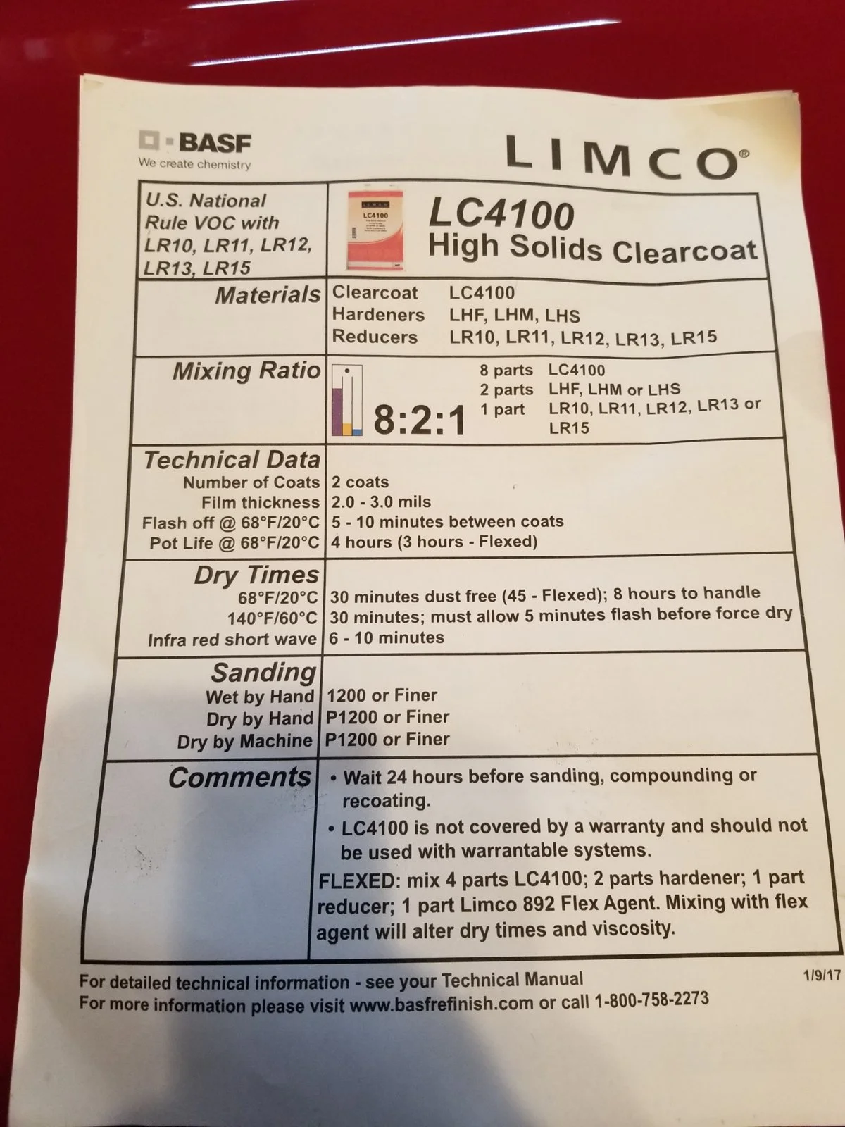

This is why automotive paint has BIG institutions
