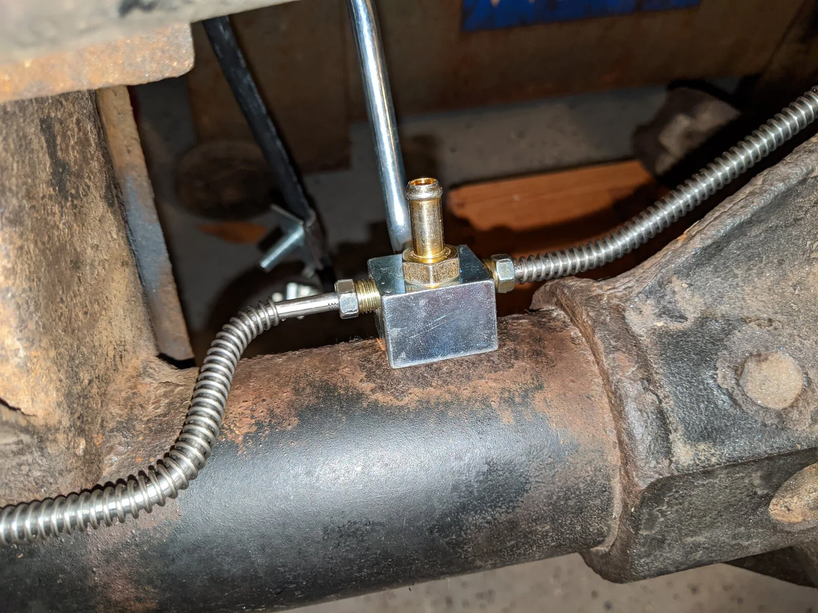

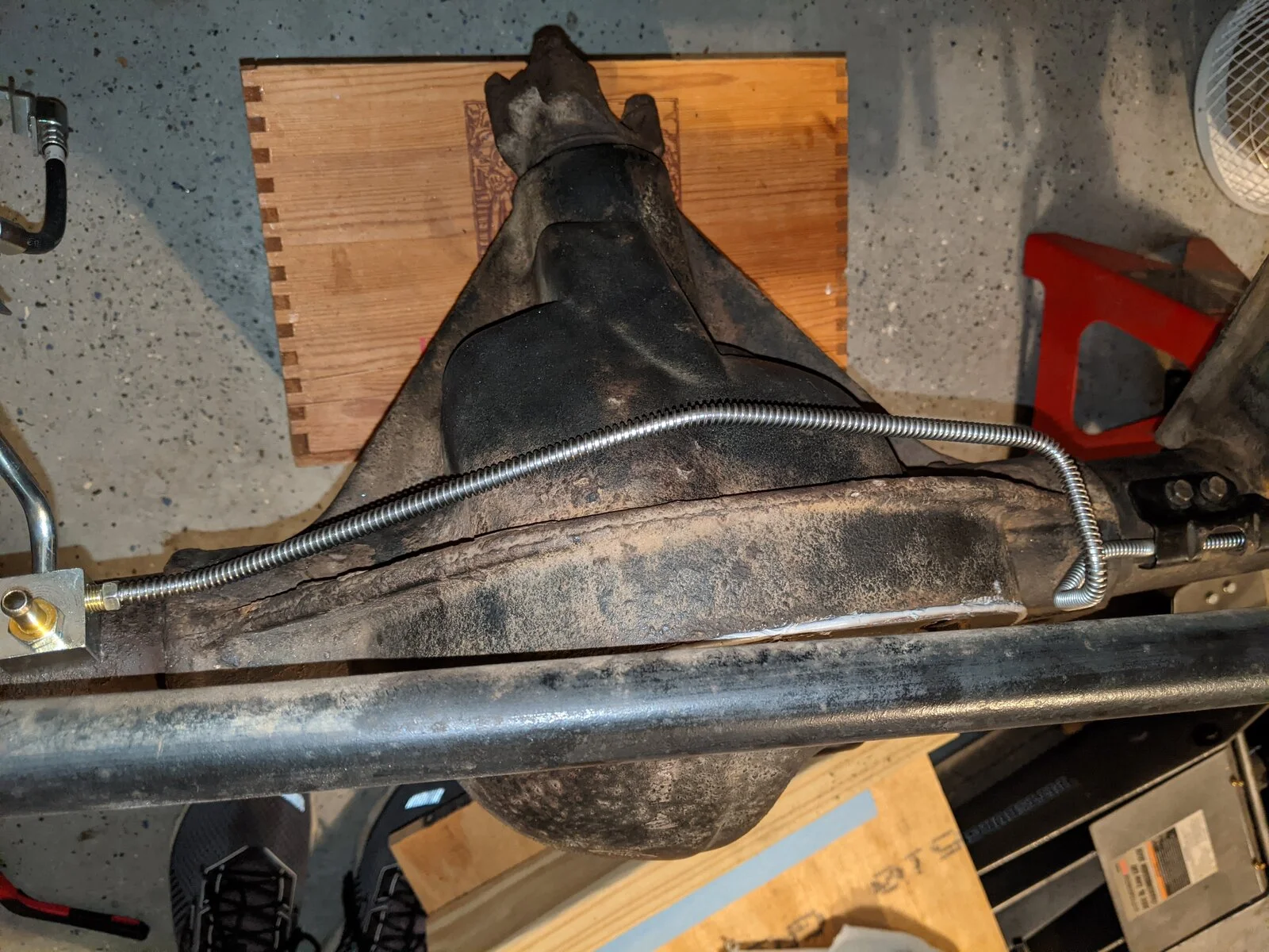

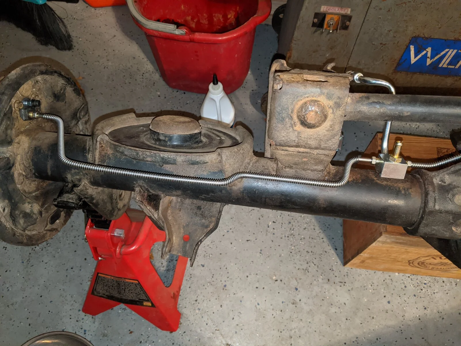

Wanted to follow up on this thread. Finally got around to working on this project. Fitment of the lines is great! Very happy with the way it came out.
Note that I also replaced the center brake line and axle vent bolt, as well as new wheel cylinders
