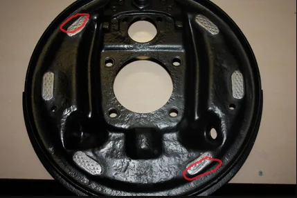

You're saying you have wheel cylinders (drum brakes) and brake pads (disc brakes), which do you have?
I'll assume drums, and that the squeaking happens any time you press and release the pedal. You likely need to clean and lube the pads. (flat areas on the backing plate)
The parking brake is likely just an out-of-adjustment situation.

Drum brakes have "brake shoes", and wheel cylinders. Disc brakes have brake pads and calipers.
After you clean everything out, make sure you re-lube the pads with a good brake grease. I have used wheel bearing grease before, but that's not as good and will need to be cleaned and redone sooner.

Any specific suggestion as to where to grease on the drums? I watched a YouTube video and they suggested the 3 points behind the brake shoes.
Reactions: macleanflood
Yes, look at my first post. In that picture, you see a backing plate with flat pads, two of which are circled in red. Apply the grease there. That's where the brake shoe slides back-and-forth, and is likely where your squeak is coming from.
Make sure your adjuster spins freely while you're in there.
Edit; I should also suggest that you check those stamped pads for flatness. After many miles a grove can be worn in. These pads need to remain flat. If you find a deep grove, the backing plate needs to be replaced.

I cleaned everything off with brake cleaner, and applied grease to the points mentioned in the post above. Seems to have worked (at least going up and down my driveway it didn't squeak).... I don't know much about drum brakes, and I couldn't get the shoe-holding springs off. I was able to use what little movement those springs provided, and get the grease brush in behind the shoes to apply it.
