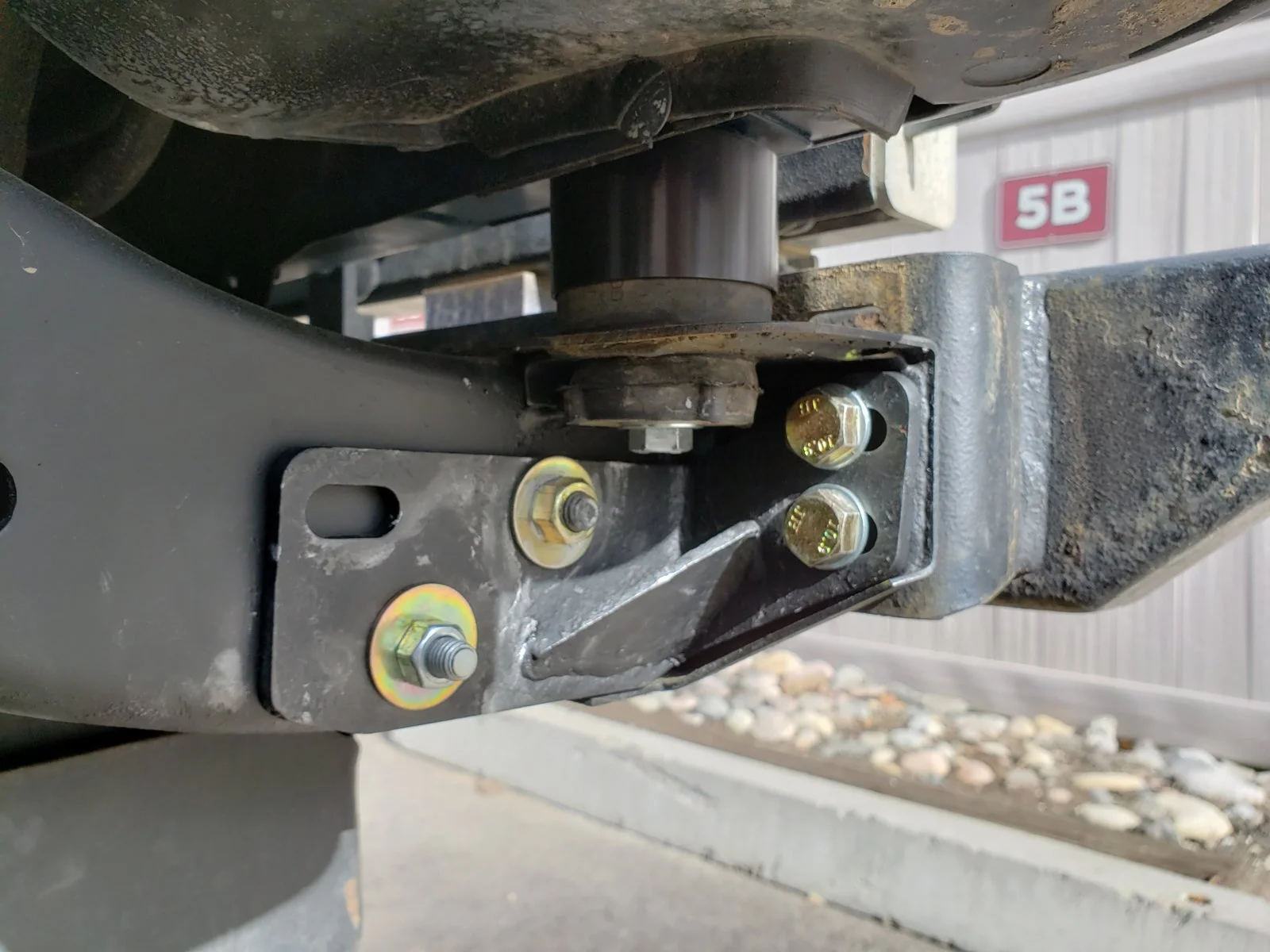

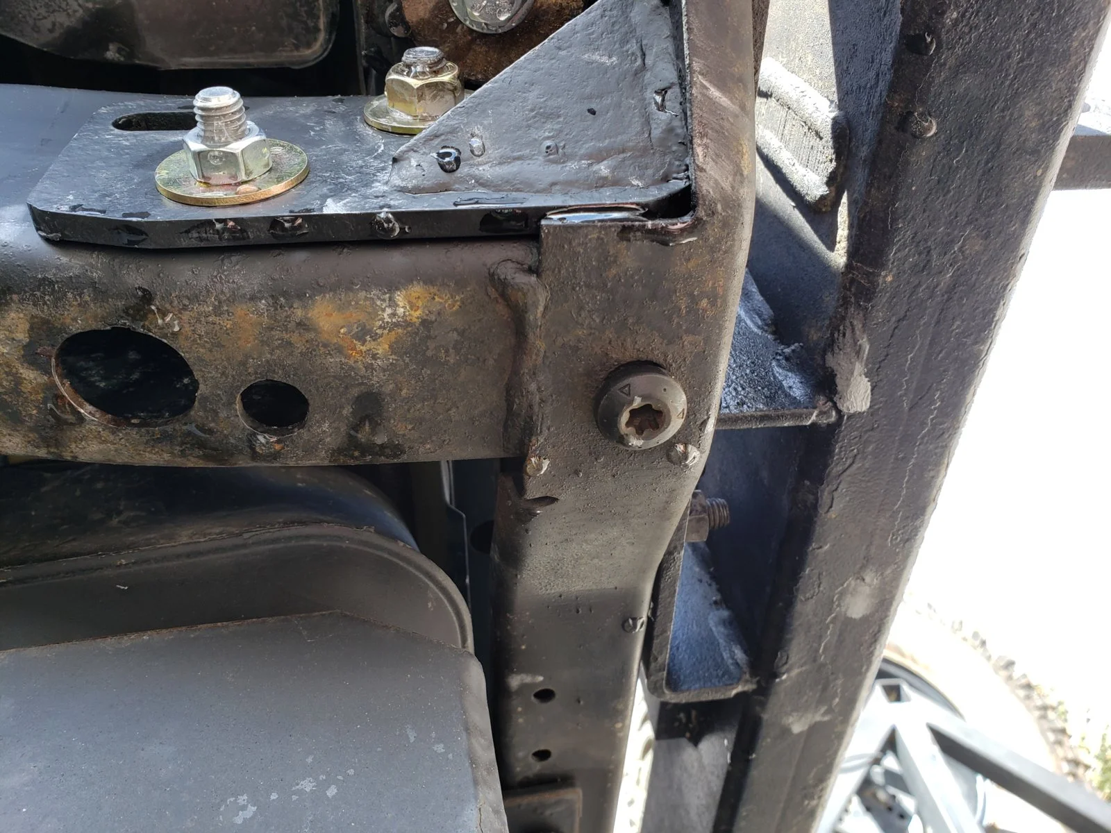

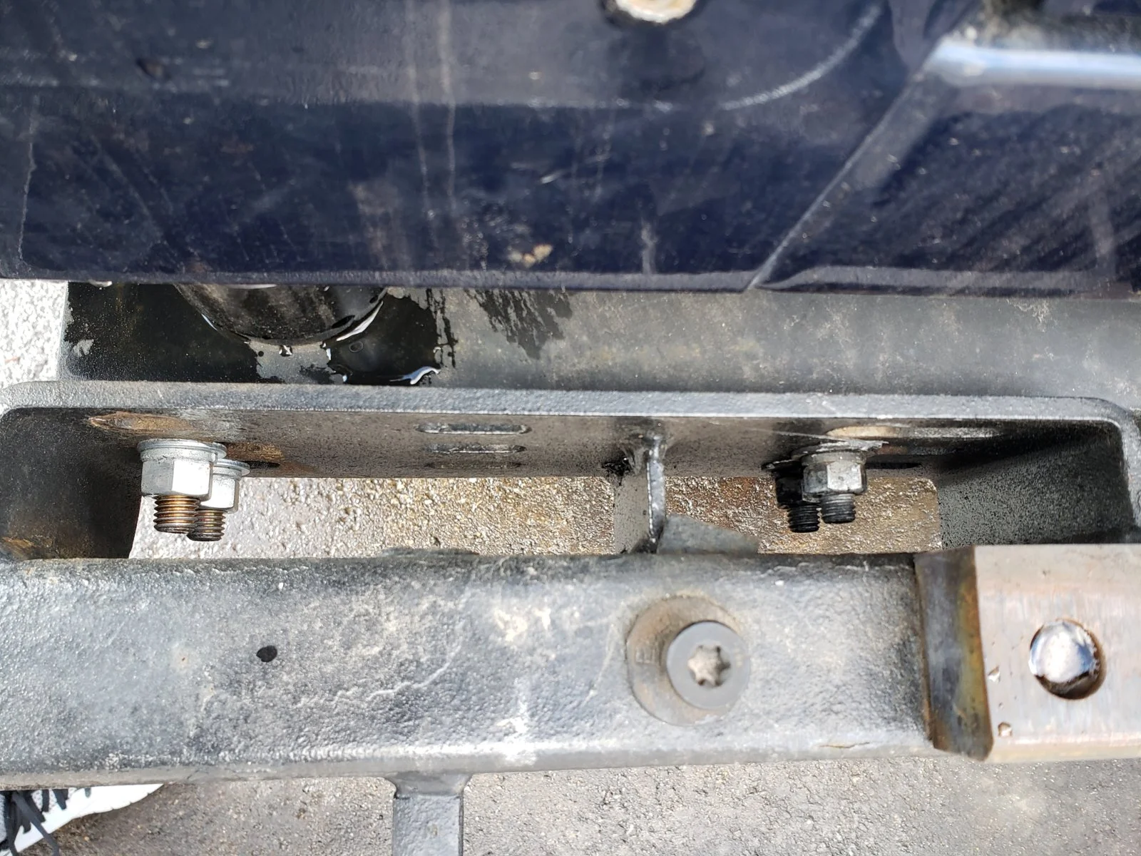

Maybe pics will help but here are all of the mounting bolts for my rear bumper. Maybe he is missing the torx one on the bottom
Oops! I guess I forgot about the other two bottom bolts. (Why isn't there a smilie where I'm banging my head against the wall? It belongs right here.)
Now since those nuts have been knocked out of the way, maybe just some flag nuts with some extension flags added would help.
Reactions: MaloStapalo
