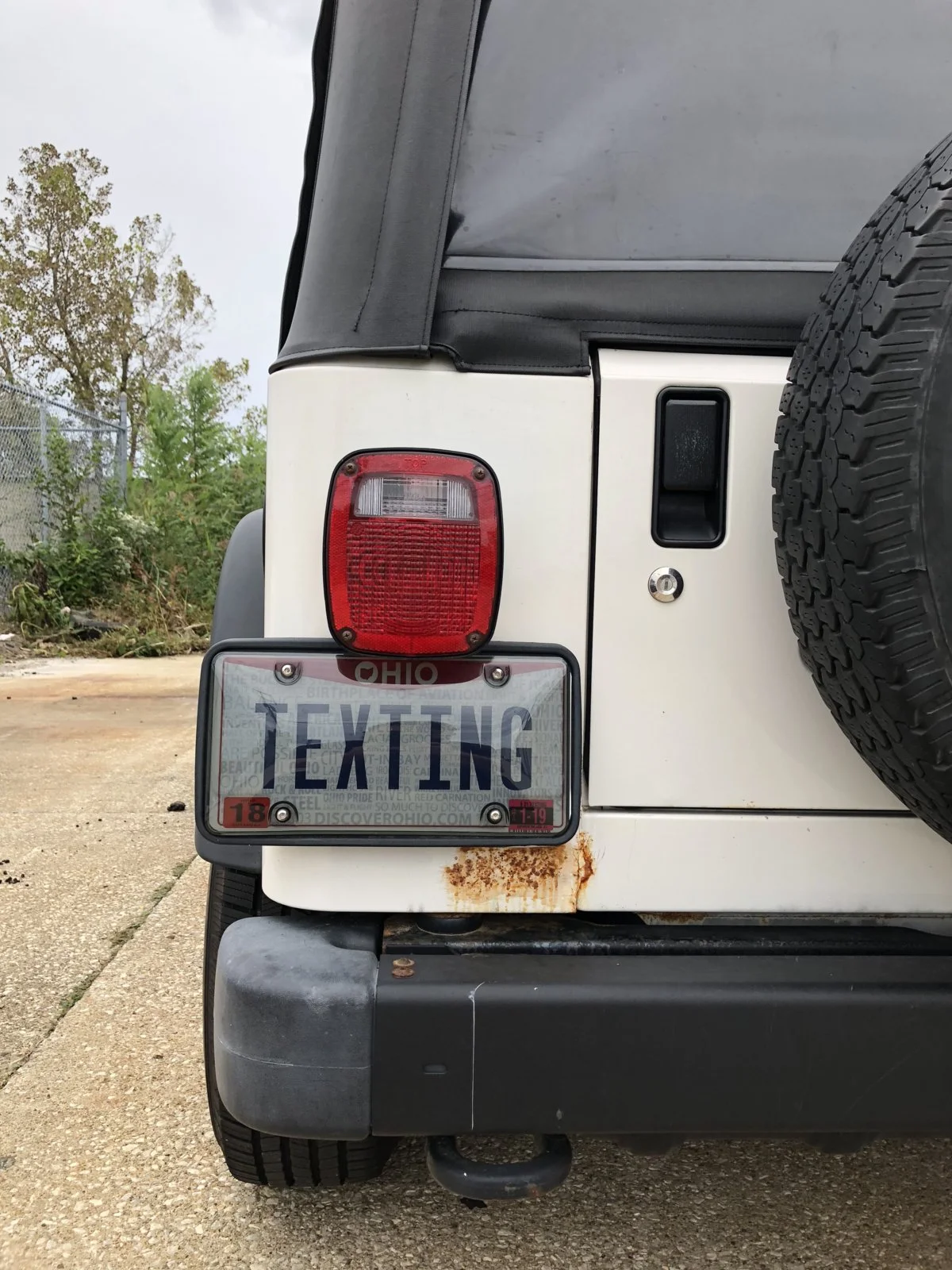

Is this a common issue on TJ's? I got a quote of around $1,500 to repair and fix.
I also saw some places selling oem style rear corner replacements, anyone have any experience buying these?

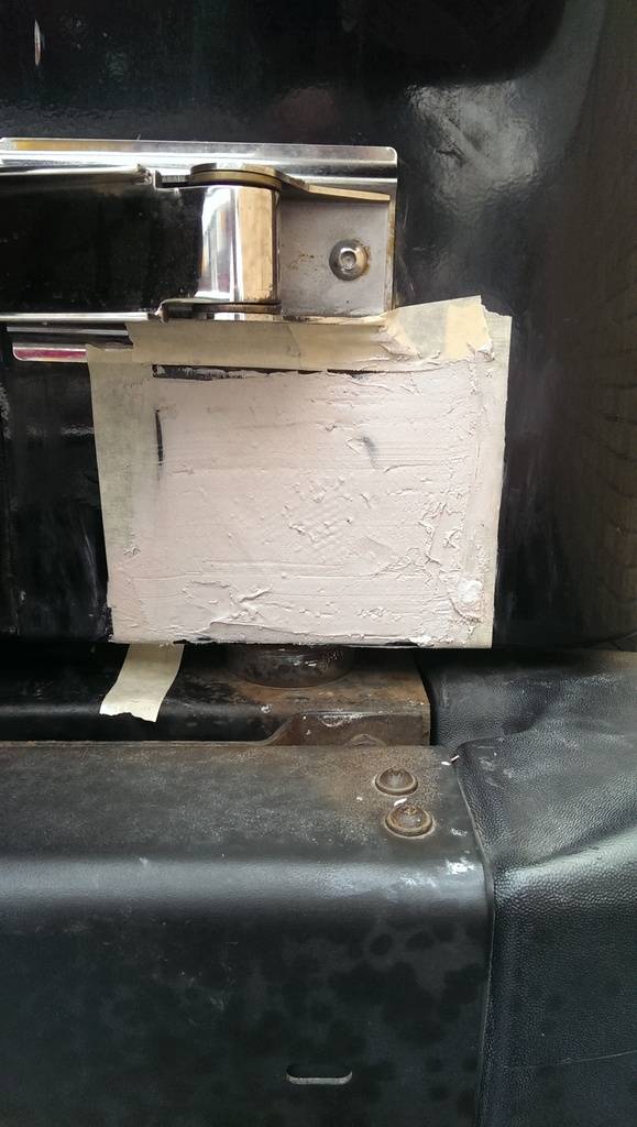

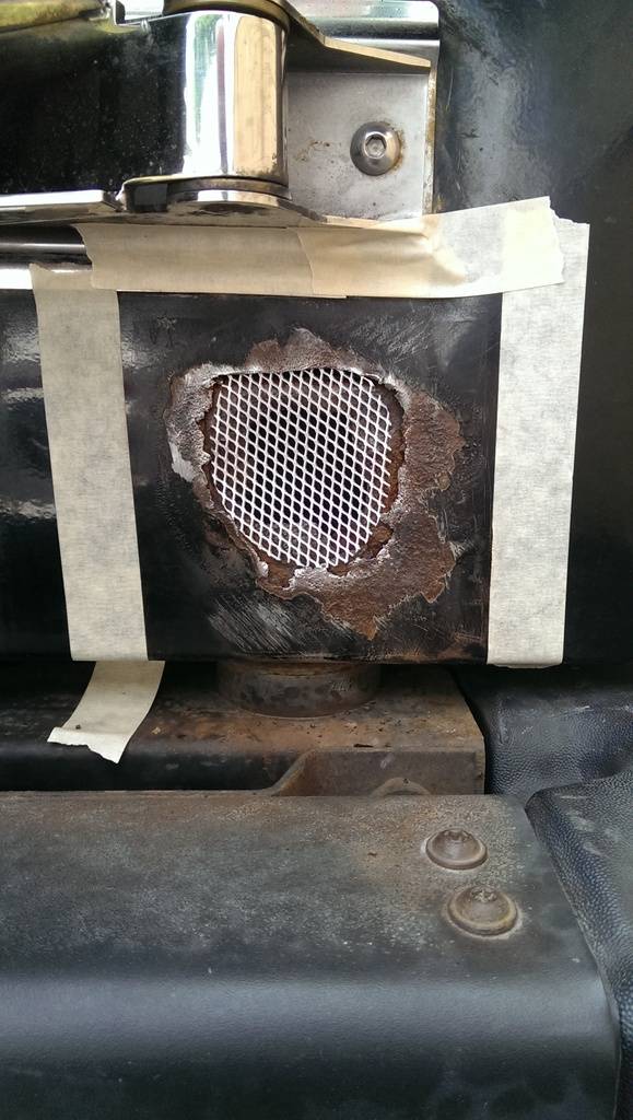

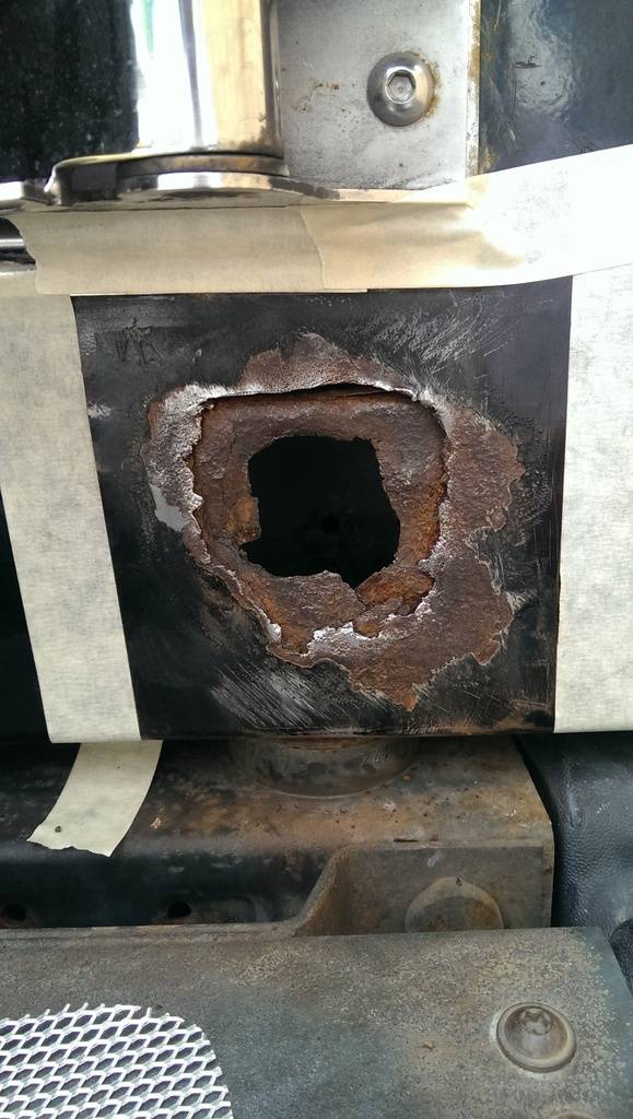

that's a common issue. I had rust on the passenger side and when I started repairing it turned into a hole. Used rust repair kit I found at the local auto parts store, bondo and color matching spray paint from the dealer.
View attachment 55683 View attachment 55684 View attachment 55685
Don't get offended but sorry to comment about your fix, rusts might creep in and push the bondo out and pop your paint like a bubble.... you need to hang out with fellow TJ owners in your area, they will weld a sheet metal for you. Just bribe them with a 6 pack and a little camaraderie gesture like talking about trails or something.
