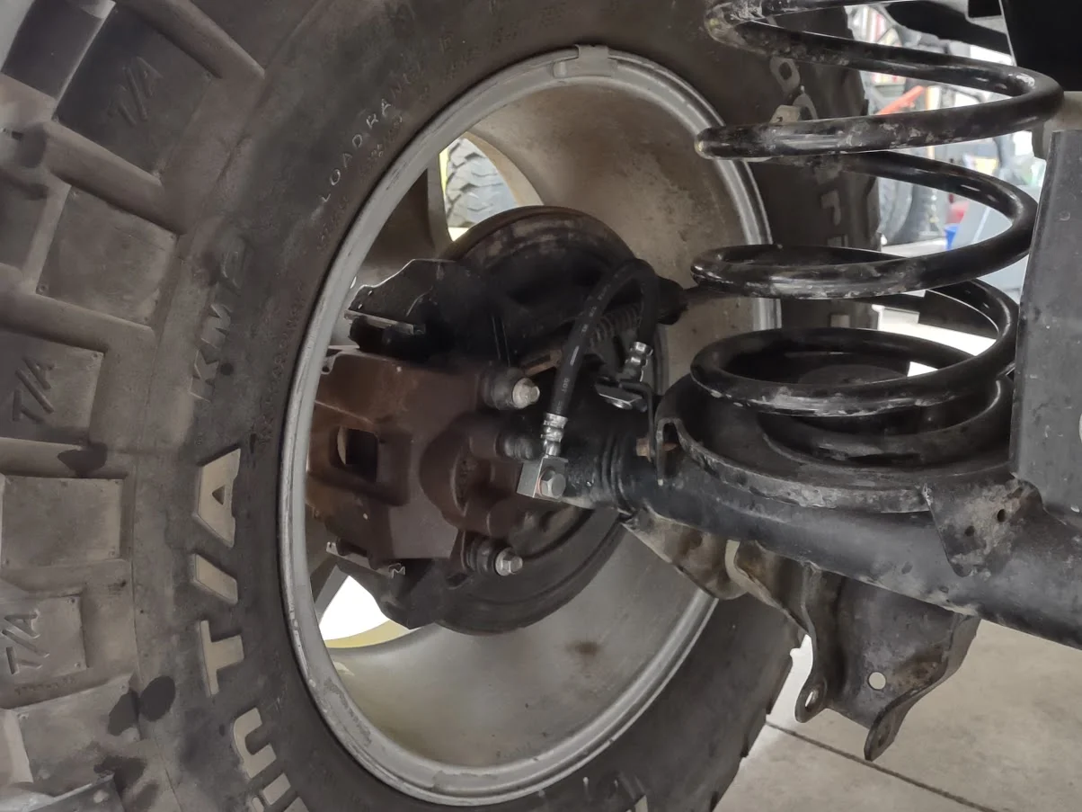

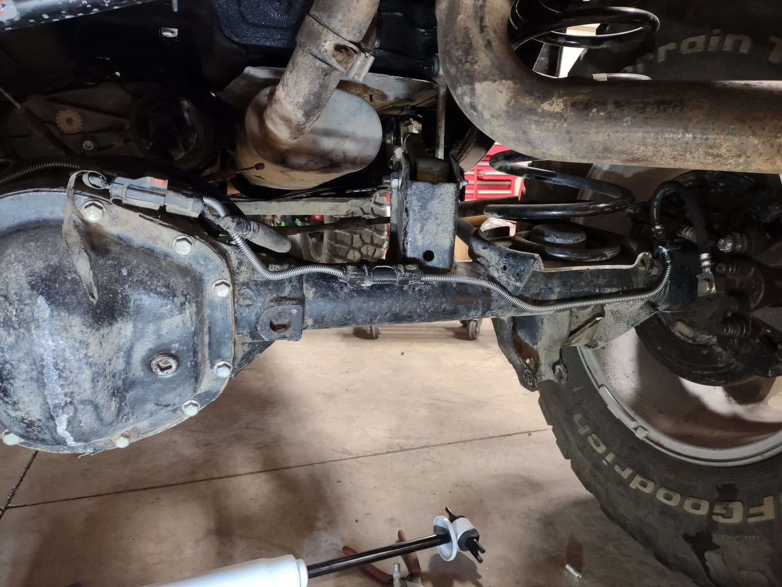

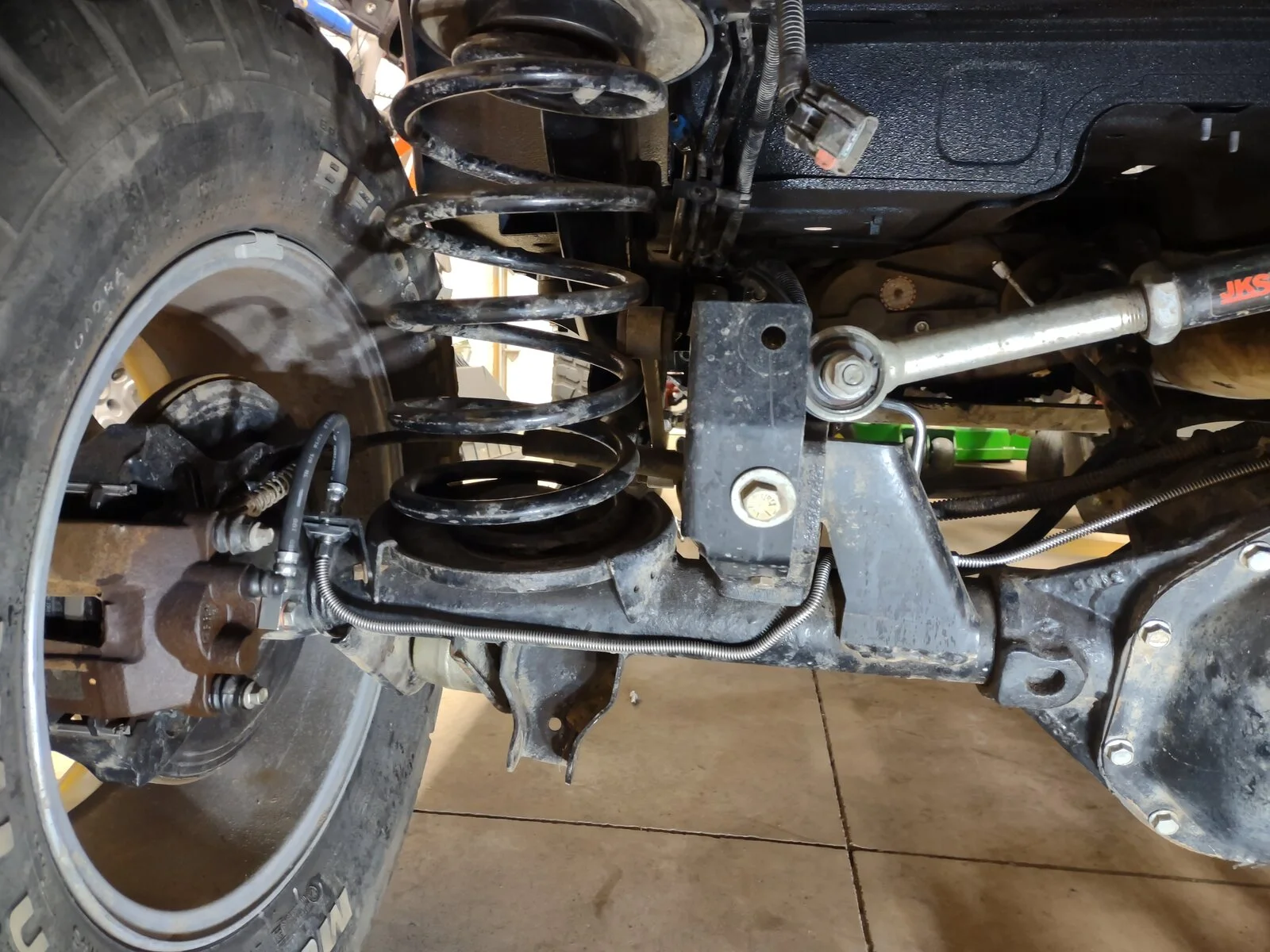

My lines were all stainless and I replaced what spanned the axle with soft metal that can be replaced in less time than it takes to bleed um, with cheap supplies and a small handheld tool.
Protection is key if your playing in rocks and I see no need to fight stainless as evening approaches 3 miles deep if 1 got bashed.

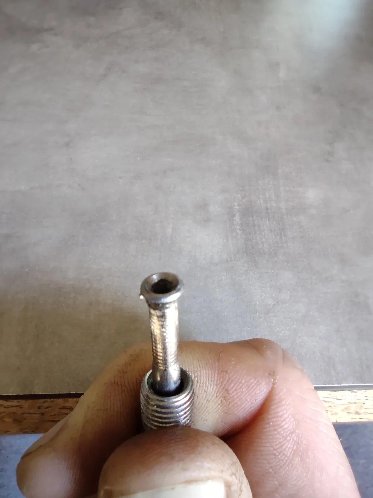

The rear axle lines have so many tight bends right near the fittings, I was afraid that something like the K-tool wouldn't work... The clamp looks like it needs about an inch and a half of straight section, plus the fitting.
I'll probably buy one tho, just to have on hand. I'm sure I'll need to replace the lines on my motor home someday, and no one is going to have a pre-bent kit for that!
Don't buy one until mine gets here and I test it.
@Mike_H / @mrblaine - Did either of you get the K Tool flaring tool and have good luck with it on stainless?
Per the first mention, it says it is the same as the Eastwood stuff, if that is true, it is just okay. I can try another one here in a bit and see if I can figure out what it is doing that it shouldn't be. Or find a way to tweak it to do SS better. I think the biggest issue is our so called annealed tube isn't.
Reactions: sab
Thanks, Mr. Blaine - I appreciate any input. I'm adding cutting brakes to my build list, so I'll have a lot of brake line work to do. I'd prefer stainless line, but I can't find any flaring tool/technique for double-flares with stainless that is noted to be 100% effective. My build list is long, so I have some time to figure it out, fortunately.
Maybe it's work hardening. Is the first flare easier than the second? 304 is quite susceptible to work hardening, so maybe the double flare process is the problem. Along with this, if you're using a tubing cutter, that may work harden it, too. Perhaps cutting with a death wheel would help? Or annealing between flares with a torch? Just spit-balling here - there's got to be a better way.
I always cut stainless with an abrasive wheel and don't get it hot. I've tried the annealing and I either suck at it or this stuff doesn't care. Neither flare cares, they are both difficult. I'll work on it though.
