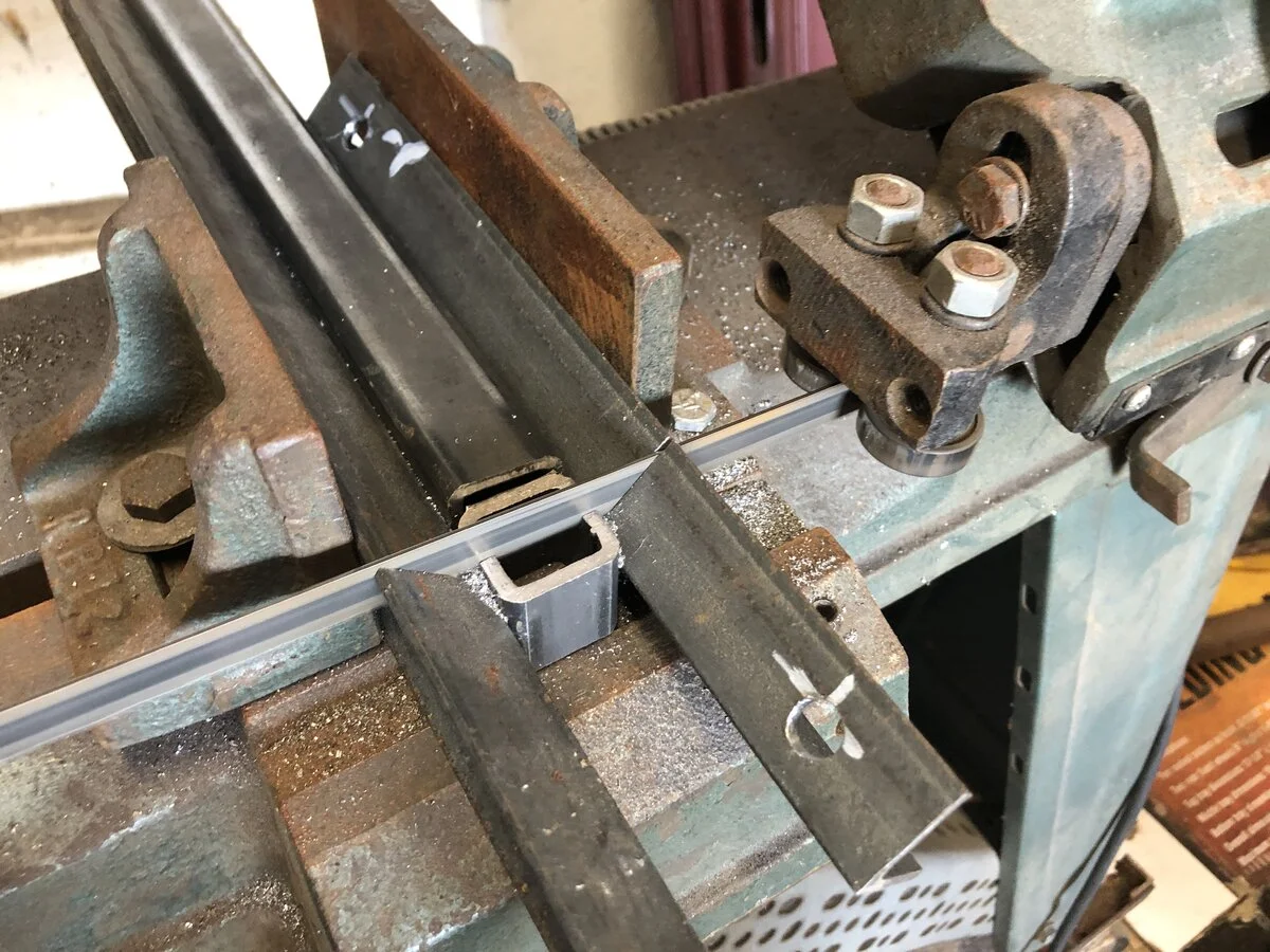

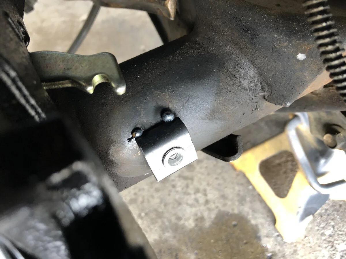

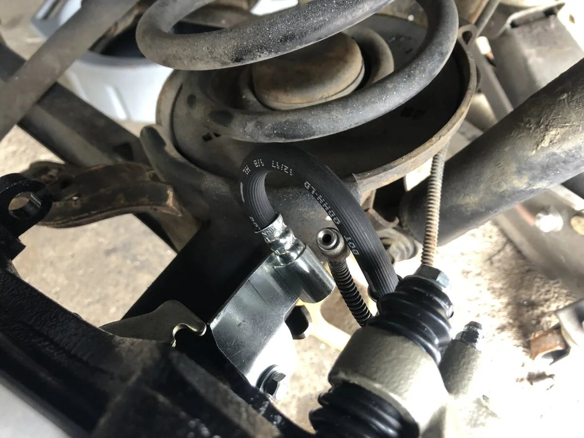

I ended up going the route of cutting a re-flaring. I made some mounts out of square tubing and rivot nuts, welded to the axle tube and bolted on. Dont judge me on my welds. They hold and thats what matters right now. When ever I get the whole axle out this winter I will just go over with the tig and “pretty” them up.
I did not flare them yet since I realized I sucked at bending and flaring that day since I tried to fix a brake line on a lifted Fiero I got. So I am just getting food for my mechanic buddy to do them for me instead with new lone. But got one side kind of where it needs to go, just did not have enough on the end to flare with the fitting.
