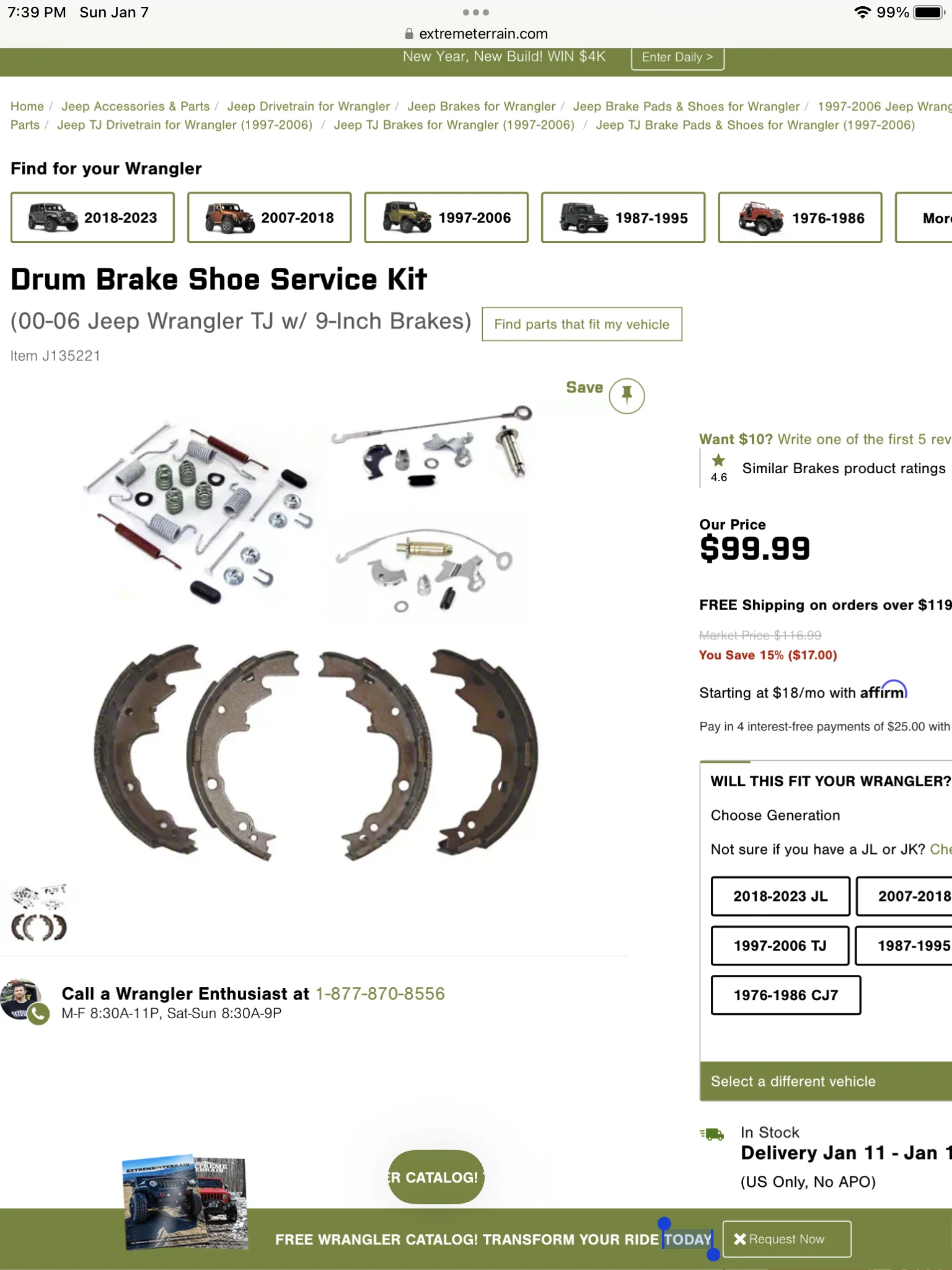

Here are most of the parts you need. The shoes, drums, standard hardware kit, ( springs on left) and self adjuster kit or kits ( left and right) don’t know if they are separate by side. Adjusters are left and right specific. The parts not shown in this picture the lever and equalizer bar for the parking brake and the park brake cable. You will need to verify what size backing plate to get the right parts.

The parking brake lever is a big deal breaker, they do not exist in the aftermarket and hard to find used. I gave away my last couple of sets years ago.
