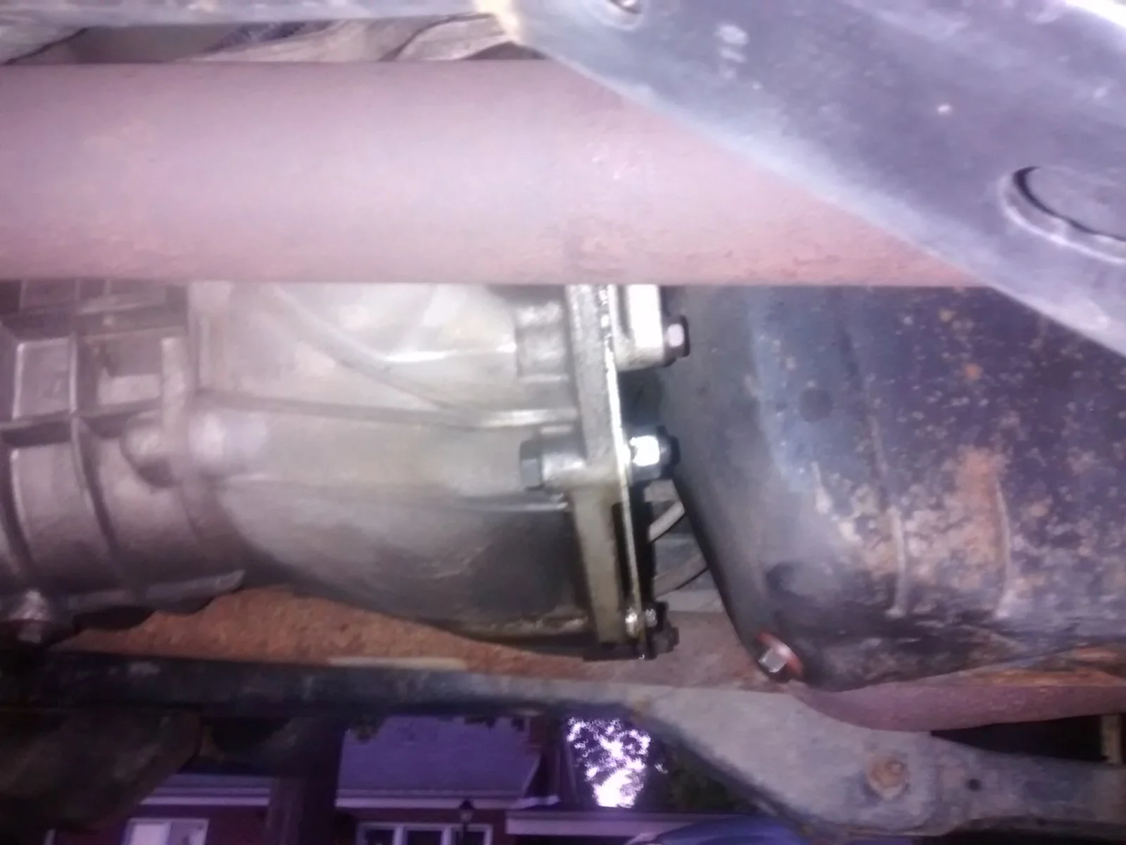

is this what this is? looking at the photo (looking under jeep from passenger side) to the left of the oil pan is a drip of what looks like oil at the bottom of the transmission? I think that is the transmission but not sure.
the drip is hard to see on this photo but its there and there is about a 2 inch diameter spot on road below the drip.
its dripping where it looks like that plate is bolted to the transmission. fluid is not red/pink but looks like oil to me but I also dont know the condition of my transmission fluid (color wise).
i have 161k miles on the jeep, 5 speed. any idea what this leak is and if it is a RMS leak, would high mileage oil help? thats what I have in it now, mobil 1 high mileage. thanks
Definitely your rear main seal, I'd bet on it. Very common on these 4.0 engines, but also not to difficult to fix.
High mileage oil won't help any unfortunately. Your best bet is to just fix it.

back to my RMS. I never noticed it leaking before until I put in mobil 1 high mileage in it about 1k miles ago but I only had the jeep for about 1k miles so could be coincidence. I still have enough mobil 1 to do another oil change so will use that up and maybe consider trying something else if cheaper.
Yes, I agree, it's very, very hard to find reputable mechanic shops. This is why so many mechanics have a bad reputation. Most of them will charge you for the stupidest little thing, and even if they don't find something wrong, they'll still "fix" something as you mentioned. It's nice to have a good mechanic that you can trust.
The Mobile 1 high mileage must just be a coincidence. The 4.0 simply has a bad rear main seal design. I've seen them leaking with as low as 50k miles on them. Like I said though, it's fortunate that it isn't like most engines, which would require dropping the transmission to access the rear main seal. I'd say that kind of makes up for the crappy design!

You don't have to drop the trans but you do have to get the exhaust crossover head pipe from the manifold to the cat off and out of the way. Depending on condition, that may not be easy. I've had to cut some in front of the oil pan and weld them back together because that was easier than anything else.
After that it is just basis R&R until you get to the RMS and if you don't know how to cut the shoe out of a plastic water bottle, you can cut part of the outer edge off which may cause a leak.
The biggest issue with RMS repairs is there is nothing you can do better to ensure that they won't leak. Myself and a few others in the area that can be convinced to do them for folks will not guarantee they won't leak right away after doing one. I've never had one leak in short order but there is nothing I can do to make sure of that, so I make no promises.
If that rig in question were mine, I would get the Mobil 1 out of it right away, swap in some dino and see what happens. Certainly cheaper than paying someone to do a rear main when it may not be needed.
Also worth a minute to take a peak at your valve cover as a leak from there can and will look very much the same as a leaking RMS.

FYI, I had a small oil leak like you describe on a previously owned 2003 TJ w/160k+ miles. The shop I took it to replaced the valve cover gasket first, then I drove it for a while...turned out it still leaked, so RMS was next. That seemed to take care of the leak, although I talked to the new owner and the small leak might be back.

ok, I am not so sure its the RMS now. I was lookt at back of valve cover and there is some really black dirty thick oil gunk back there. the back rear bolt on passenger side was not very tight so I snugged it down, some others were not really tight either so snugged them down a bit (no torque wrench).
sprayed some degreaser all around and let it drip down (with the degreaser,its dripping at bottom exactly where it was dripping before) so I think it may be the valve cover areas/gasket that may be the source of leak.
