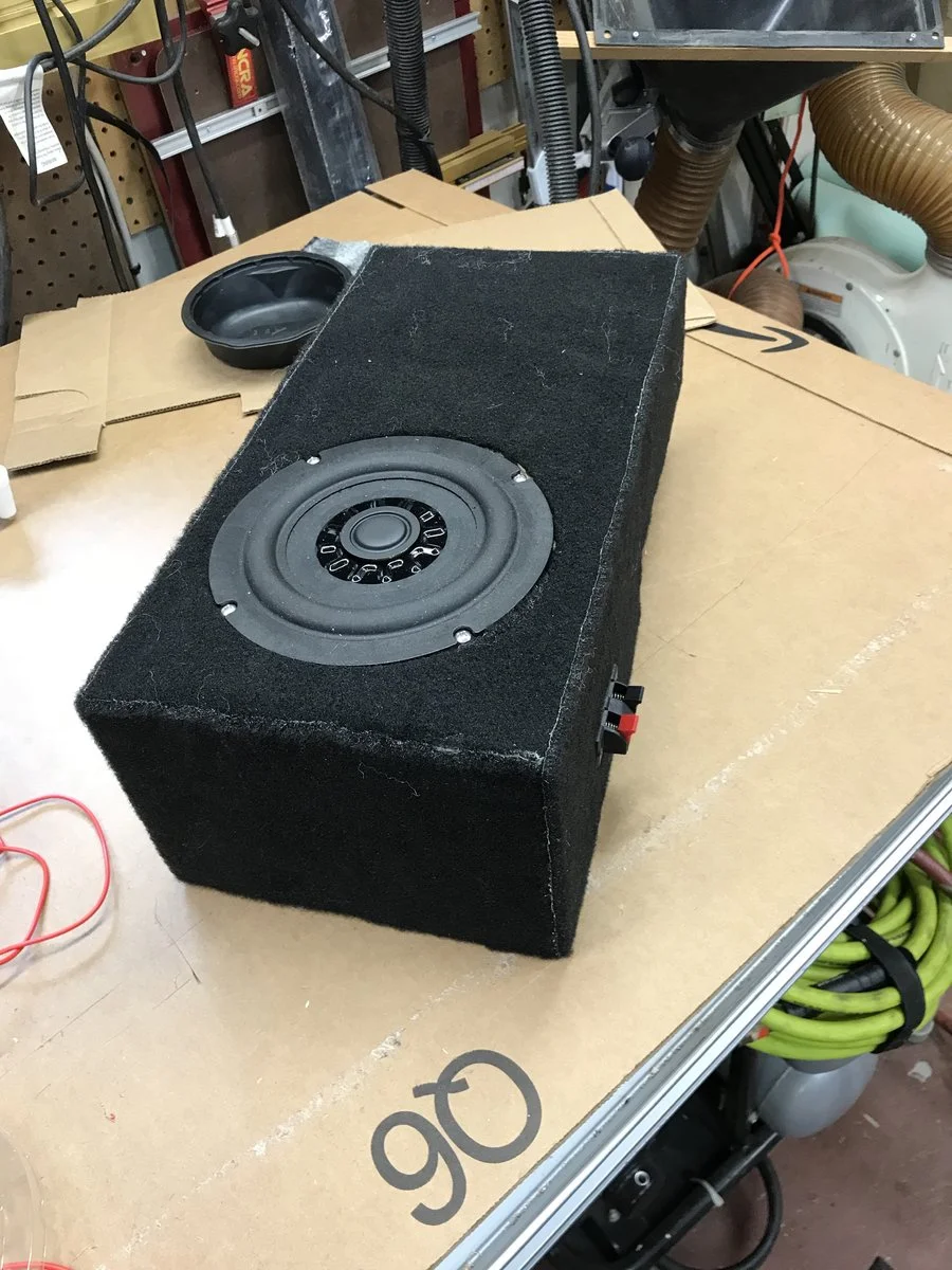

Jeeps are about worst environment to get any kind of good sound, it's difficult. It's possible to improve it but getting a great sound system is almost impossible. Stay away from "bigger is better", a 6x9 isn't necessarily better than a good 5.25" speaker. A lot here use the Polk Audio DB speakers in their overhead sound bar, they are very efficient and spread the sound out fairly well. NONE of the stock locations in the dash or overhead or pods will provide any bass. Only a purpose built box carefully matched to a small woofer will provide bass. I built a small box for a small subwoofer designed for a small box and placed it under the driver seat, which is raised. It works well. There are other solutions such a box behind the back seat. Subwoofer need an external amp to work properly.
