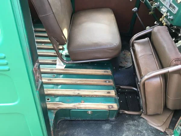

A single, removable rear seat is not a new idea. Several guys in my jeep club used single seats in their CJ's so that a passenger could ride in the back with room along side for a cooler. I still have a folding passenger seat from an early Willys wagon that I will modify "when I get around to it" so that I can use it in place of the factory rear seat in my LJ
Willys wagon folding passenger seat:
