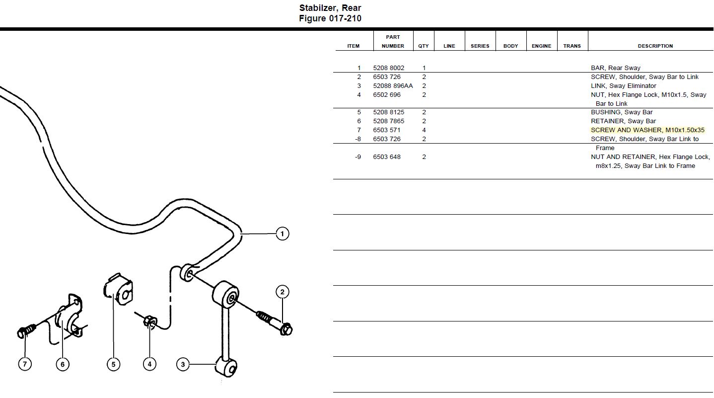

Bought a used rear sway bar because my TJR didn’t come with one from the PO. Thought I was buying one that came with hardware but guess not.

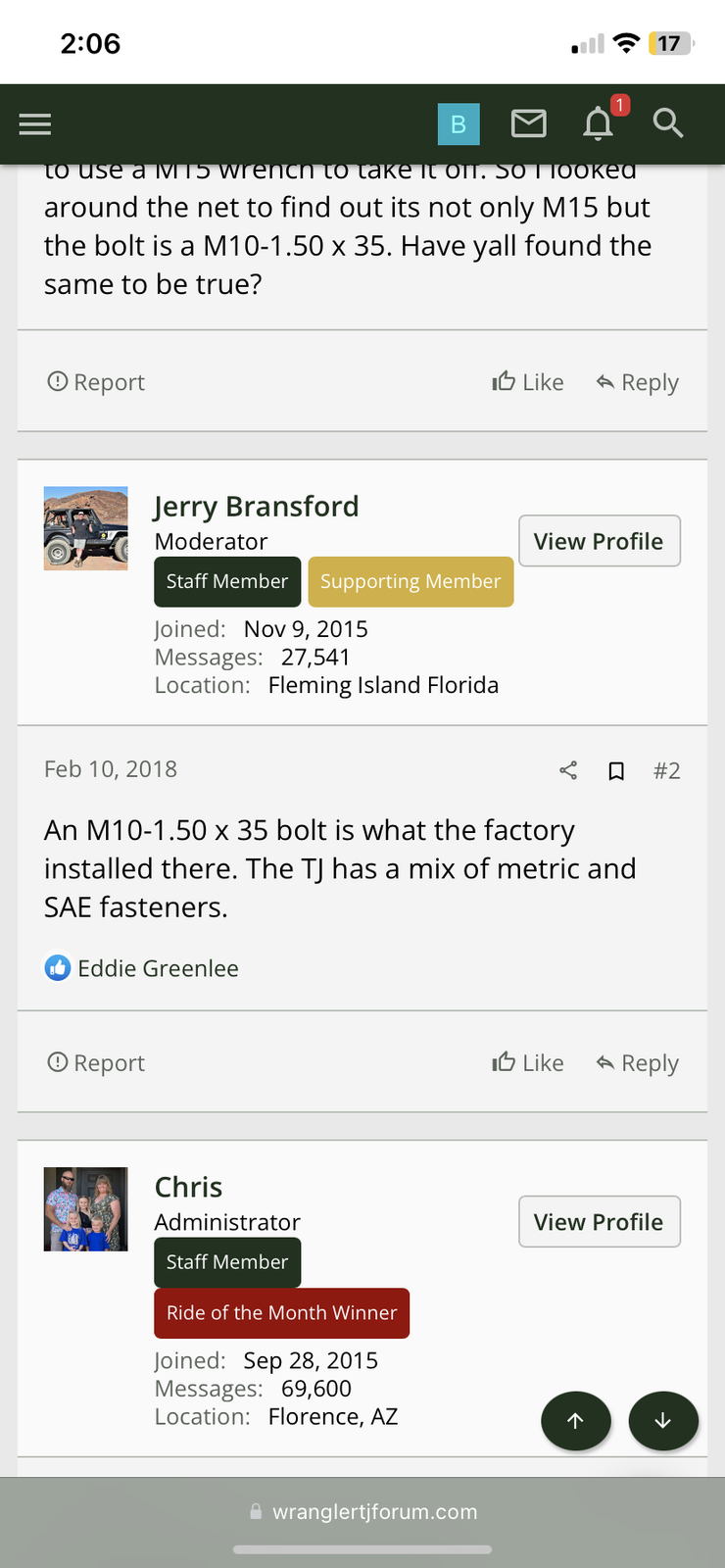

I found this post by Jerry for but missing info on the bolt to the frame https://wranglertjforum.com/threads/tj-rear-sway-bar-bracket-mounting-bolt.8986/

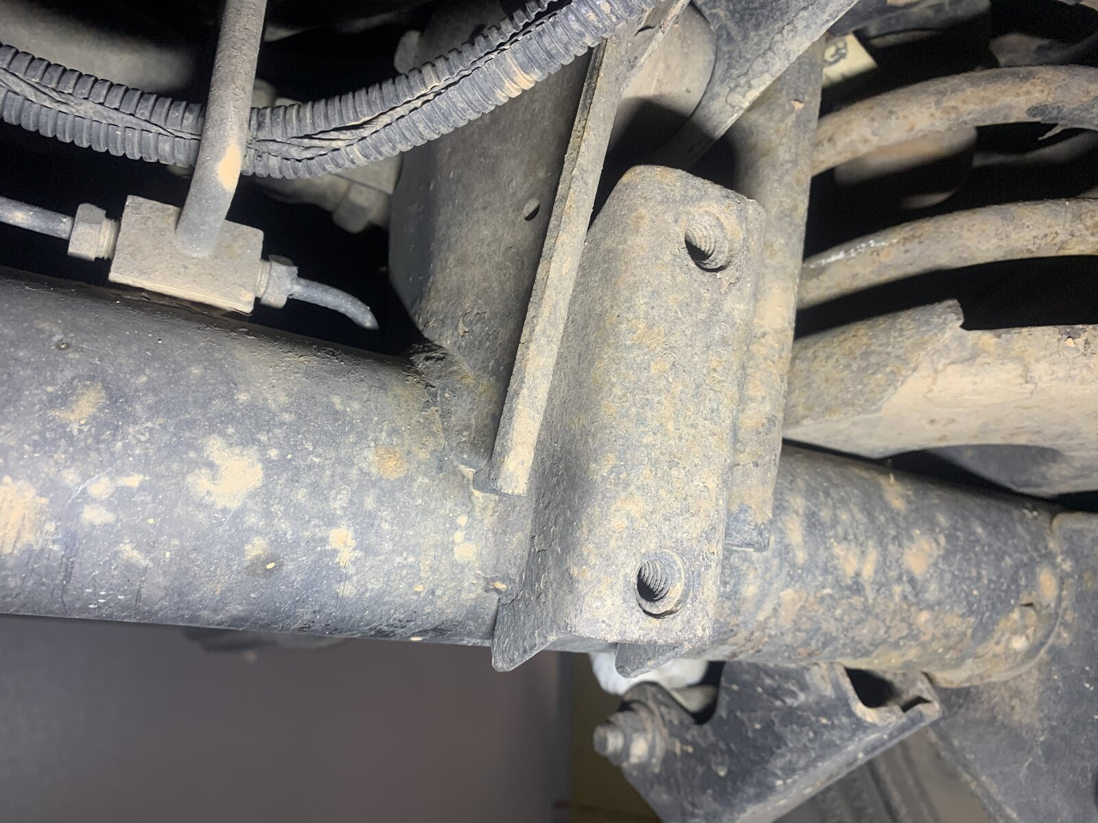

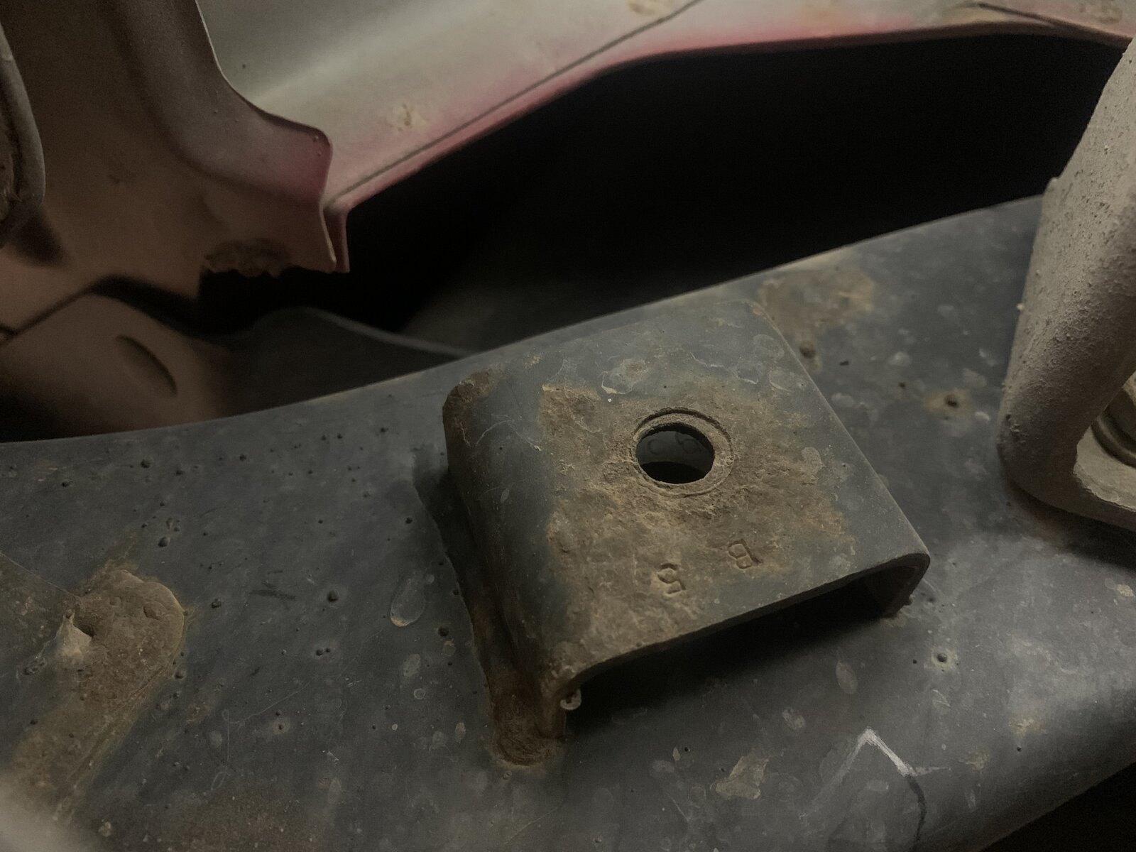

Anyone know what size bolt needed for sway bar end link to the frame? The axle side (1st picture) looks to be threaded while the frame side (second picture) looks like it will need a nut. Pics of the rear sway bar attachment points I’m talking about

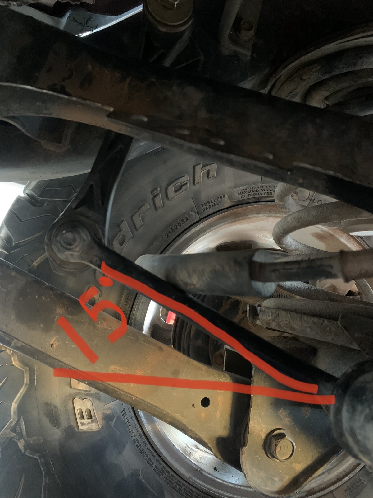

Got the stock rear sway bar installed I got off of eBay. With the stock sway bar links, my angle is approx 15* according to my phone. My rear lift is approx 2”.
Do you think I need to make longer links? The jeep sees mainly off-roading so flex is important
Take that back once I got both sides attached, the angle is now 17.5*
