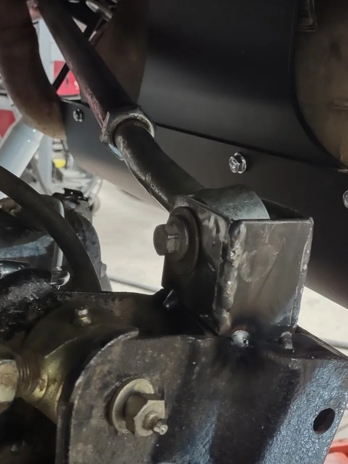

I made a new bracket and tacked it in. I think I'm going to keep it. It works really well. Kinda think that is how they should all be. I'm not pulling it far enough to bind the frame side any more than a "normal" bracket does and it opens up all kinds of clearance...enough that I could slide my axle back a little bit (probably only a half inch or so).
Anyway, I went from needing about 4.5" of bumpstop to only an inch and a half...and I could get more out of it, but my tires will be into the flares.

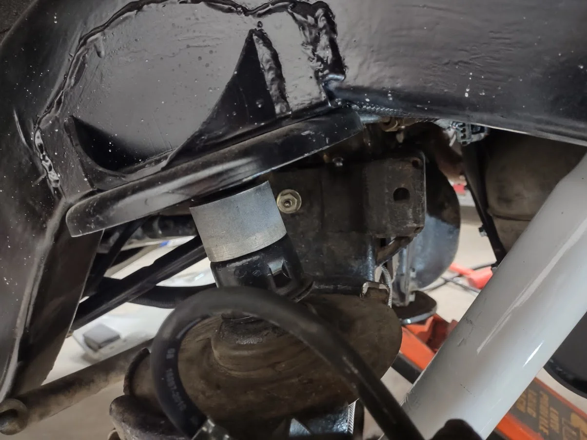

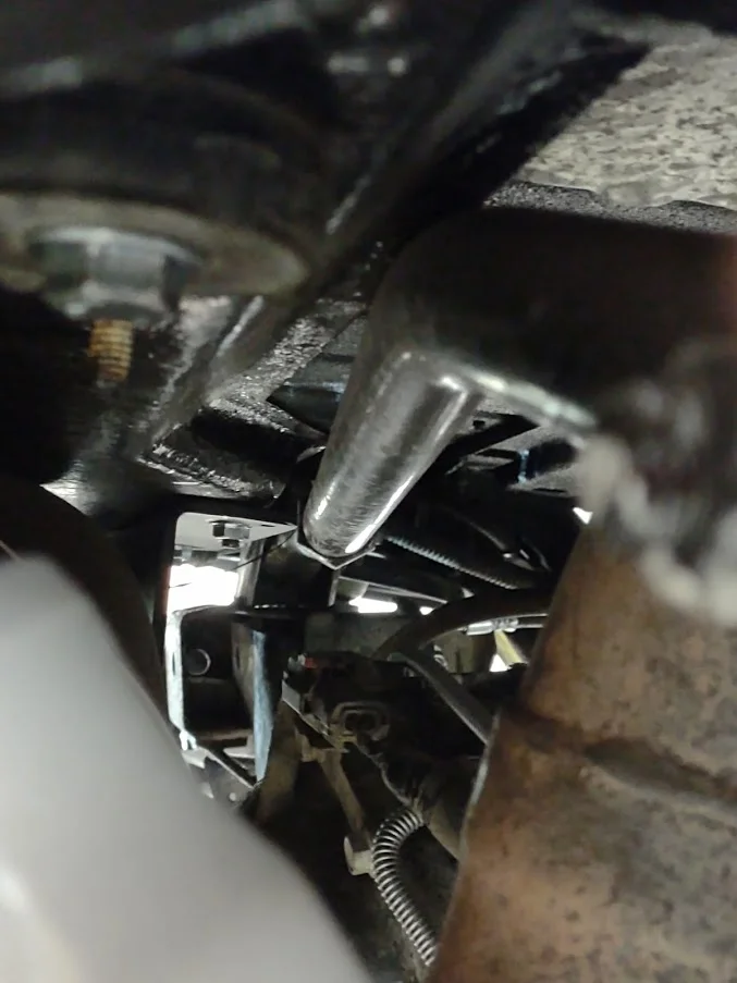

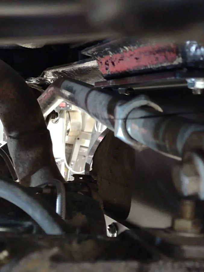

Here was the contact before.

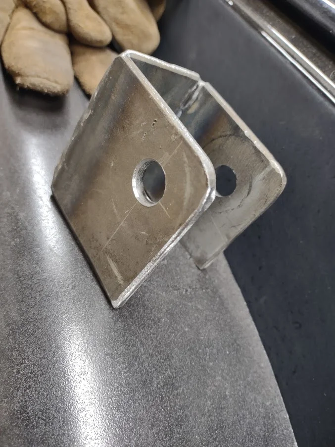

The bracket I formed up out of 3/16" sheet. I just cut a strip, then cut a couple score lines about 75% thru to act as fold lines. Welded up the cuts after forming.

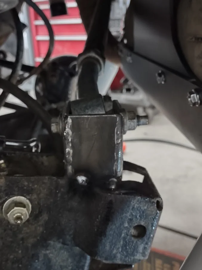

In position and tacked
Success!
I have my weldor buddy coming over tomorrow so he can burn it in solid...I'm getting better with the welder, but this thing has gotta be strong and right...so I'll let him do it!
