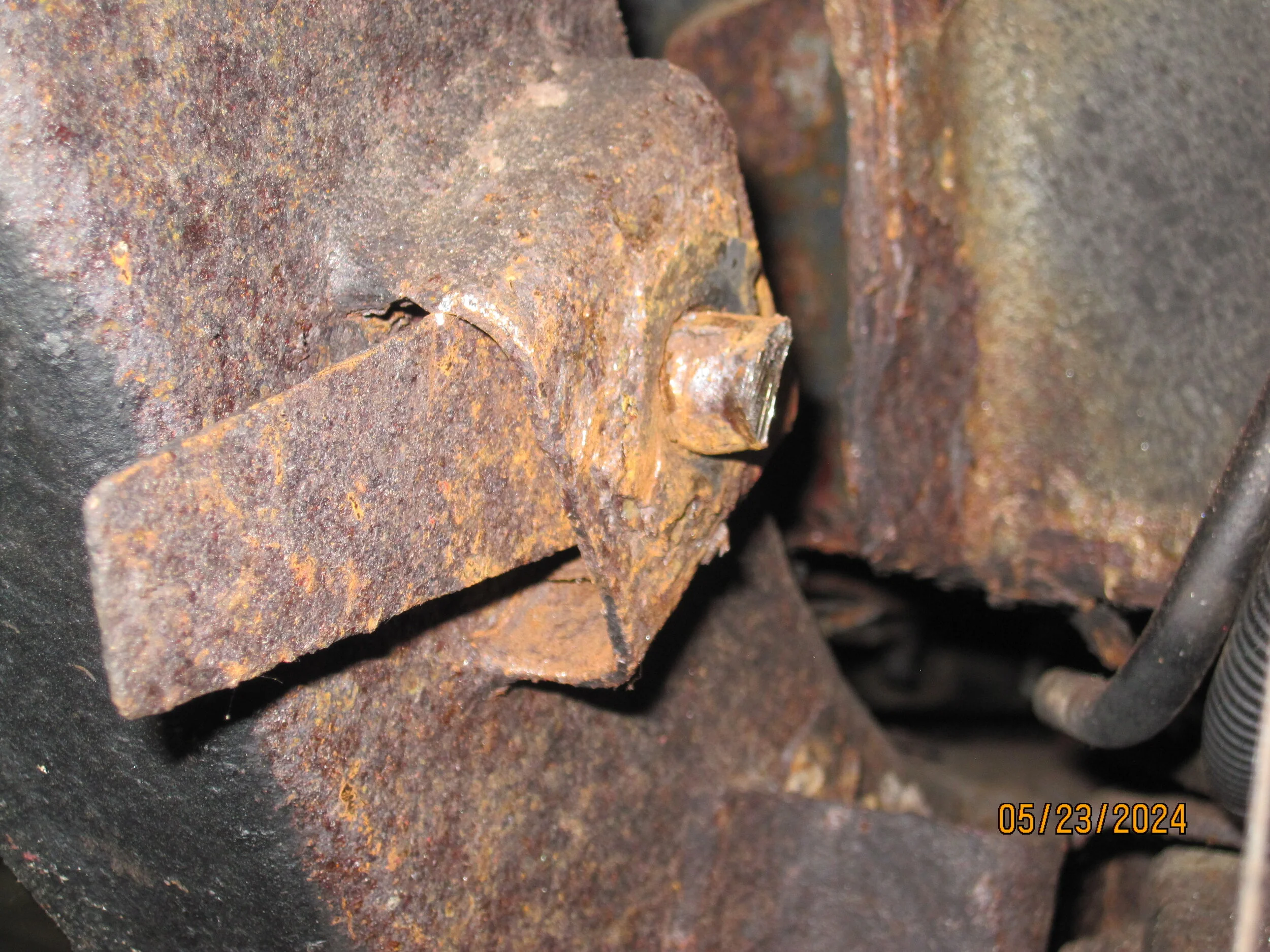

When summer is gone the plan is to really clean and paint/replace things. Its stupid hot here today so I didn't do to much, but i started loosening the rear shock hardware and of course the two upper bolts snapped immediately. If it cools down ill drop the tank later to make things easier going forward.

There are a bunch of guys that broke those bolts and nuts, I'd 100% search that on this forum. I'd pull that next fall and get after it as well.

1. You should not drive with any broken control arms. Broken bushings are one thing, but don't drive if the bolts are loose or broken, or if the arm itself is in two pieces.
2. You do not need to measure anything with stock control arms. Adjustables are another story.
3. You can replace one at a time, keeping the bolts on decently tight, then drop jeep on all 4 tires, loosen the bolts again and torque to spec.
4. If you cut the arms out its fine, just make sure you save a few "example bolts", bolts that did not get cut up too bad so you have a frame of reference. Just want to double check that your new hardware is the correct size, grade 10.9, flange or no flange, etc. etc.
5. I found that removing the gas tank made a huge difference when doing the rear suspension. It's just too much in the way of everything. You can even install the whole rear suspension then add gas tank at the end- it only makes a difference of about a quarter inch in ride height (won't affect track bar or sway bar link adjustments significantly).
When you get the rear shocks out, throw away the original upper shock bolts, they are 8.8 or something. Get zinc coated 10.9 replacements and use anti seize generously. then tighten back up with only 1/4 inch drive. You will never have problems again.
You're supposed to torque the control arms with the weight on the axle/at ride height so either all 4 tires on the ground or jack on the axle, no stands on frame. The rear lower control arms by the axle side will be difficult/impossible to get a torque wrench on, on the ground, depending on what wheels and tires you have. For those two bolts, I tightened on the ground as much as possible, then I raised up the rear axle on a jack and removed one tire at a time to get them torqued.

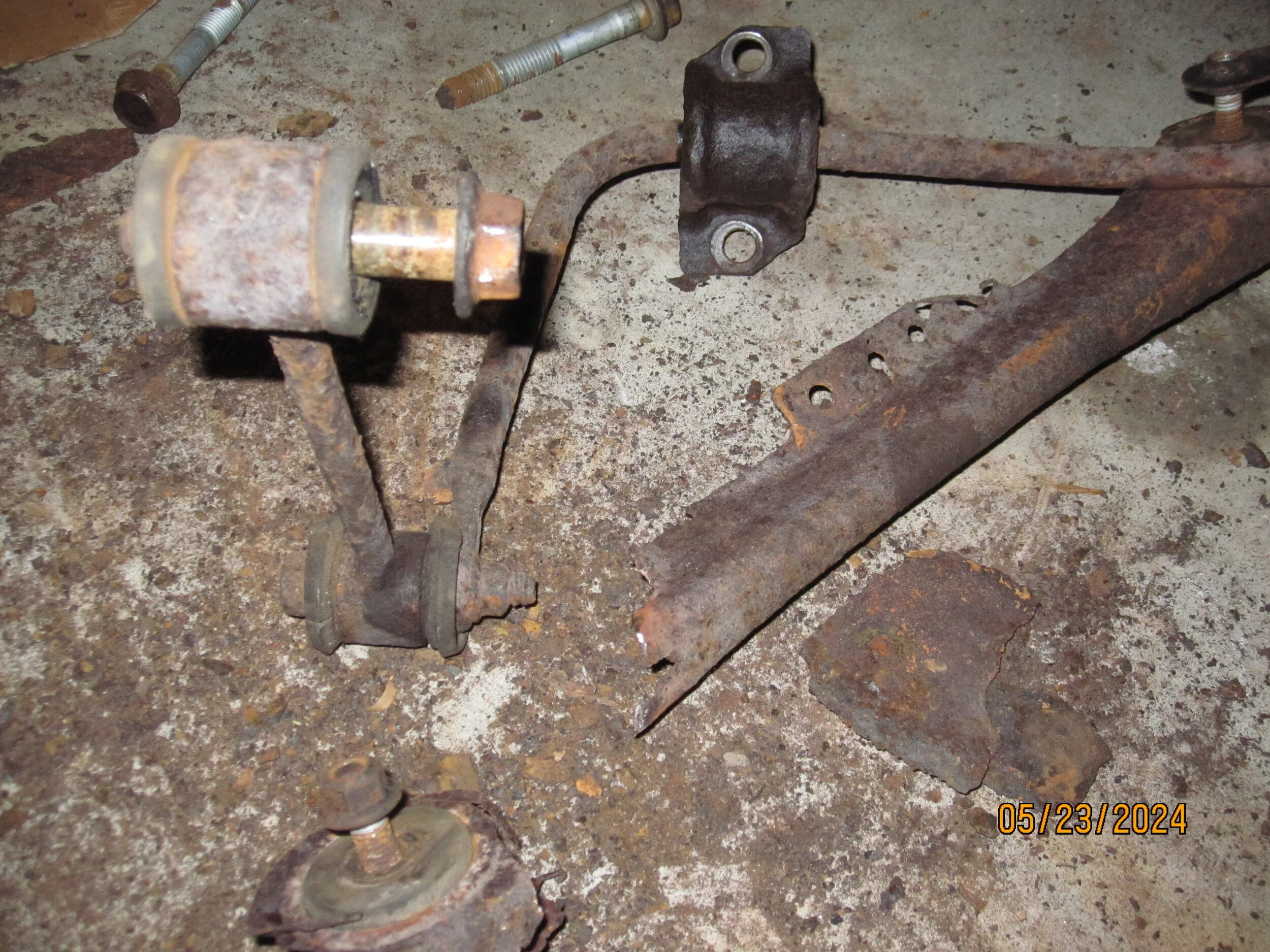

Should have taken an extra minute to think before I cut the rear sway link bolt lol... lucky there is enough to weld a nut onto tomorrow

That is a crusty looking job. I usually look over the job that I am going to do and try and order new bolts and nuts. I know I am going to bust or cut at least one if not most of the bolts. Usually order stuff from Daveys Jeep. They usually have all the Jeep stuff.

It sure is.. I did order all the hardware. All the shock bolts should be in today

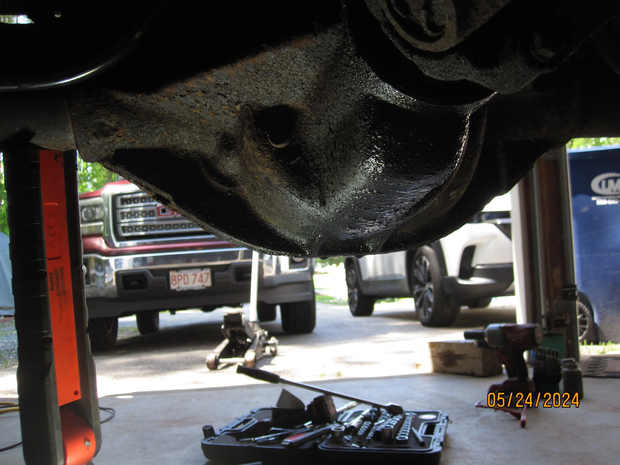

Went out this morning to clean up tools and the rust rain off the floor and start working on the broken shock mount bolts... Seems we have sprung a leak captain.
I think my jeep is addicted to be being on jack stands
