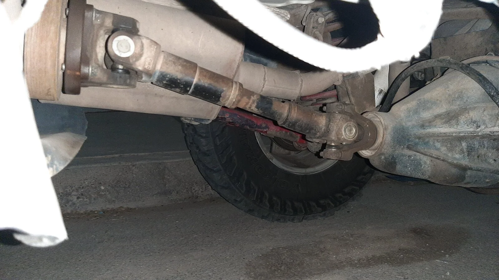

IF I understand the pinion to driveshaft angles you posted; I would replace at least the rear upper control arms before you destroy the rear driveshaft. There should be as close to 0* difference as possible.

Rear adjustable uppers seems like a great idea. I think you also might be hitting the front track bar on that rather large diff cover. You could look into getting a cover that's not so big before you play with the front track bar or at least check to see how much room you have.

let me try to take a picture of the angles and post them for betteer understanding..

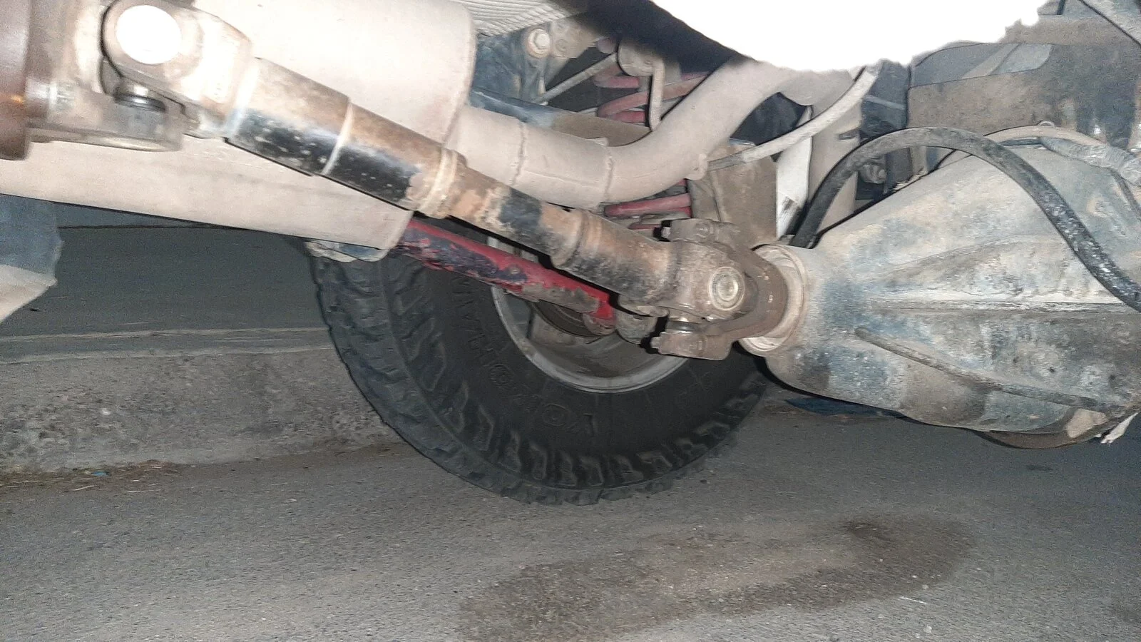

I was not able to measure the angle... But it looks like this.... I think that the rear upper control arms will definitely help my rig with the 4.5 inches of lift... I found the adjustable rubicon express for 160 bucks on Amazon... I think Im gonna get those....
Just to conclude with this thread, I got the upper adjustable control arms... hell!! that was night and day difference! really recommend them... due to the angle of the axle I had to include a relocation bracket for the shocks.... nothing fancy but... need them to avoid any damage....
