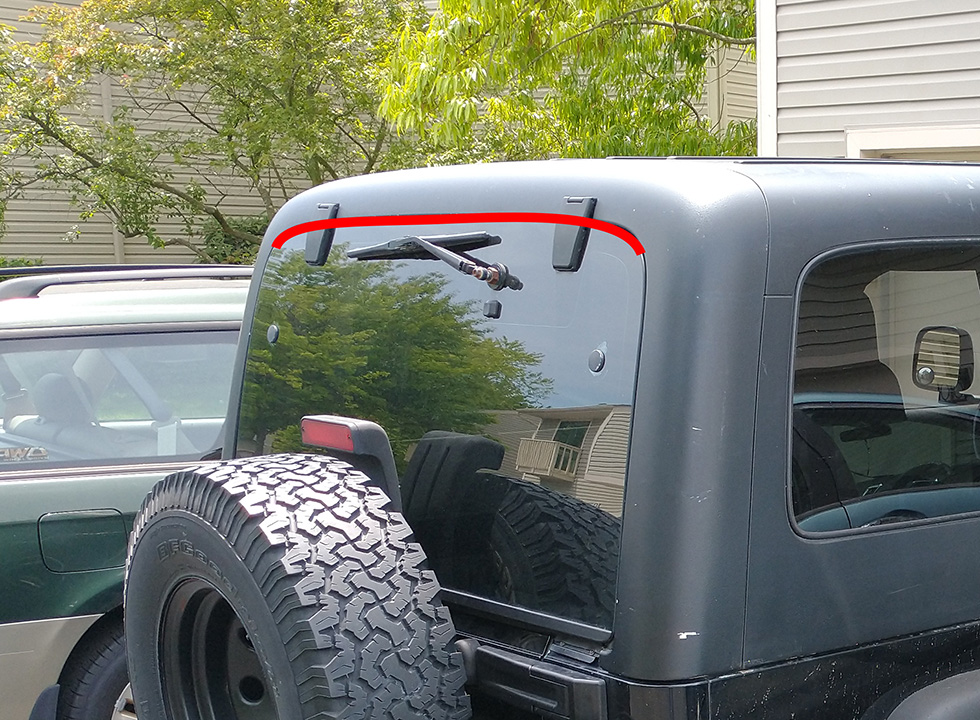

I think he's having issues in this area...
