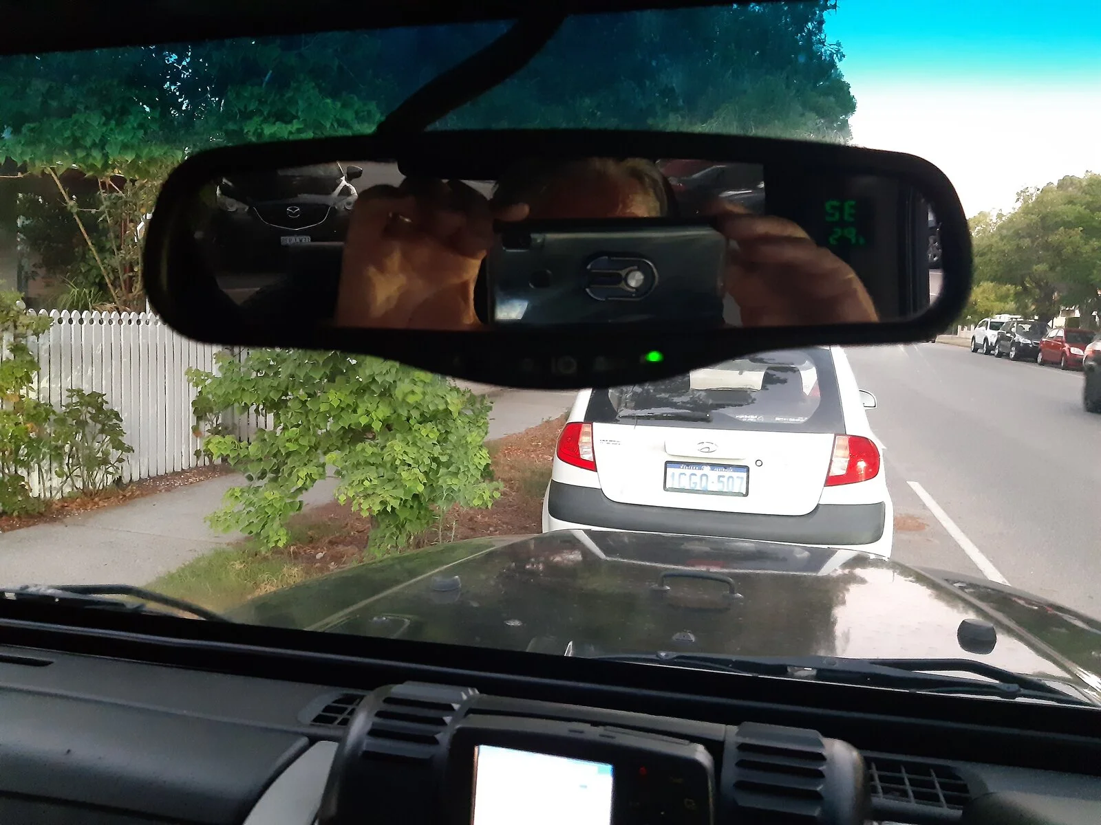

Wait, 06 TJs have temperature in the rear view mirror? Can this be retrofitted to a 2001?
The compass display is a neat feature too" personally I think they are a bit big and too modern looking for a TJ but I do look at both temp and compass all the time. It would be a lot smaller if the down lights were not in it.
