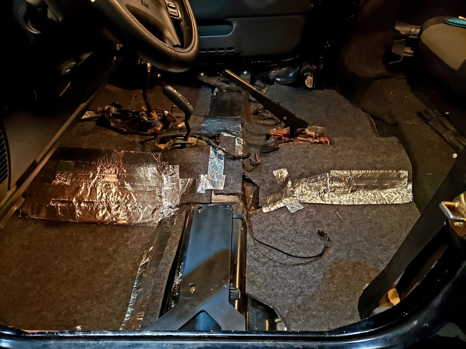

I used CSI 25070 thermal insulation and a liberal amount of foil tape. I have been happy with it. I have Bedrug installed and before adding the insulation my Jeep was almost unbearable to drive. After the insulation I can feel the carpet on the transmission tunnel and it is barely warm.
