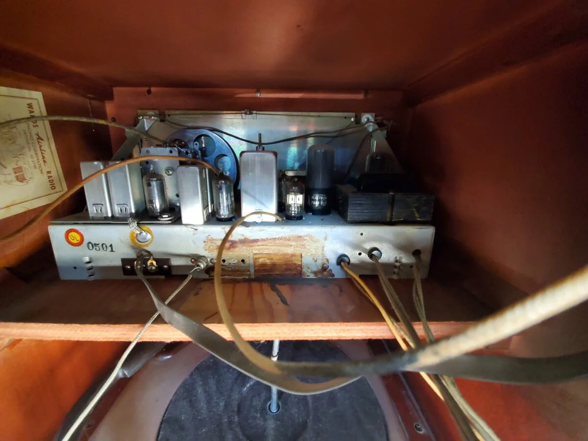

If you know your way around a multi-meter i would just take the amp part apart and start to measure Every resistor, cap, etc, to make sure everything is within specs and replace whats bad. I know vacuum tubes need to be dial in with another device made specific for that, don't know the name. Once all the electronic parts are sorted out you can start working with the mechanical parts, like the arm and all. You might need a new stylus for the turntable, but maybe a good cleaning will do. I Work with guitar electronics and amps as a hobby, but never dealt with a radio from that period.

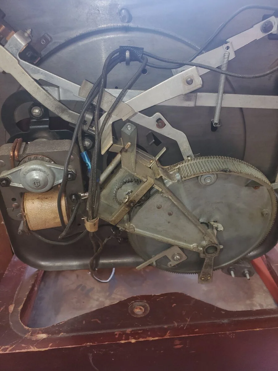

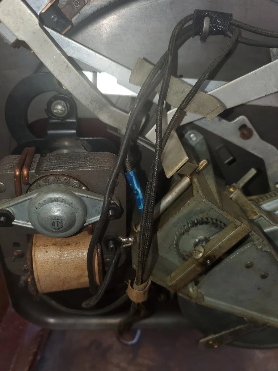

Some news--we got a hold of the older gentleman. For $100 he'll take a look at it, and any repairs that are needed, that $100 will cover (+any other costs). We're dropping it off tomorrow. He wont refinish it though, just focuses on the mechanics. I took my air compressor to it and blew years of dust off. I think I found why the deck wont spin, if I had to guess, these two (copper?) hinges need to be mated to each other

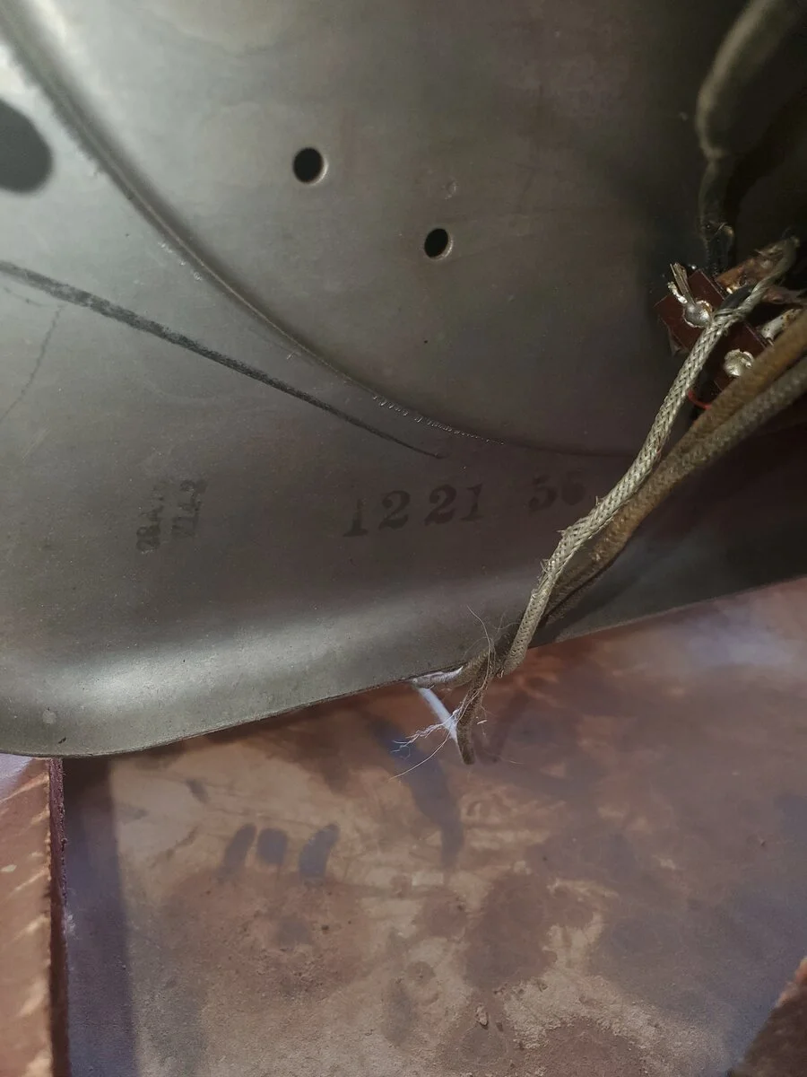

I also found a date on the bottom of the record player, 12-21-1956. Also what appears to be a somewhat recent fix (the blue splice connection).

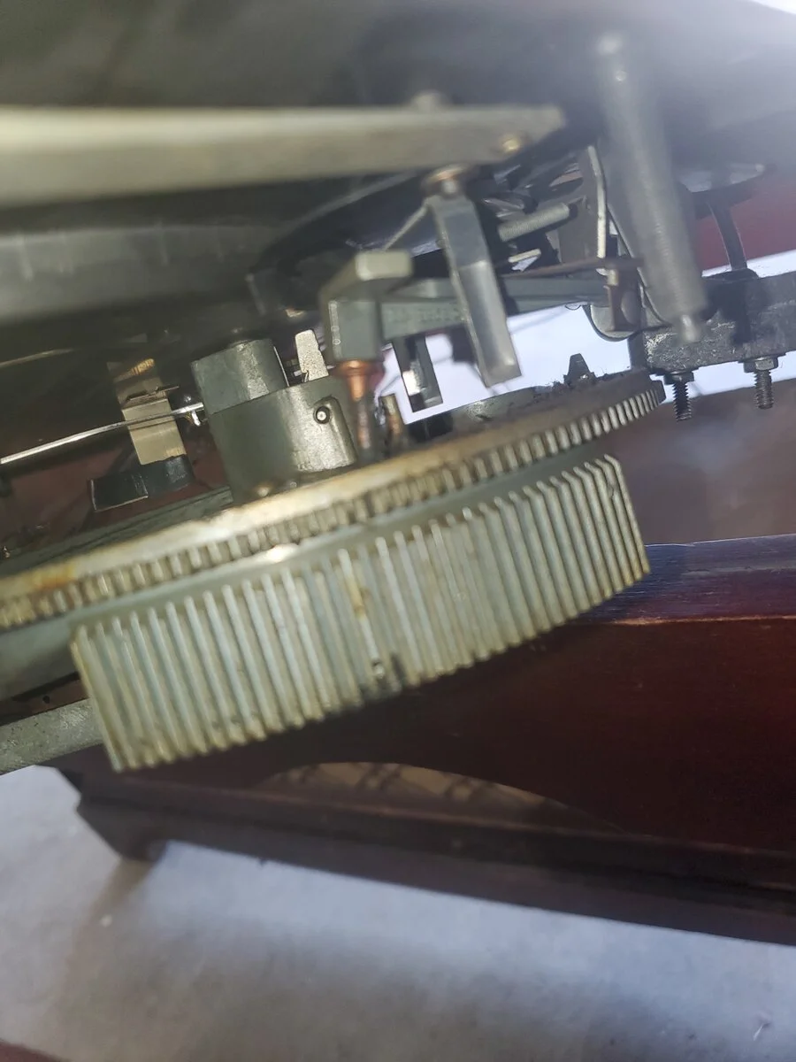

Good news/bad news. We dropped it off with the gentleman who restores these. Basically, the turn table is shot. The only way to get it going again is to scrap whats currently in it, and replace it with an 80s model turn table (a $300 unit). The little belts inside that drive the gears are no longer made, and the rubber wheel would need replaced. A couple of prods with the multimeter determined the motor was shot. He said he could try and find a replacement but it wouldn't be easy and in the end it was going to be way more money and trouble than it was worth. The arm/needle would destroy records after several plays due to its weight. It wasn't a cheap model by any means, nor was it top of the line, but I guess turntables have advanced pretty dramatically. He placed it in the late 40s/early 50s era. The cabinet style was real common, and the wood was a veneer (which I knew).
The good news, he said he can easily get the radio going again, and he said he could retrofit an aux cord that would allow us to play off an ipod or our phones. Which is the route we decided. He'll clean up the turn table that is in it to get it presentable too. We'll carefully strip the outside down later this summer and refinish it ourselves.
That's about what I expected - we were junking those turntables 40 years ago for much the same reasons. Find a BSR (or whatever) somewhere and drop it in if you want it to play records.
