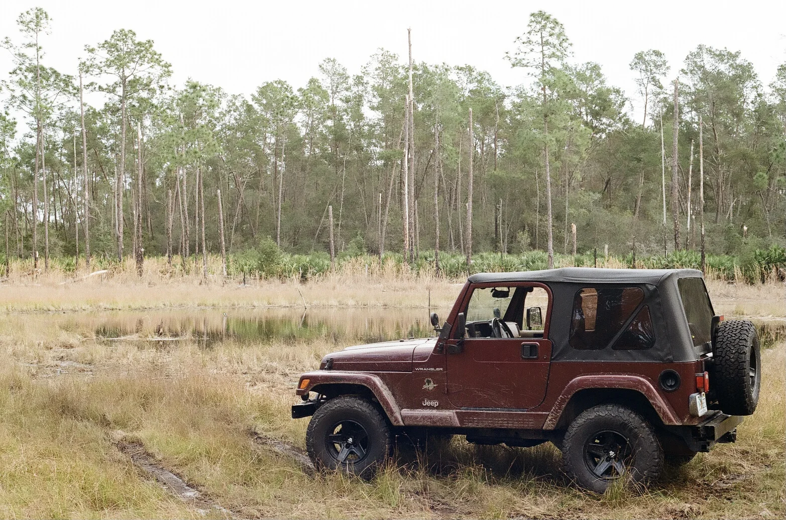

Hey, I'm reedfe but you can call me reedfe. This here is my 2002 Sahara that I picked up in December of 2020 after my 2000 Miata met an unfortunate demise due to the some of our incredibly talented SoFlo drivers (RIP Marilyn, your topless motoring will be missed). But this isn't a Miata board. This is a Jeep board. For Jeep things. And Topless Jeep motoring.
When I picked her up she had just under 178000 miles on her. 4.0, 5spd, Dana 44 rear with 3.73 gears and factory LSD. The PO had taken very good care of her (brand new soft top, super clean interior) and wasn't a spot of rust on the frame or tub that I could find. It ticked all my boxes so I went for it and am still enjoying that decision.
First order of business was new wheels/tires as the tires were very very close to bald and a set of 4 with the undersized factory spare 5th. Took the opportunity to replace the 15x10s with a full set of five 15x8s and wrapped em in 31" KO2s. I've been very satisfied with them so far.
Soon after we went on our first trip together. I was meeting a buddy a couple hours away near Ocala for some camping near a spring. Sent her through Ocala Nat'l Forest for her first taste of offroad. She did just lovely and I was loving it. I had pulled the rear seat and loaded up my camping equipment and ratchet strapped everything down to live out of her for the next few days. I'm not the tallest of guys at 5'9" in the morning with shoes after eating wheaties and standing on tip toes, but I can actually fit and sleep in a hammock strung from corner to corner of the roll cage. Worked like a charm and will be taking full advantage of that on future trips for sure.
Since Angie did so good on that trip, she would be rewarded for her troubles. I decided to replace the replace the headlights as I was less than thrilled with the factory set. The new ones are much brighter for sure but I'm not super stoked on the beam pattern. Don't get me wrong it's great to be able to see but a more uniform pattern would have been great. I would probably buy again but yeah.
As part of her upgrade treatment, I opted to replace the 2" coil spacers from the PO with nearly a full Codaman Lift (see I told you I lurked!). I wanted to avoid a TC drop and SYE while still keeping the streetability. I swapped the spacers for 2.5" RC springs, Rancho shocks, steering stabilizer, actual bumpstops, and a RC rear adjustable track bar. I also took the time to opportunity to replace the factory sway bar endlinks with a set of quick disconnects. The front axle got thrown to the side a bit and I am considering a front adjustable track bar to help fix that a bit. Here she is after the driveway install. Gained a bit of lift from previously but not too much and brought the front close to level. Stoked.
At this time I also baselined the Jeep with all new fluids everywhere. I knew the oil and spark plugs had been done just before I purchased so wasn't too pressed to get this done ASAP. It's nice knowing that I won't have to worry about any of the fluids other than oil for a while now. She does have a small RMS leak as well as a bit of residue around the oil pan gasket but levels stayed pretty much full over the lifespan of the last oil change so I decided to wait until it got where I was needing to add oil to replace. If it ain't broke, fix it till it is!
I had picked up a bit of wheeling accessories for her through this time as well as fix a few minor things (sun visor, AC blower motor, taking off the milkjugs, etc...) but overall she has been trouble free and I couldn't be happier.
Loaded her up with a few friends for a day of wheeling at one of the local Wildlife Management Areas. Definitely got into some trouble but nothing that couldn't be fixed with the help of another vehicle. We were all smiles, ear to ear. The mud on our faces sure was a fun time too but I think next time I'll leave the doors and top on so I don't have to deal with the chore of cleaning the mud from the interior :D

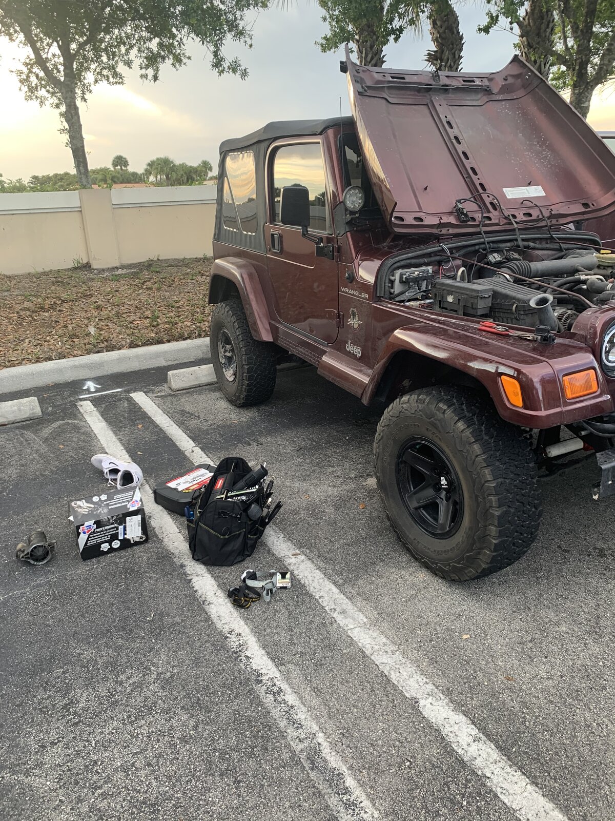

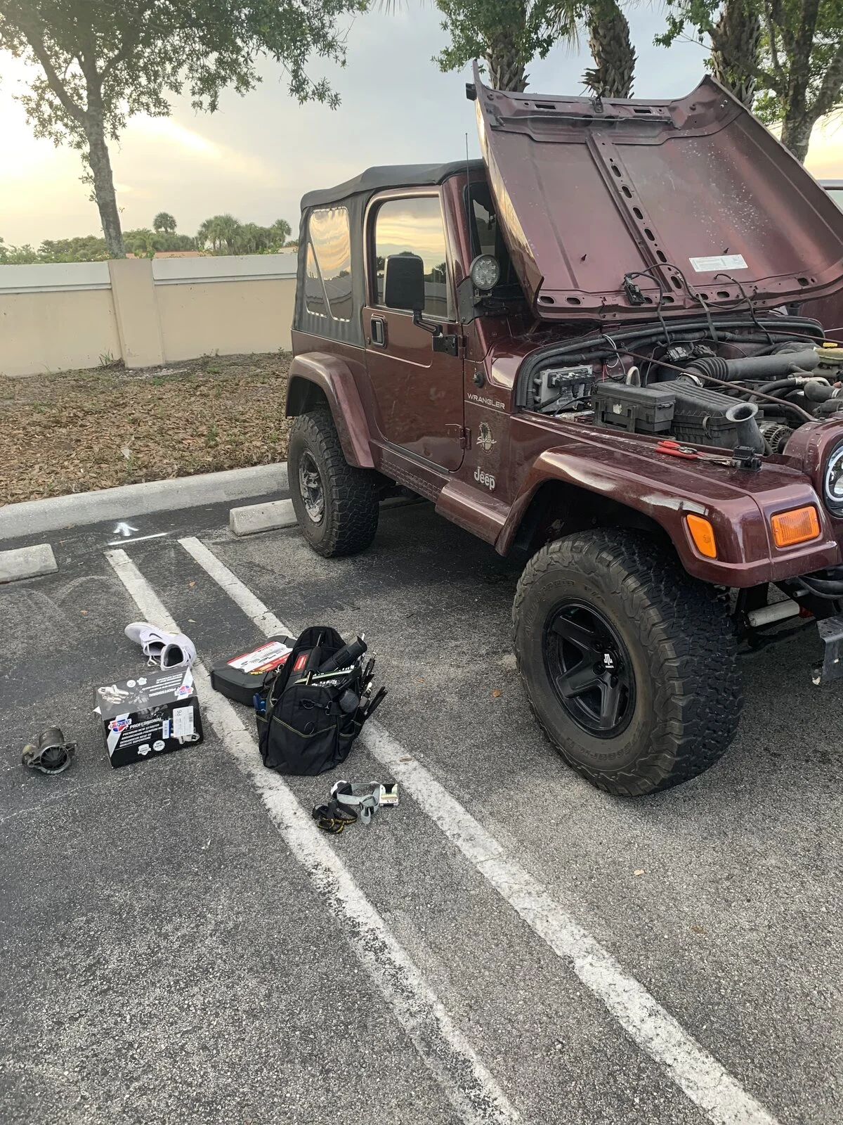

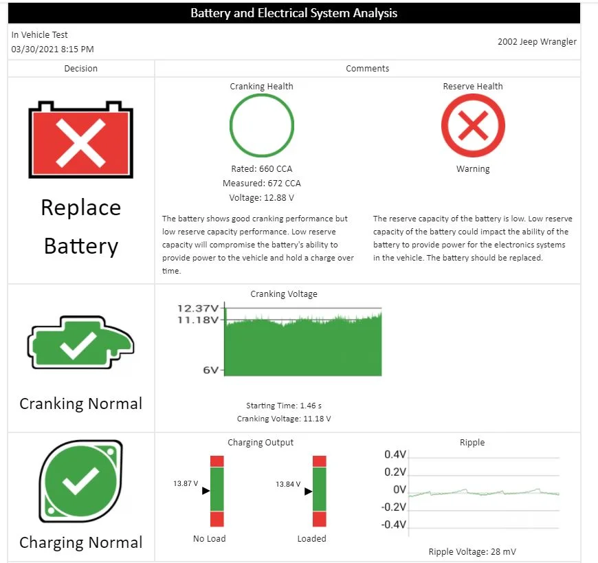

This will be the last weekend I'll be able to work on her before taking the roadtrip to the carolinas. Naturally, she started cranking very slowly and failed to start the first time leaving work today. Got a battery test and is suggested to replace battery. Has a walmart battery in there so will likely replace even just for peace of mind. I've read to get a group 34 battery, above 650 CCA to be able to power more electrical things (future proofing for more accessories), and AGM as it holds up better to trail beatings. Any bias for brands?

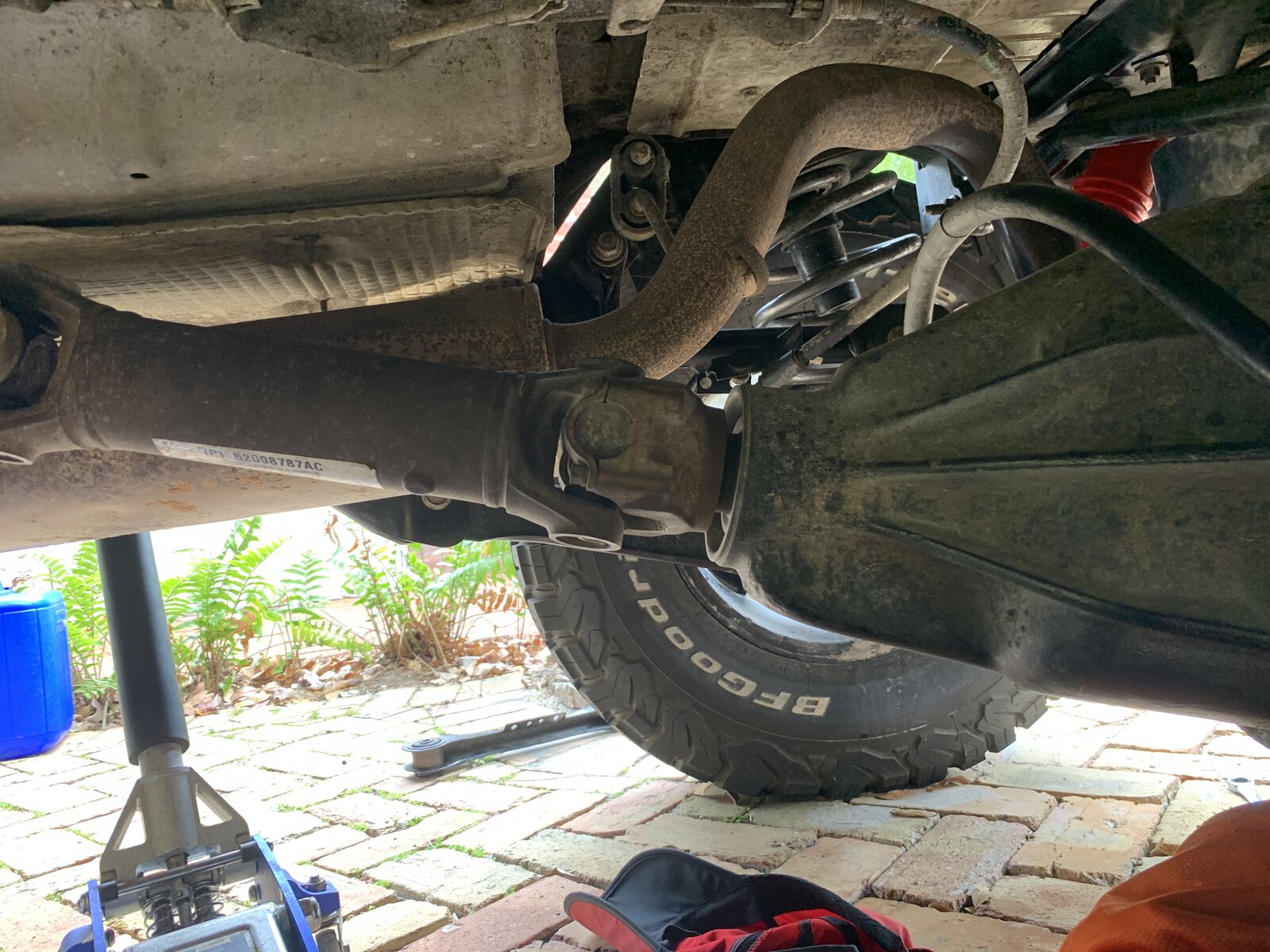

I also have rear upper adjustable control arms coming in to help correct the pinion angle and a sinusoidal vibration experienced above roughly 55mph. I don't do much driving above that speed daily but will be doing a ton of highway miles here so hoping this will clear that up. Plan is to leave the jeep on the ground, unbolt ebrake bracket, drop out both the upper control arms, jack up the diff to correct pinion angle and then set the new length of the adjustable control arms and bolt them in. Seems simple enough but as we all know, things are never as they seem. Might not be getting around to that cargo area build like I had hoped but I mechanicals>>>comfort. Ratchet straps it is!
So it turns out not only was the battery bad but the starter was toast as well. Push started her to get to work on time and picked up a new starter along the way, then changed it out after work before heading home. A very very simple job probably only took me 15 minutes to do and only required a 13 and 15mm socket.
This weekend I also wired up my DRL Halos, replaced the faulty connection to the AC blower motor which caused it to not operate 95% of the time, cleaned front brakes as they were gunked up with sand and mud and pulling to passenger side, and then replaced rear upper control arms to correct pinion angle. Vibrations are noticeably less so I am happy but not totally gone at all times. the new pinion angle also caused the rear track bar to rotate back and make contact with the top of the gas tank skid plate. I haven't been able to feel or hear any bad conflicts but it does make me feel a bit uneasy.

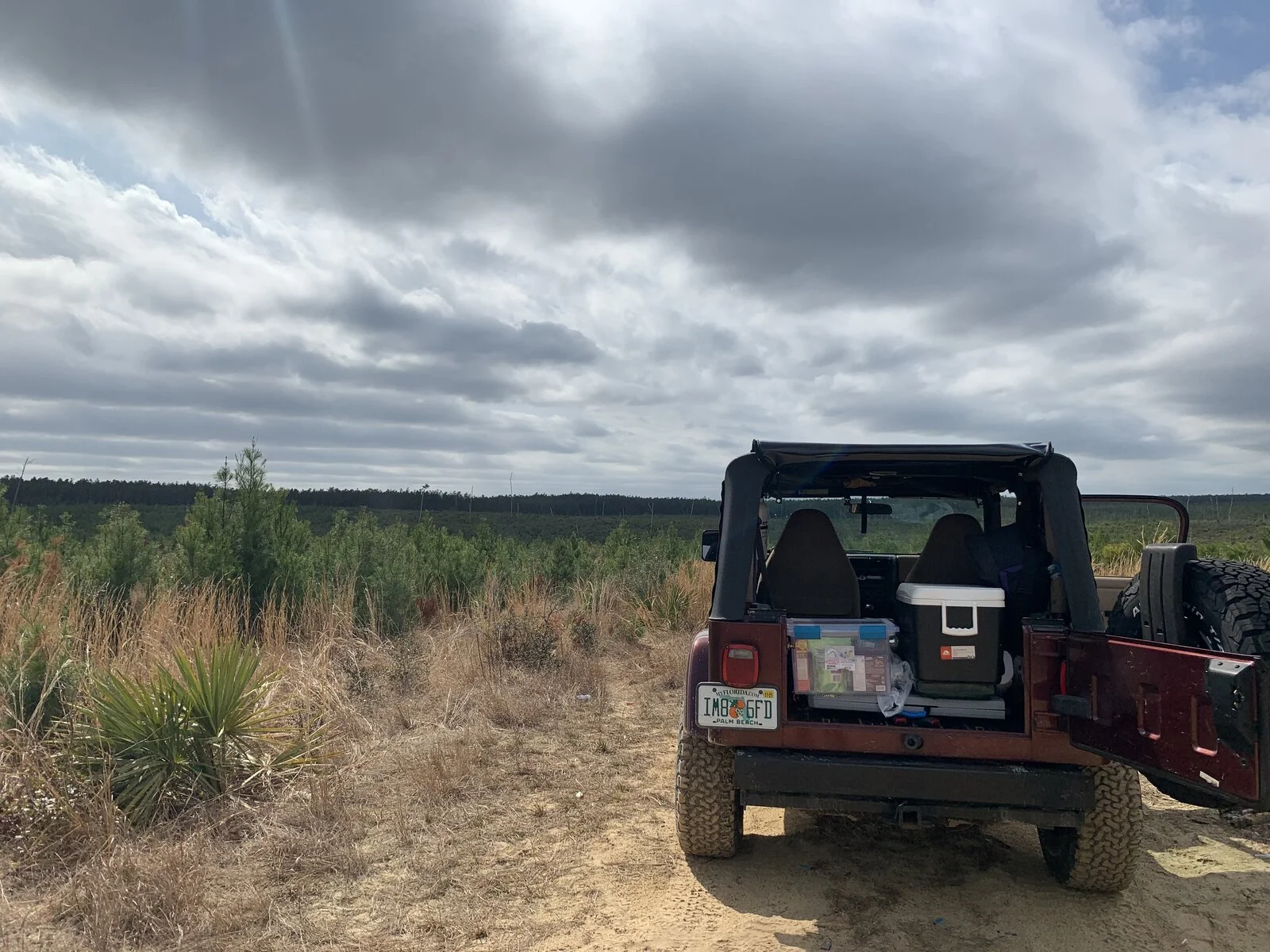

Jeep did wonderfully. Over 1700 miles in 5 days without much issue. Got to get out to Uwharrie (thanks for the rec) and it was sick. So much different from the trails in Florida, like there is elevation and rocks. Here she is at the start of Dickey Bell
She did everything I asked of her with ease. I didn't attempt to push it too hard because she still had to make it home and this was my first time doing this type of offroading not just sand pits and mud holes. Will def be back here or to similar trails.

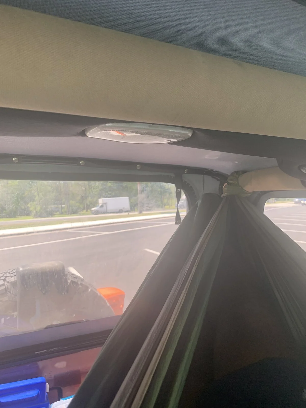

For those that were curious about the hammock set-up, this is the best I have right now for photos. You can see in the first where it is strung from corner to corner. I fold the driver seat forward and lay the passenger seat back. I have a small amount of wiggle room at 5'9" and I think you might be able to get it up to about 6'0" if you are comfortable curling a bit. Side note, not sure if i really need to build a storage thing. This all fit very snug in the back but I would like a tailgate table to cook on.
